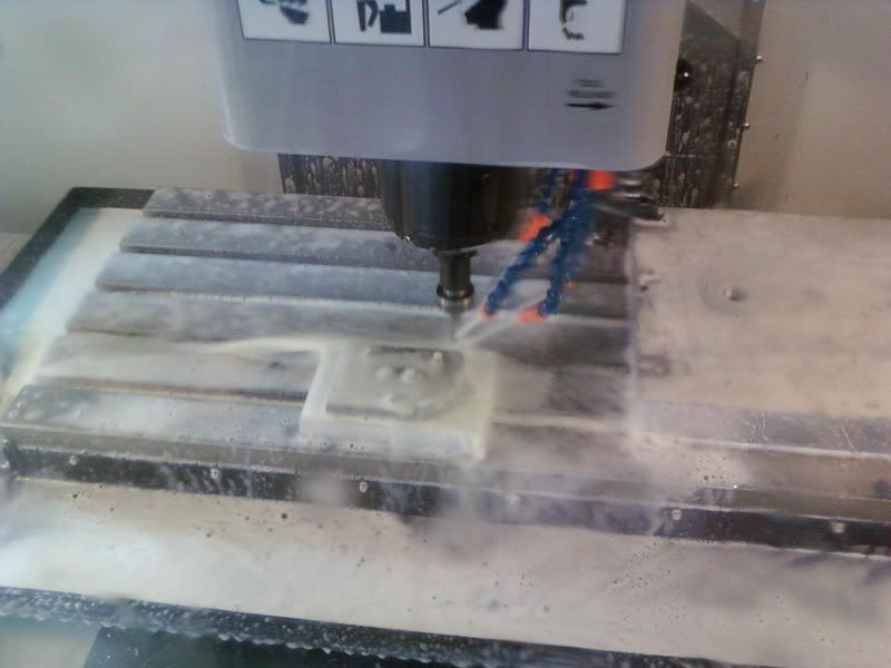

Okay, not really. We're finally in the process of installing a CNC machine (Haas VF-3) where I work, so that will help getting some of these odds and ends done. Also planning on making the rocker stud girdle and the main cap girdle.

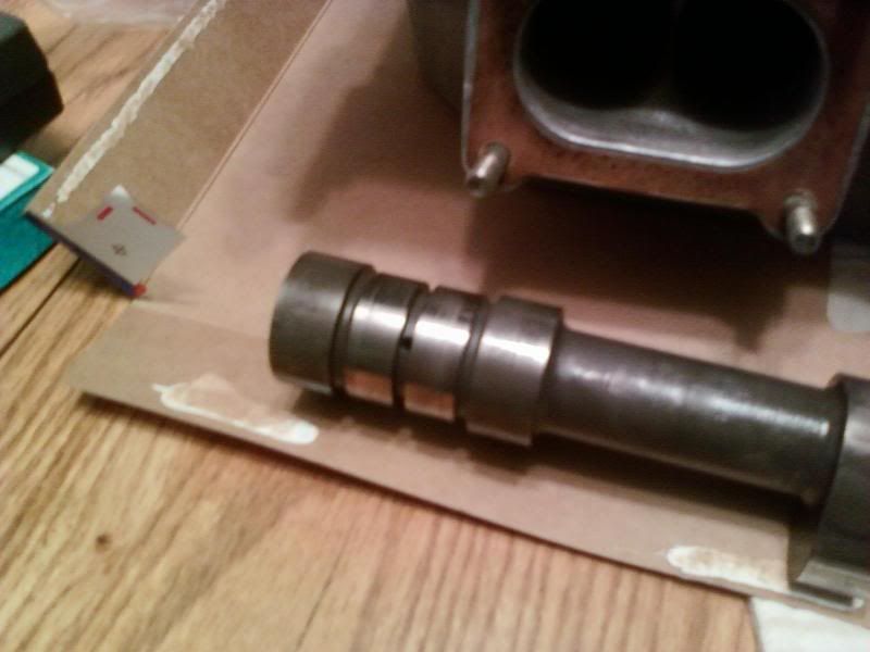

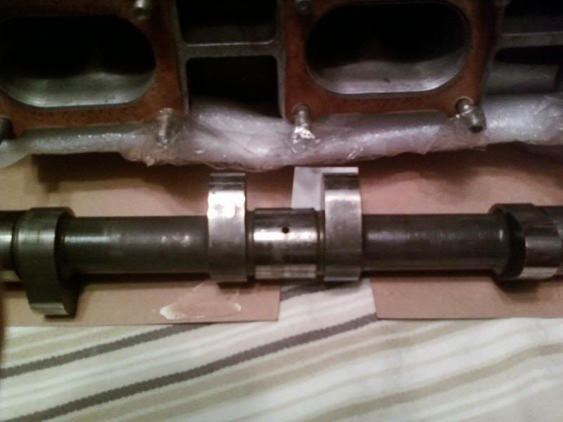

I pulled the intake cam off of Alan's head to get journal sizes and do some general measuring. The cams are gun-drilled, with an oiling hole drilled at each bearing. The inner two bearings are plain, while the outer two are grooved for oiling. This corresponds with the holes drilled in the outer journals in the head for the pressure feed to the cam core I suppose.

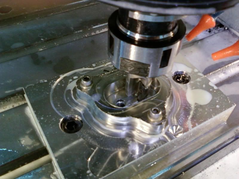

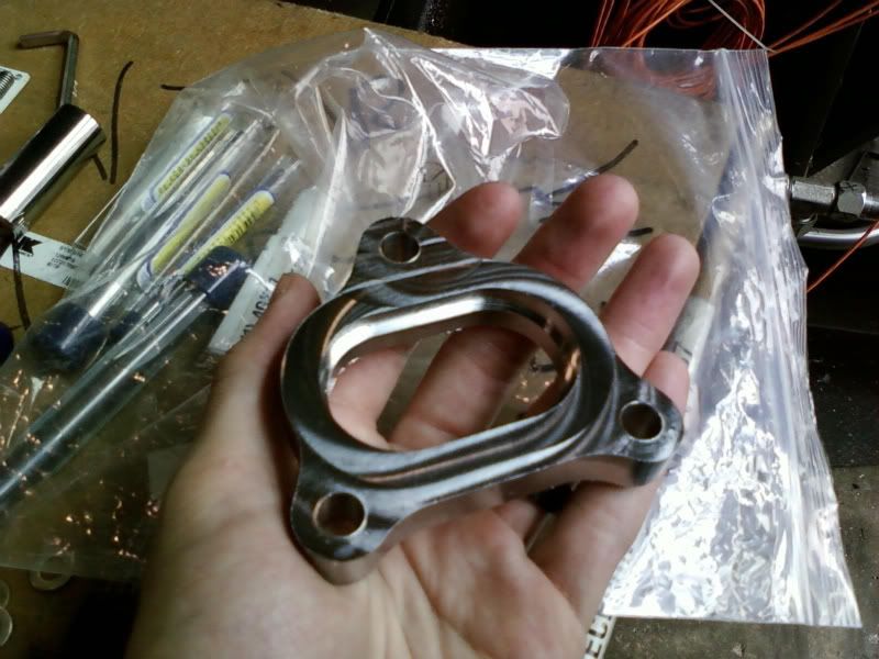

One 321SS flange done, 3 to go.
