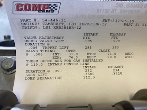

The cam was suggested by CompCams after telling them all the other components and ultimate HP/TQ goals. Mike also agrees that it'll be a little too aggressive, but not un-tunable or un-streetable.

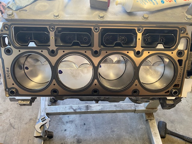

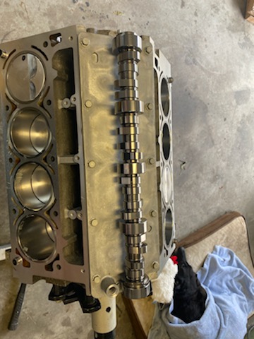

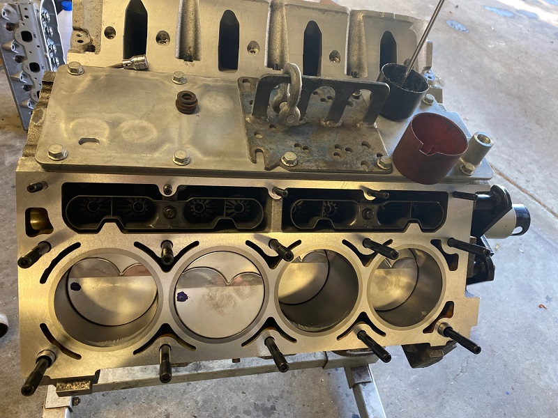

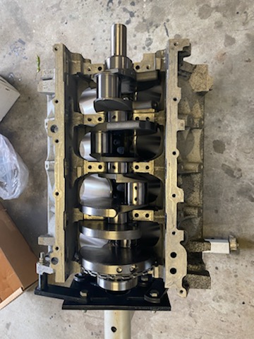

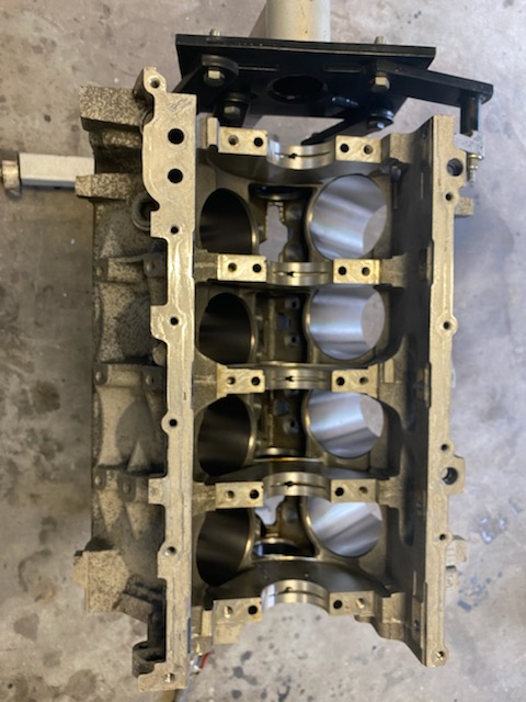

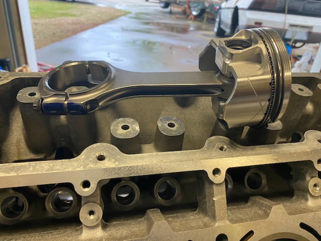

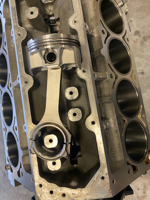

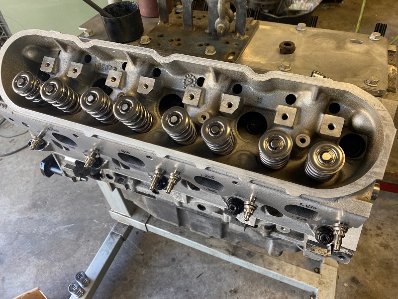

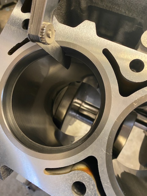

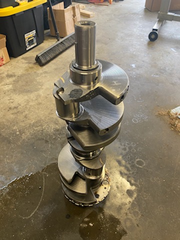

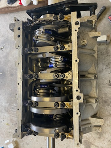

Okay! Pretty excited. Mike started putting together the engine. As he is uber professional, and I am uber paranoid, he started by checking all of the work the engine shop did, and then start checking tolerances/clearances. This meant things were going to gether and coming back apart a few different times.
He is happy with everything he's found so far. He said the ring gap the shop put on was perfect, it was gapped to where he would have put it if it were his car.
Piston to valve clearance is excellent, no concerns there, even after the machining that was needed.
Here are the pictures he sent me. Oddly, only two came through at "full size", the others came through already greatly reduced in size. Camera phones and MMS are strange.

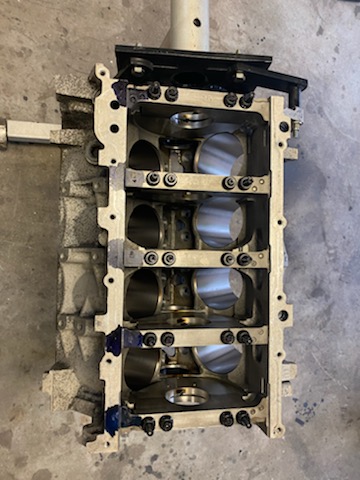

Some pictures of the bare block!
Here is a pic of the new-old-stock crank I got!
My spiffy new camshaft and spec sheet.
A couple candy shot of a piston and rod
The coated bearing
Now for pics with things installed at different points!

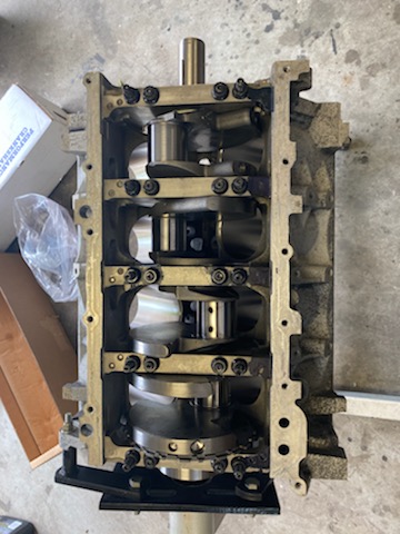

Some pics of the main caps being fitted (ARP studs, of course), and then the crankshaft installed.

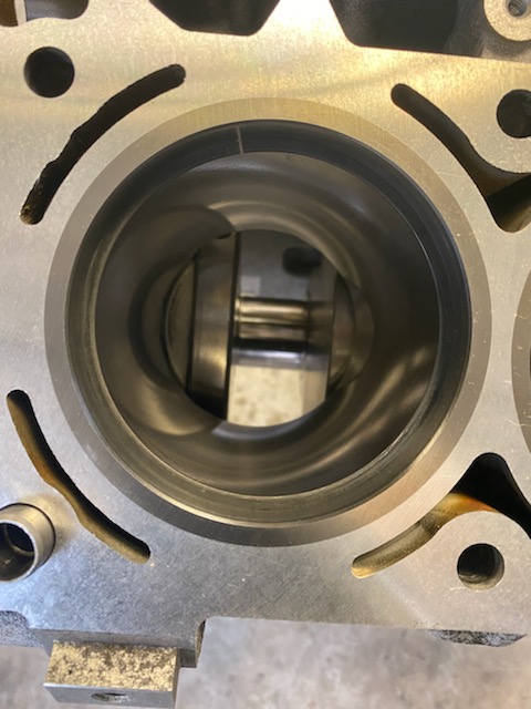

A close up of the cylinders

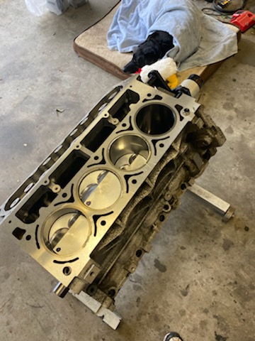

Some pictures of the block with the rotating assembly fully in there.

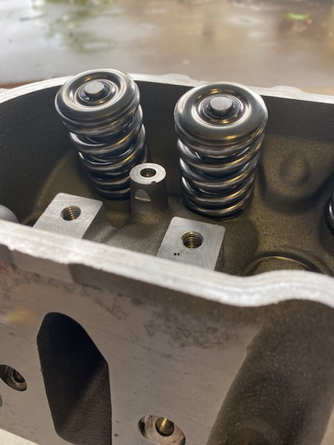

Some pics of the heads, valve springs, and the head on the block.
