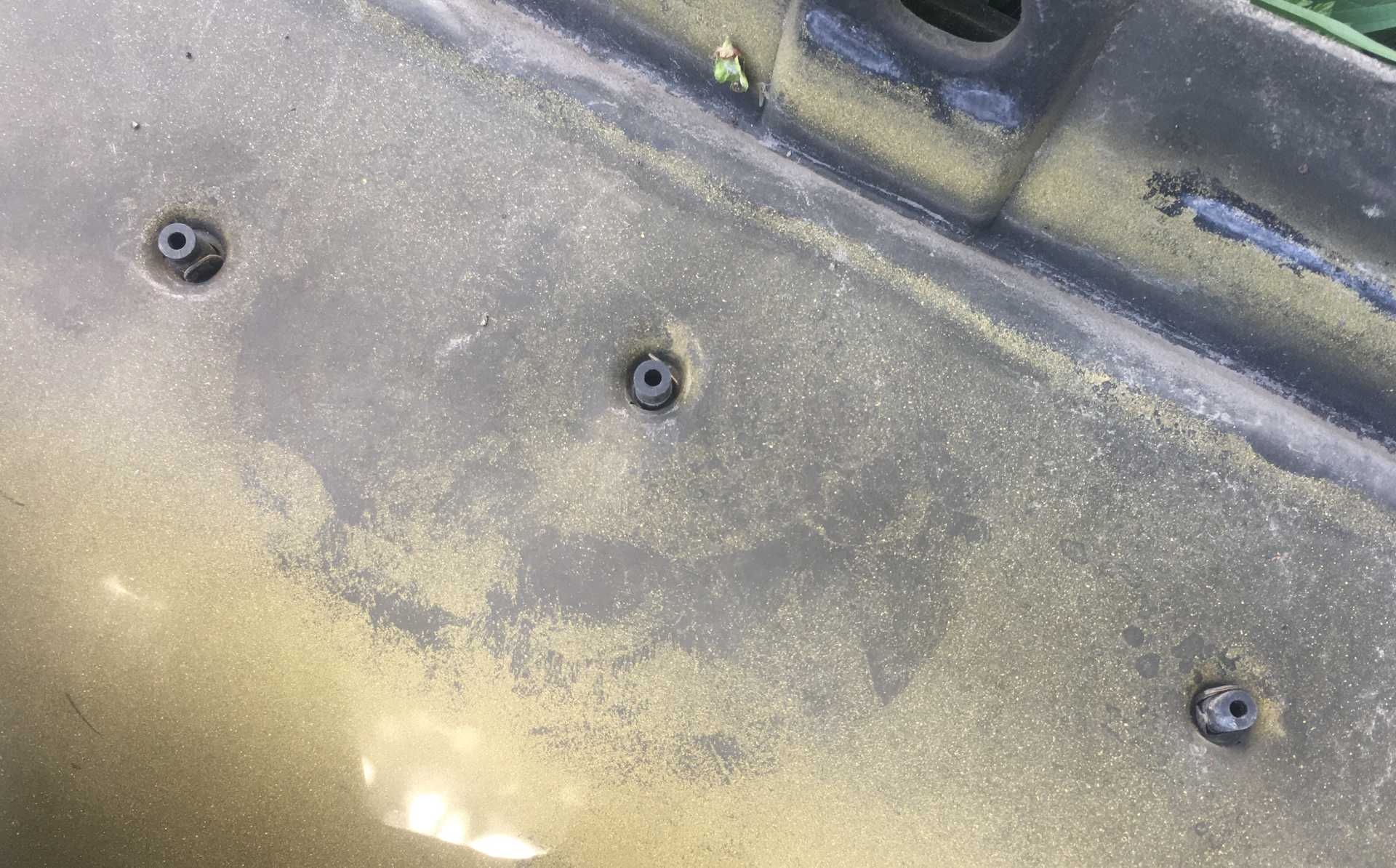

Will probably have our 88 rear bumper cover repainted. Plan to remove reflectors & Pontiac emblem to make prep & paint easier & better. 1. Will standard speed nuts from McMaster work ok on the reflector posts or is something special needed? 2. Any tips on how to remove the Pontiac emblem? Doesn’t have any visible speednut. Thanks.

The Pontiac emblem on the 88 bumpers is speed nut + double back taped on. you can get replacement at TFS.

As for the Pontiac emblem, I know about the molded-in letters. But the 88’s definitely have clip-ons. I’m going to try to post some pics but may not be able to, as I don’t have many posts under my belt.

APR 14, 06:35 PM
| quote | Originally posted by Number4Ohio:
Have you tried simply pushing on the end of those nubs? Do it gently at first, just to make sure someone hasn't glued the emblem to the rear bumper cover.

Number4Ohio
APR 14, 06:47 PM
I haven’t tried to push on the nubs. With the number of cautions about other 30+ year old plastic clips on these cars, I try to remember to ask first before doing anything. Another reply says they were speed clips & tape, so maybe that’s what I’m up against. Thanks.
