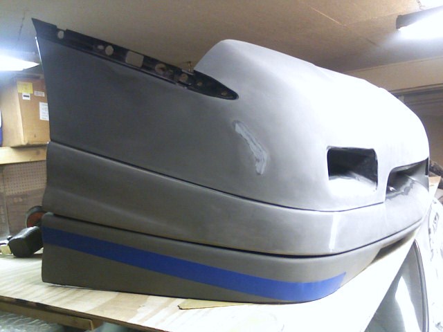

For those of you who have done it, what's the best way to strip the paint off of the front and rear fascias? I've been trying Aircraft stripper, but it doesn't seem to really attack the paint. A friend suggested sand blasting, but I'm afraid it'll pock-mark the urethane.

Actually, I DO need to remove all the paint. The bumper was hit and "repaired" at some time in the past without using a flex agent, then hit again, so there are spider cracks in the paint that need to be taken down to the substrate. Sanding won't feather it out cleanly.

Thanks! Those are great links and I like your bumper cover. I'm working with a Formula, so haven't decided if or how I'm going to mod the F&R. I just spoke with a local company that does media blasting with sodium oxide that can remove the paint without damage,(he says he has done a lot of Corvettes) so I'm going to take it over there next week to get a quote. Ballpark about $60, it may be worth it, as I tried sanding some of it last night with 220 and it was slow going and difficult to get into curves and corners.

have it blasted with either walnut shell or bead glass. they will removed nothing but the paint. NEVER use "paint remover" on urethane, it will ruin it.

Will he be doing the blast on or off the car? That seems like an excellent price that saves you tons of time and surely must produce a more uniform result than a DA and hand sanding (at least in the hands of someone who doesn't do paint prep every day.)
Habanera Hal JAN 20, 03:04 PM
I have the fascia off the car. I won't be able to get over to him until later this week.
