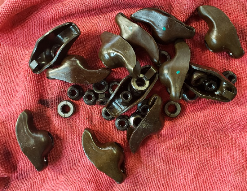

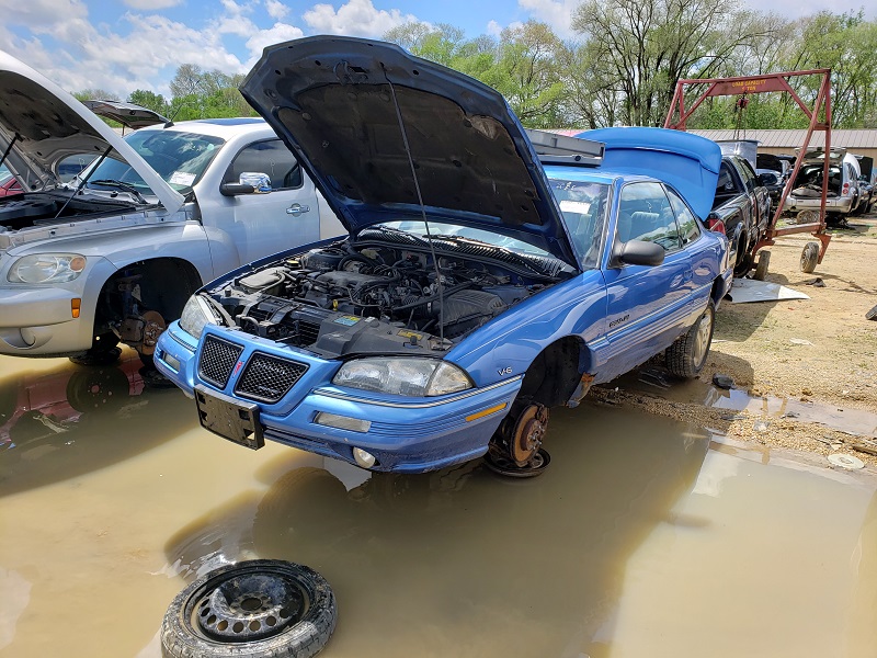

I pickup some 1.6 rockers today at LKQ. (Page 1/1)
hercimer01 MAY 27, 01:59 AM
They came from a 1994 Pontiac Grand Am.

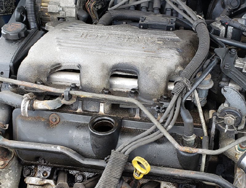

It has the black plastic valve covers and you see them through the oil filler neck.
The newer 3100s have different rocker arms in them and the valve covers are aluminum.

Patrick MAY 27, 02:12 AM
A little late now... but it would've been best to have kept the balls with their original rocker.
hercimer01 MAY 27, 02:19 AM
I wondered about that.
sourmash MAY 27, 09:06 AM
So, I'm assuming these can be used with the stock 2.8 and 3.4 push rod engines? Any other mods that should be used with them, like springs?
Patrick MAY 27, 01:20 PM
I installed roller-tip 1.6 rockers on my Formula. No other valve train components are required to be changed as long as the factory cam has been retained.
However, I would strongly advise the exhaust manifolds at least be ported to get rid of the ridiculous metal restrictions left in place by Pontiac. The exhaust cross-over pipe could be modified and improved as well. It's all about flow.
