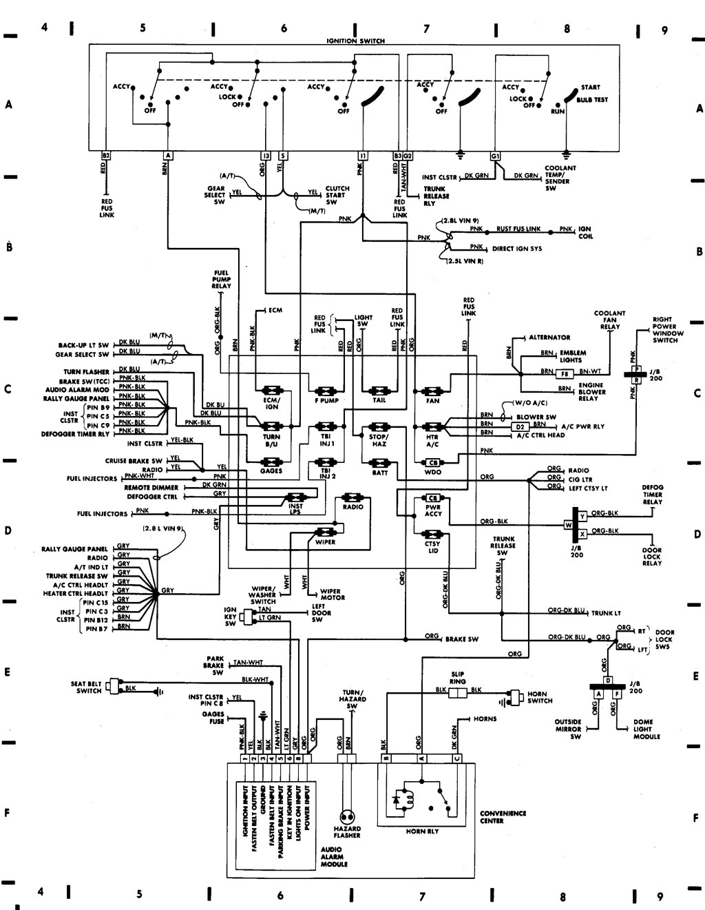

There is an orange wire from the tail light fuse (TAIL) to the light switch. Make sure the radio is not tapped into this wire. The original radio power wire is also orange, but it comes from the BATT fuse. There are actually 3 power sources for a stock Fiero radio.....Orange, Yellow, and Gray.

Radio memory is connected to the Orange wire (constant 12v, verified)
12V Ignition is connected to the yellow (that does turn on with the key, verified)
Illumination is connected to the Grey wire (verified with a multimeter with the lights on and it works to dim the headunit)
Like I mentioned before I changed or unplugged each wire one at a time or together with the same result, blowing the fuse. However once I moved the ground to its on ground point not tied into the car wiring the fuse did not blow. I appreciate the quick responses and the helping hand.
