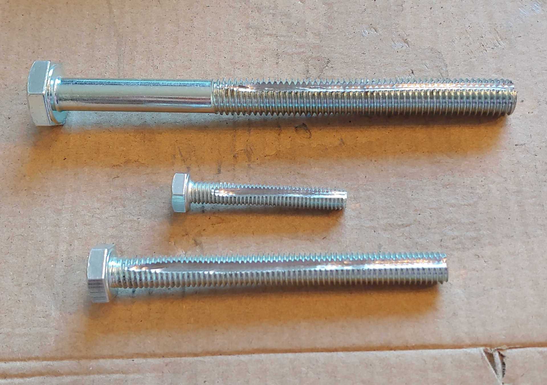

Cliff Pennock MAY 15, 12:16 PM
The taps I have aren't anywhere near long enough to be able to clean the holes entirely so I just took some long bolts an cut a few slots in them:

Patrick MAY 15, 02:25 PM
Not bad. How'd you cut the slots?
