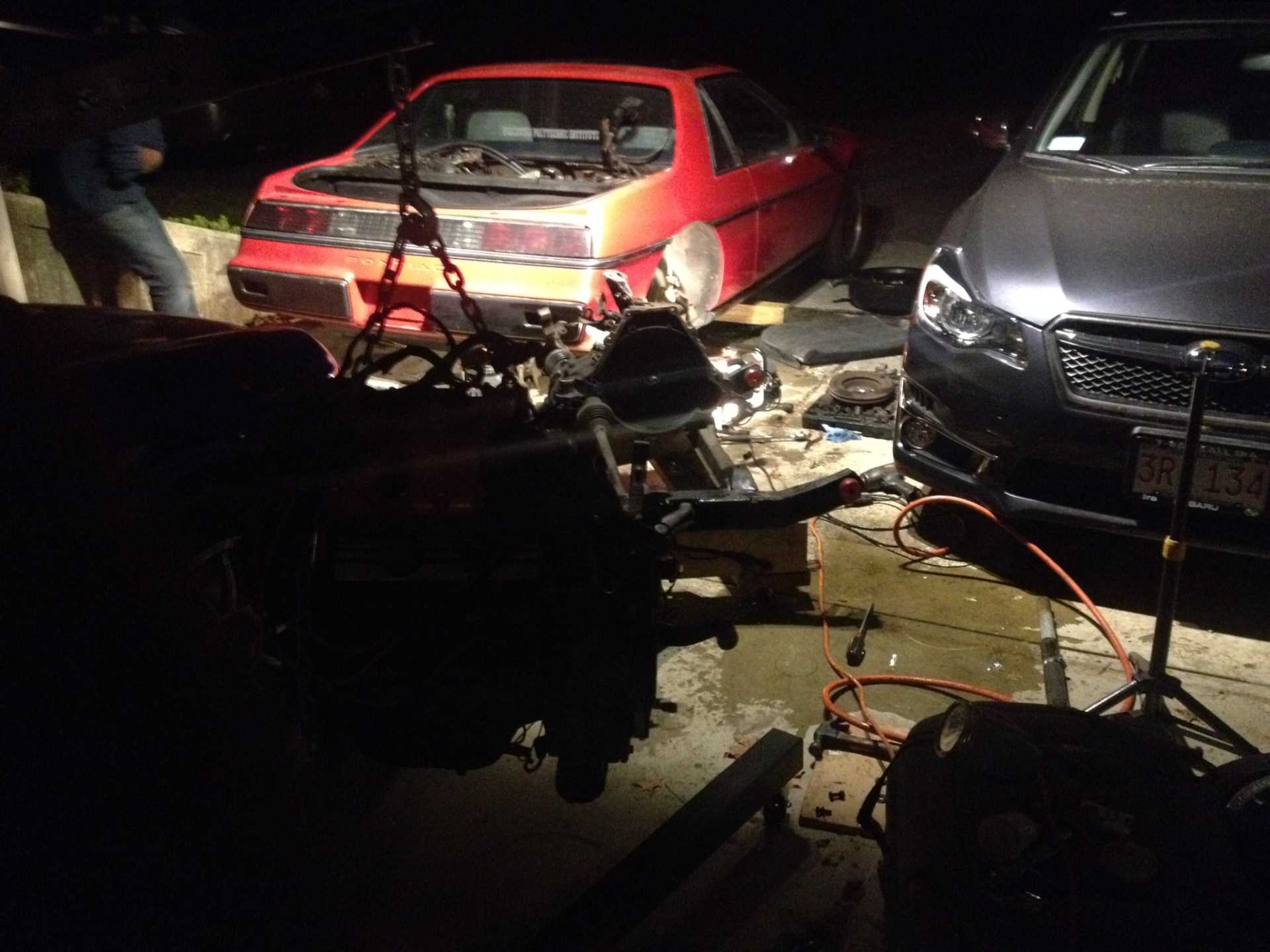

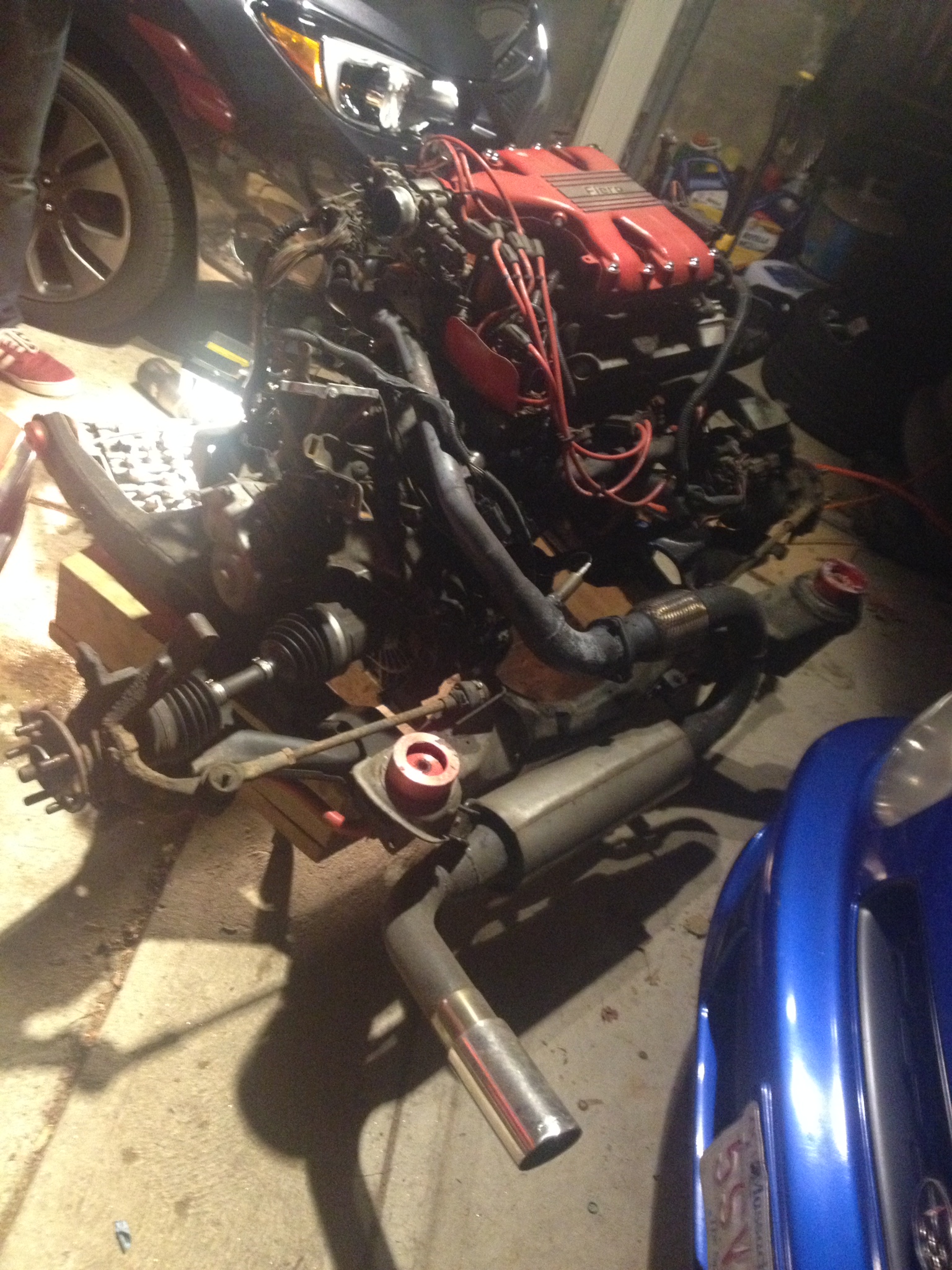

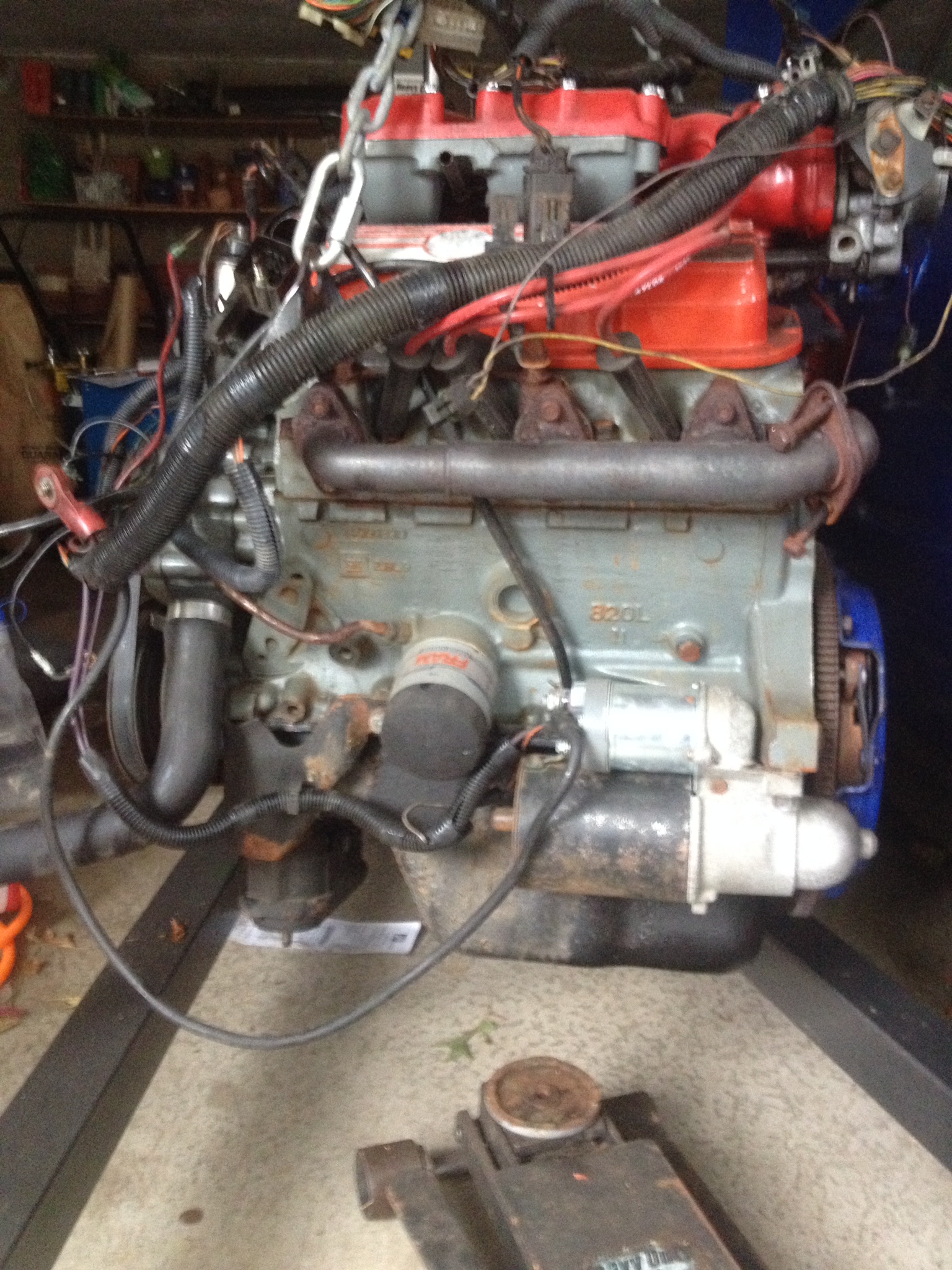

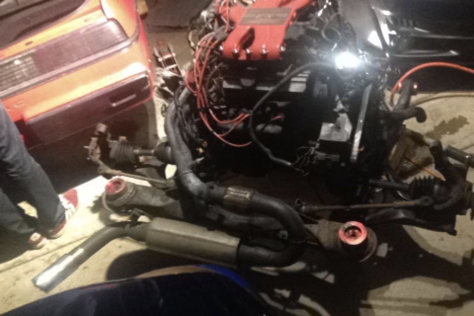

zkhennings MAR 11, 10:48 PM

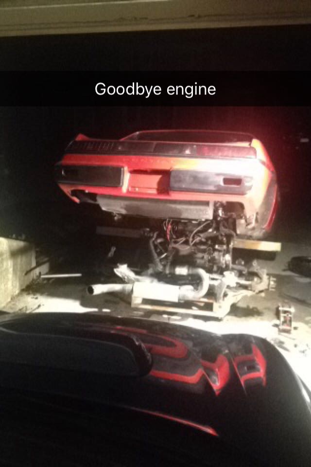

Finally beginning to gather information and parts to start an LE5 swap. Found some more pictures of my drivetrain with the final exhaust. Exhaust did not require any modifications to trunk. Motor was pulled as I ended up selling it in 2015.

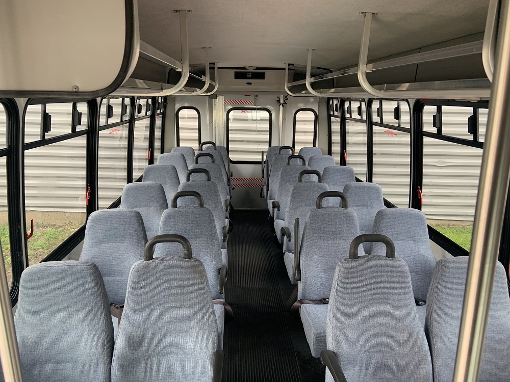

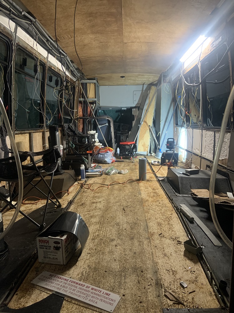

I have mainly been working on my dirtbikes and my WRX for the past several years, without making anything too large of a project. I also bought a 24 seat shuttle bus in September 2020 to turn into an adventure mobile, it is a place to stay when snowboarding, can haul dirtbikes, and tow racecars. Long story short my Fiero has been neglected as my focus has been shifted.

The Bus
Interior
Current state of dissasembly

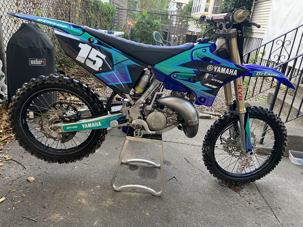

Dirtbike things

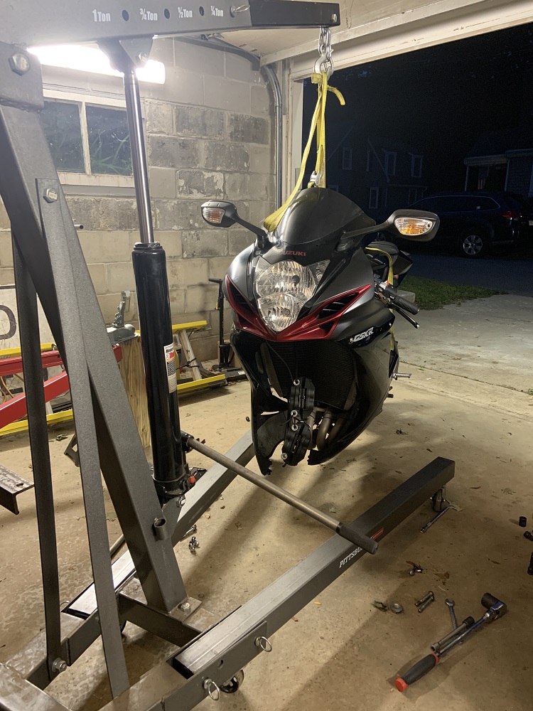

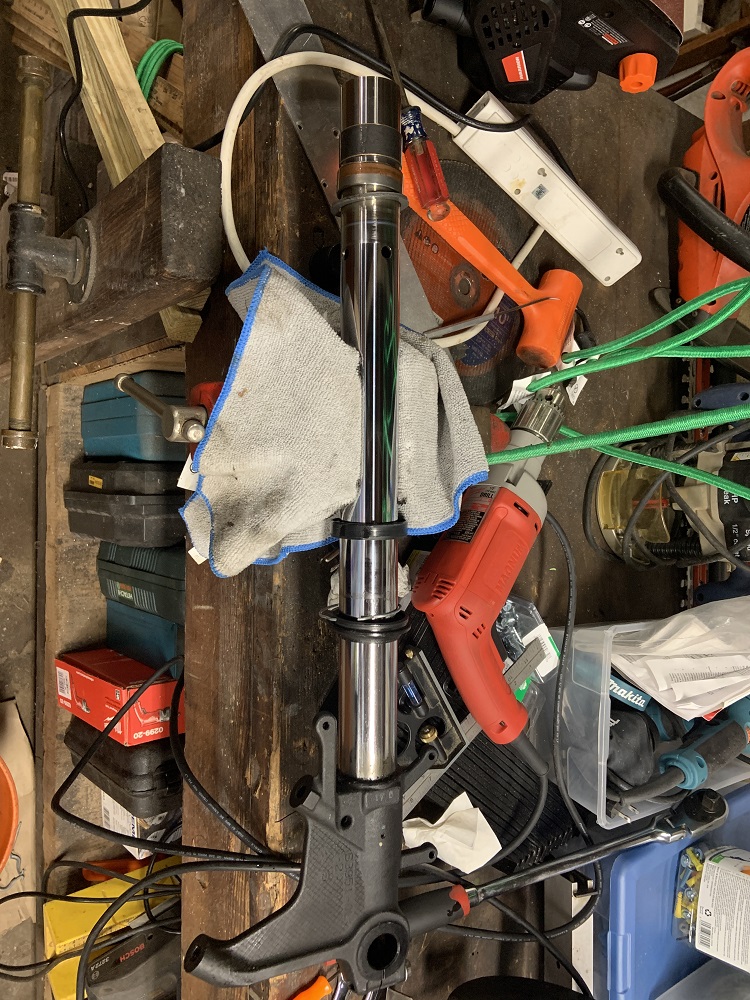

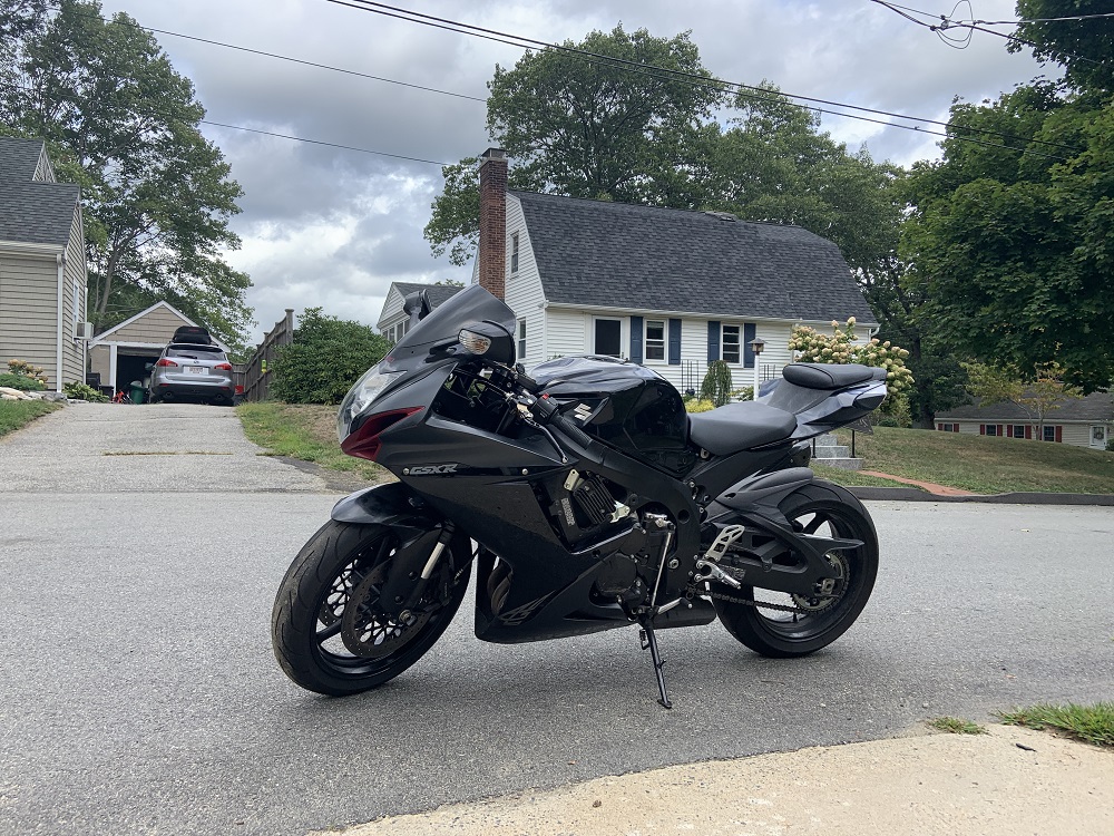

Replacing leaky fork seals on my girlfriend's GSXR 600
