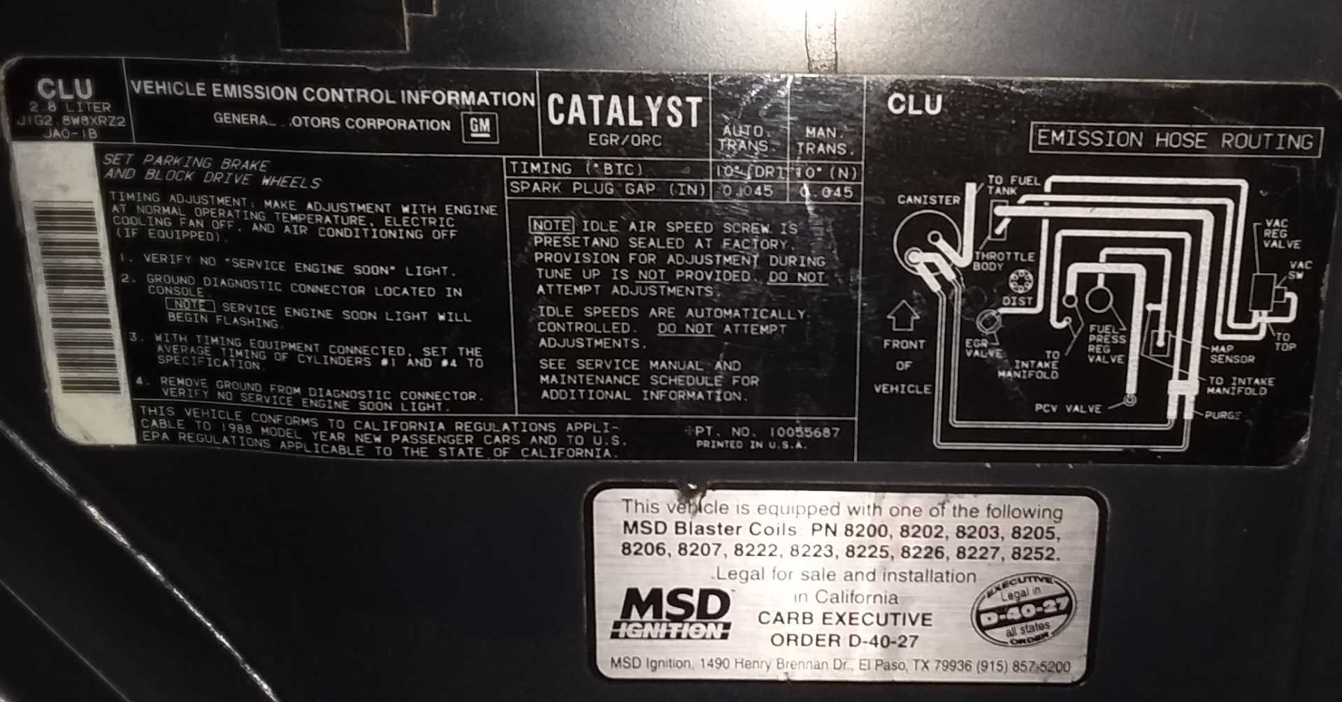

I thought I'd grab a photo of the sticker so everyone could see what information it had on it. Two things became clear:
1) The car had an aftermarket coil that I never noticed before. Doh!
2) The diagram on the sticker really makes the solenoid quite obvious. How could a tech fail to flag a missing solenoid?
