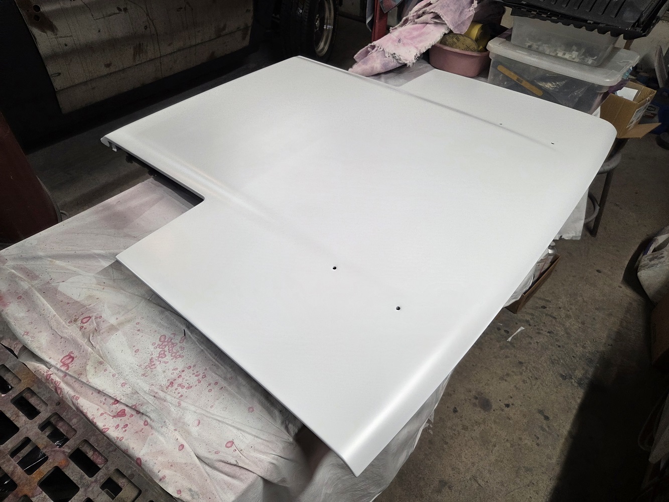

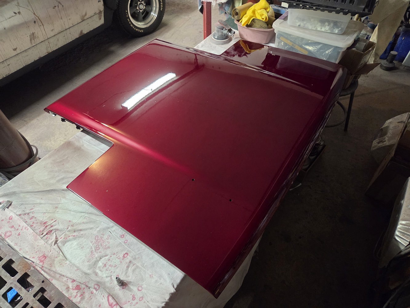

hercimer01 OCT 09, 10:24 PM

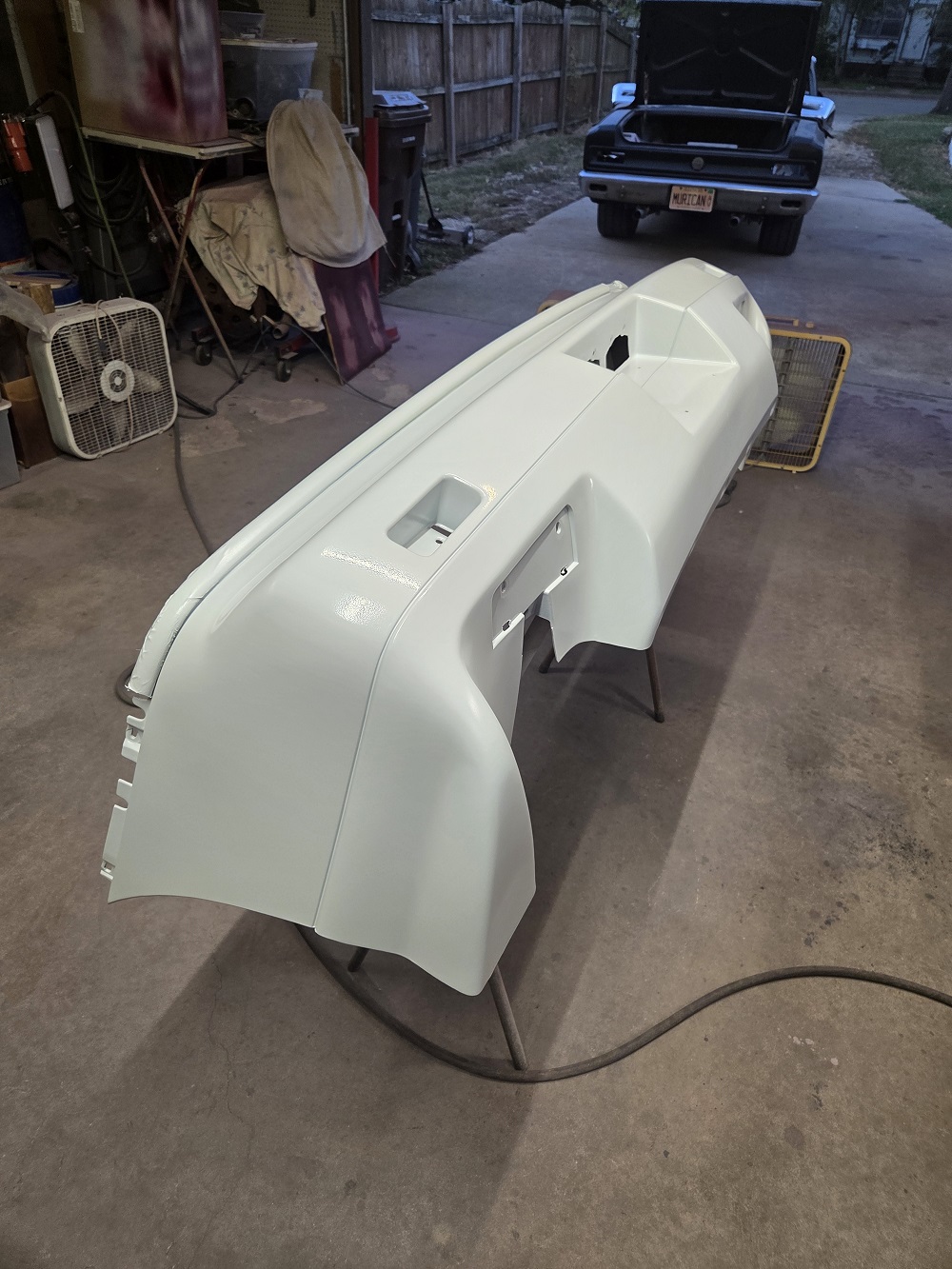

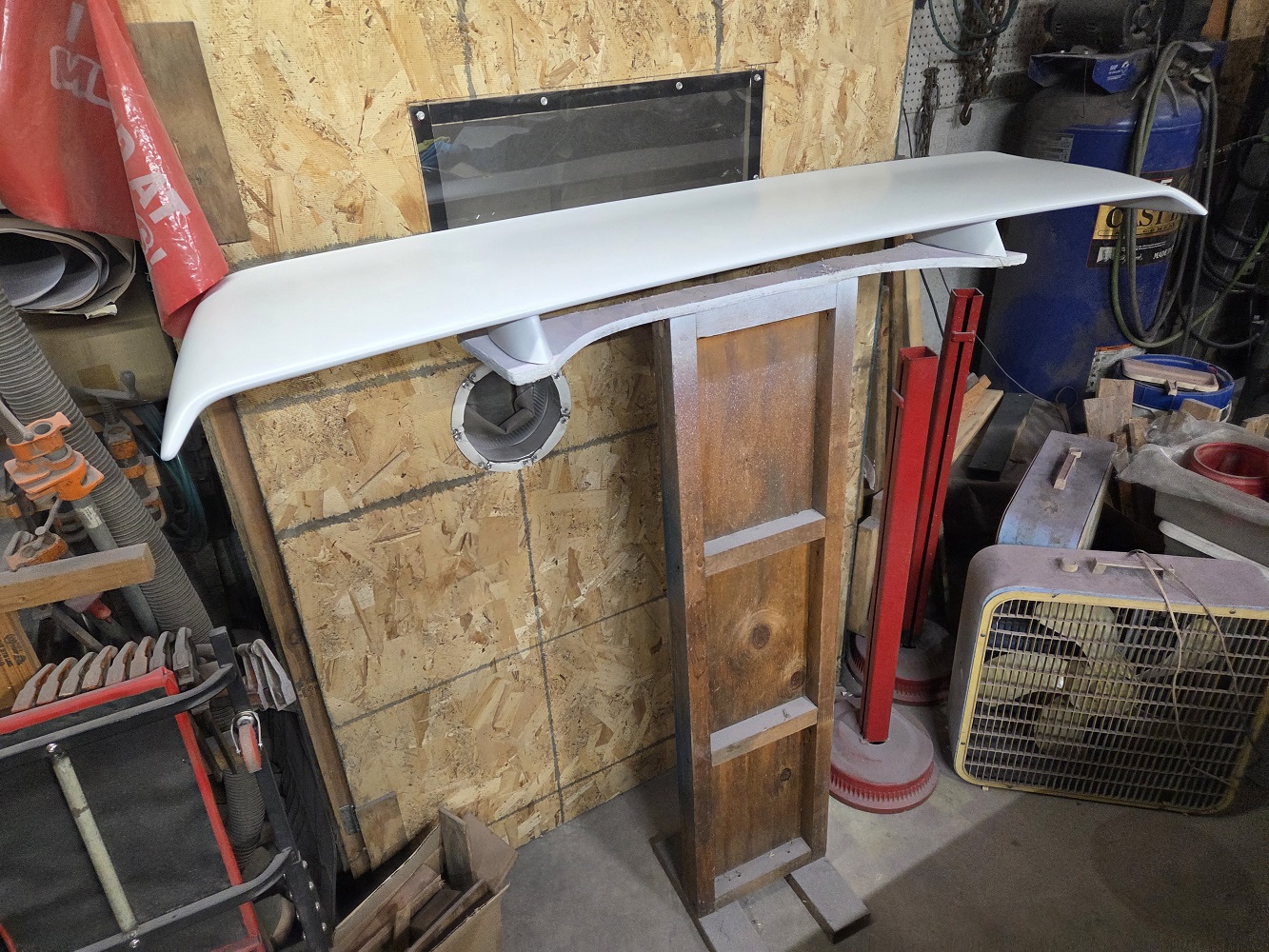

It's getting dark sooner. I got the trunk lid and wing done. All thats left are the bumper covers and trim.
I shall call thee SKEETER!

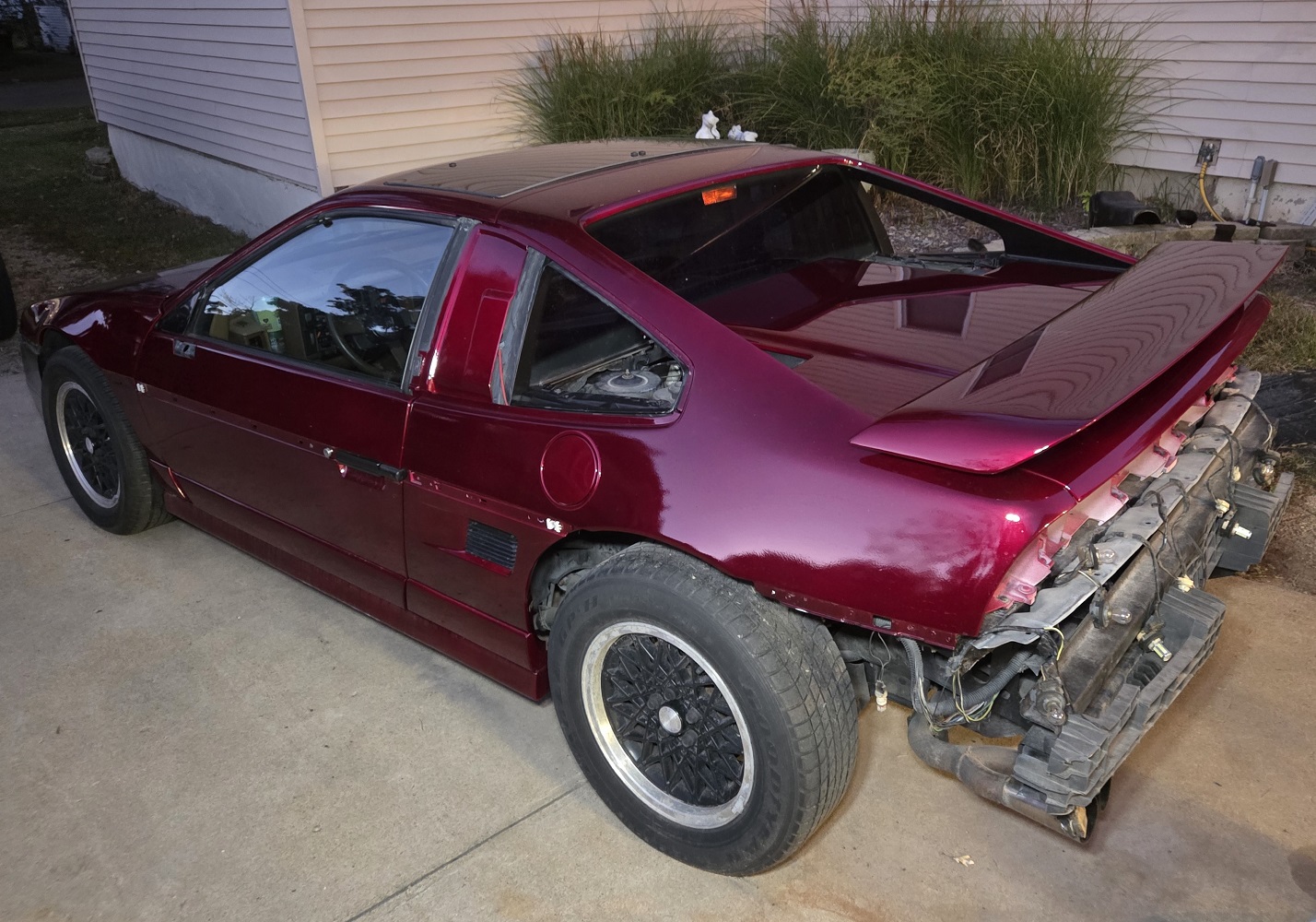

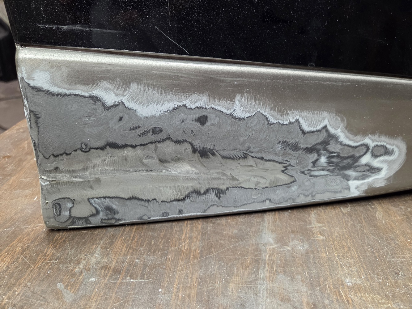

Been busy on it.
SKEETER! AHHHH!

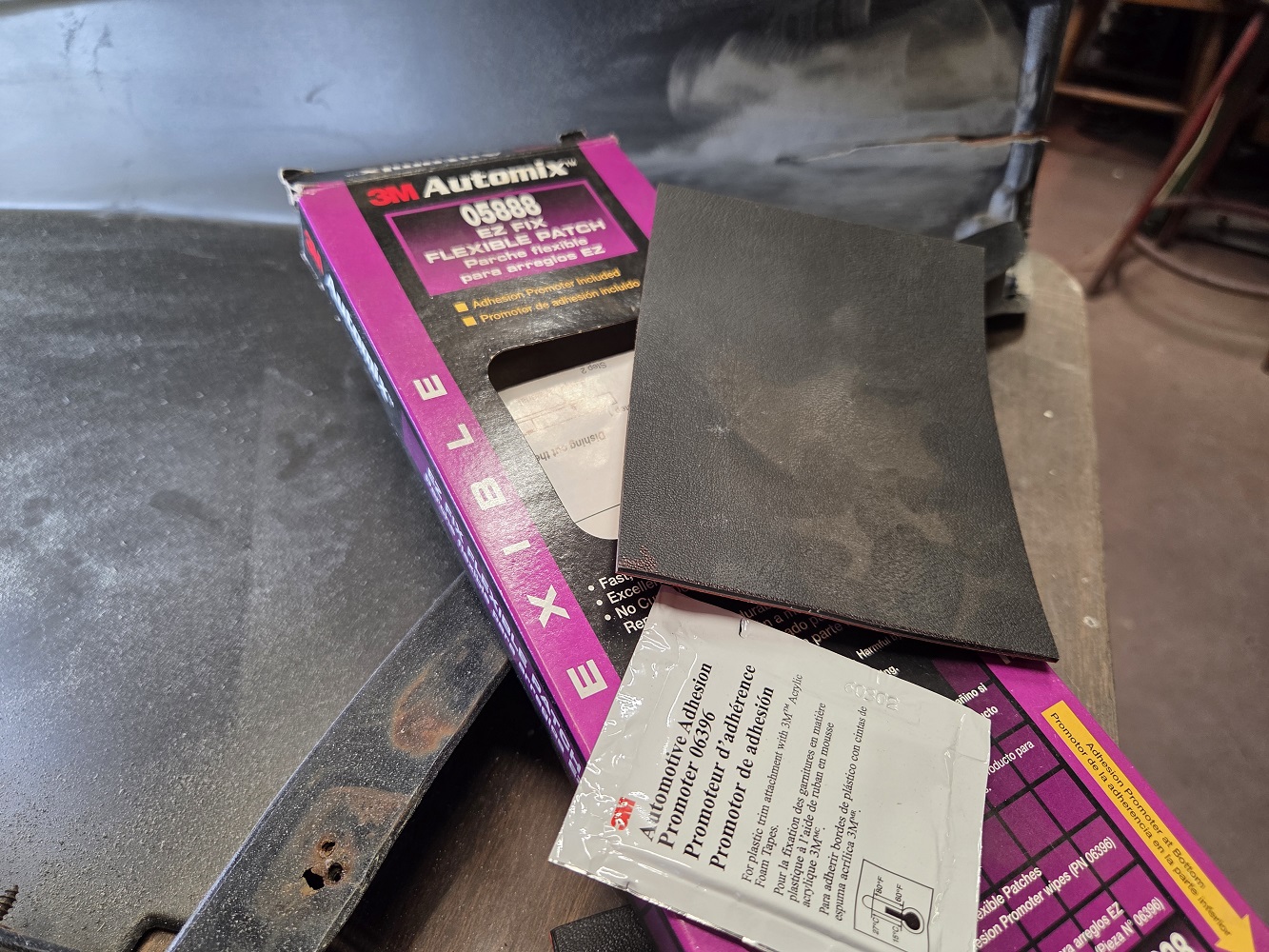

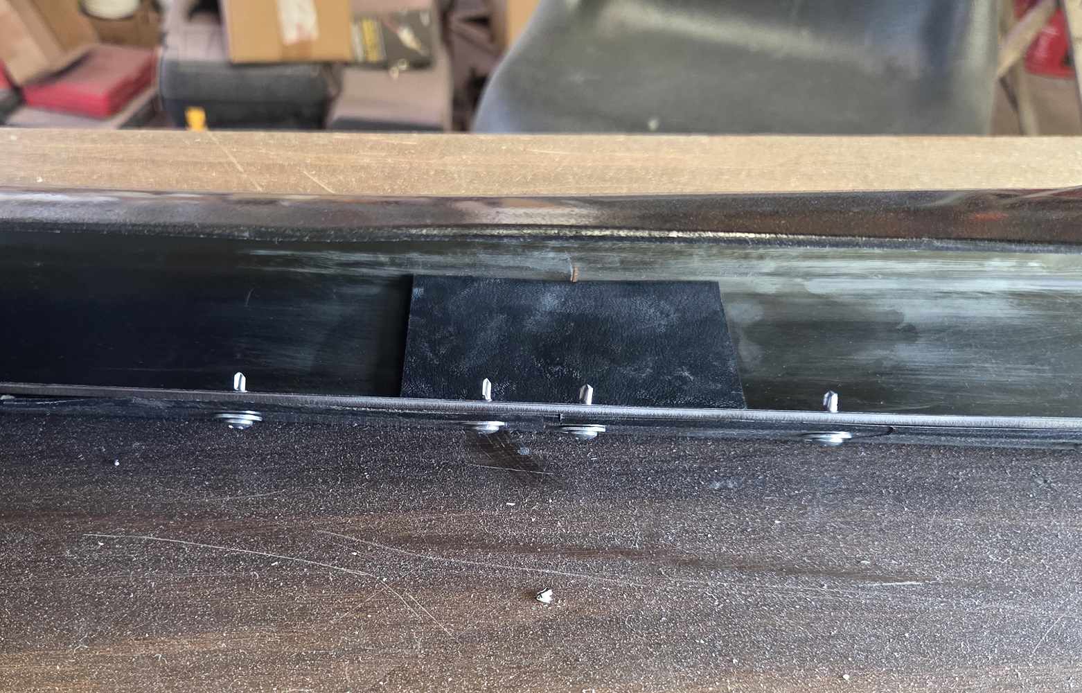

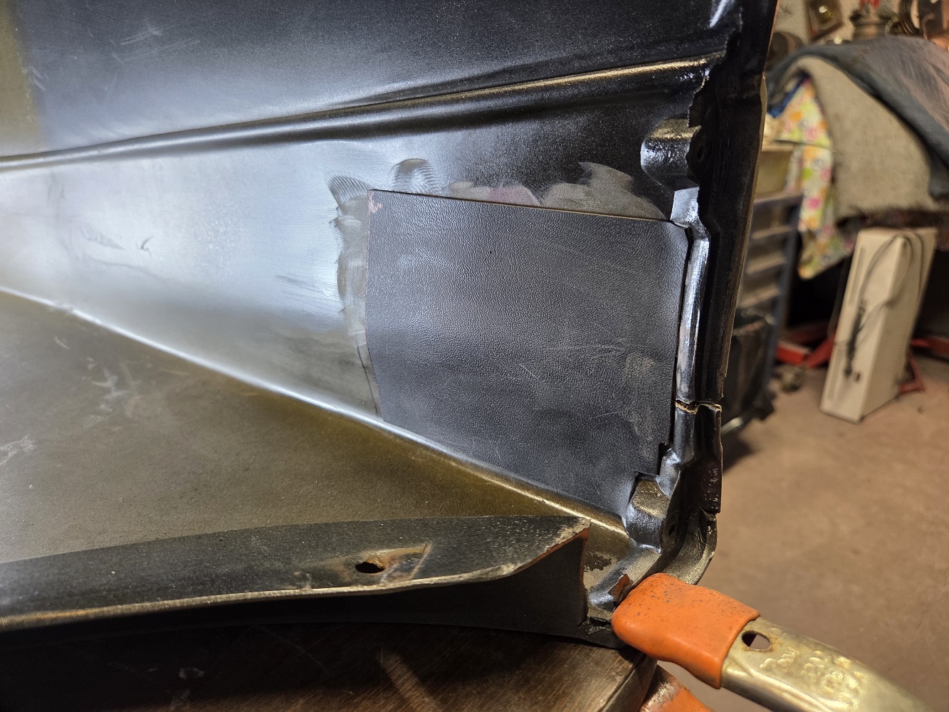

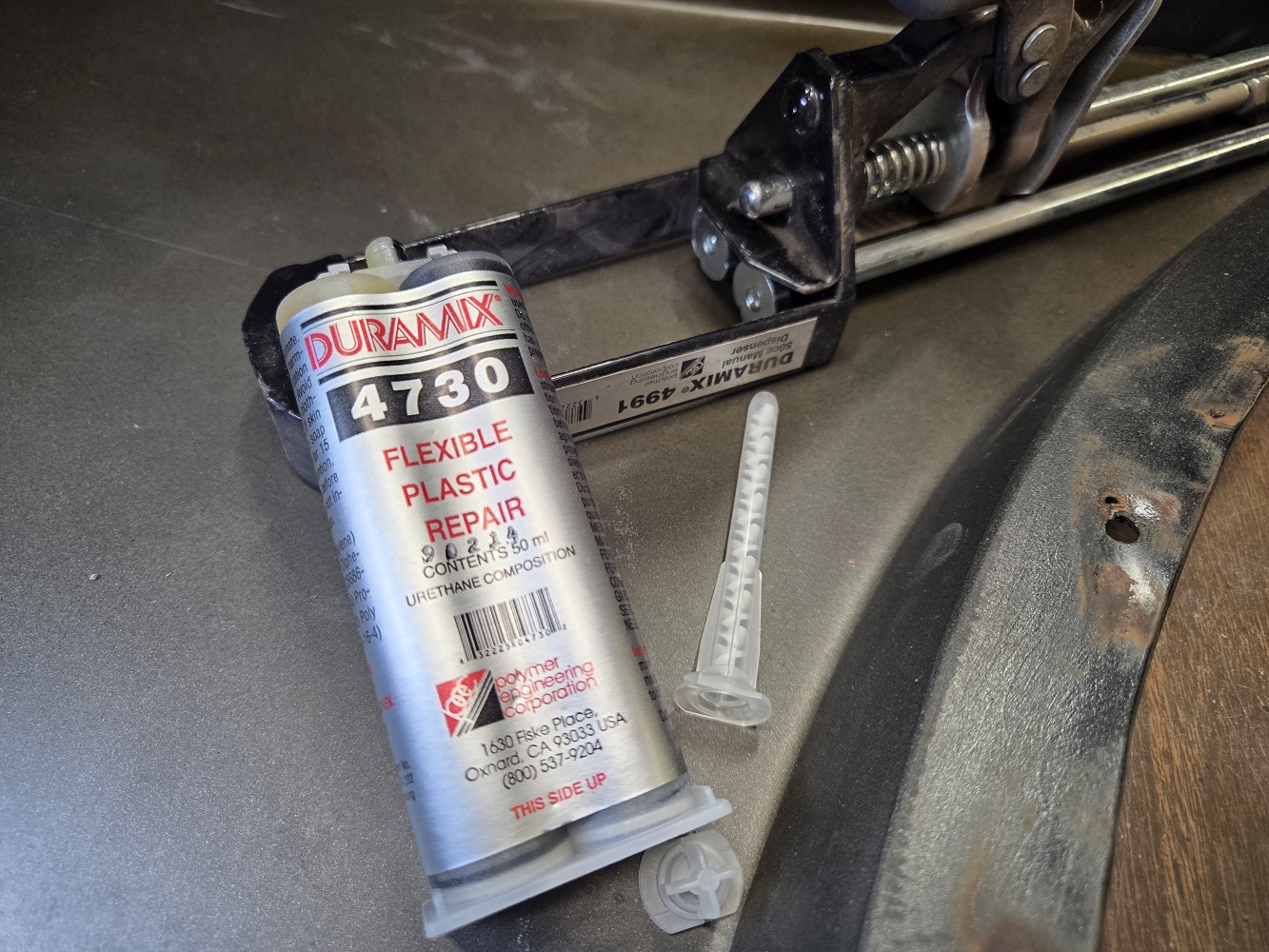

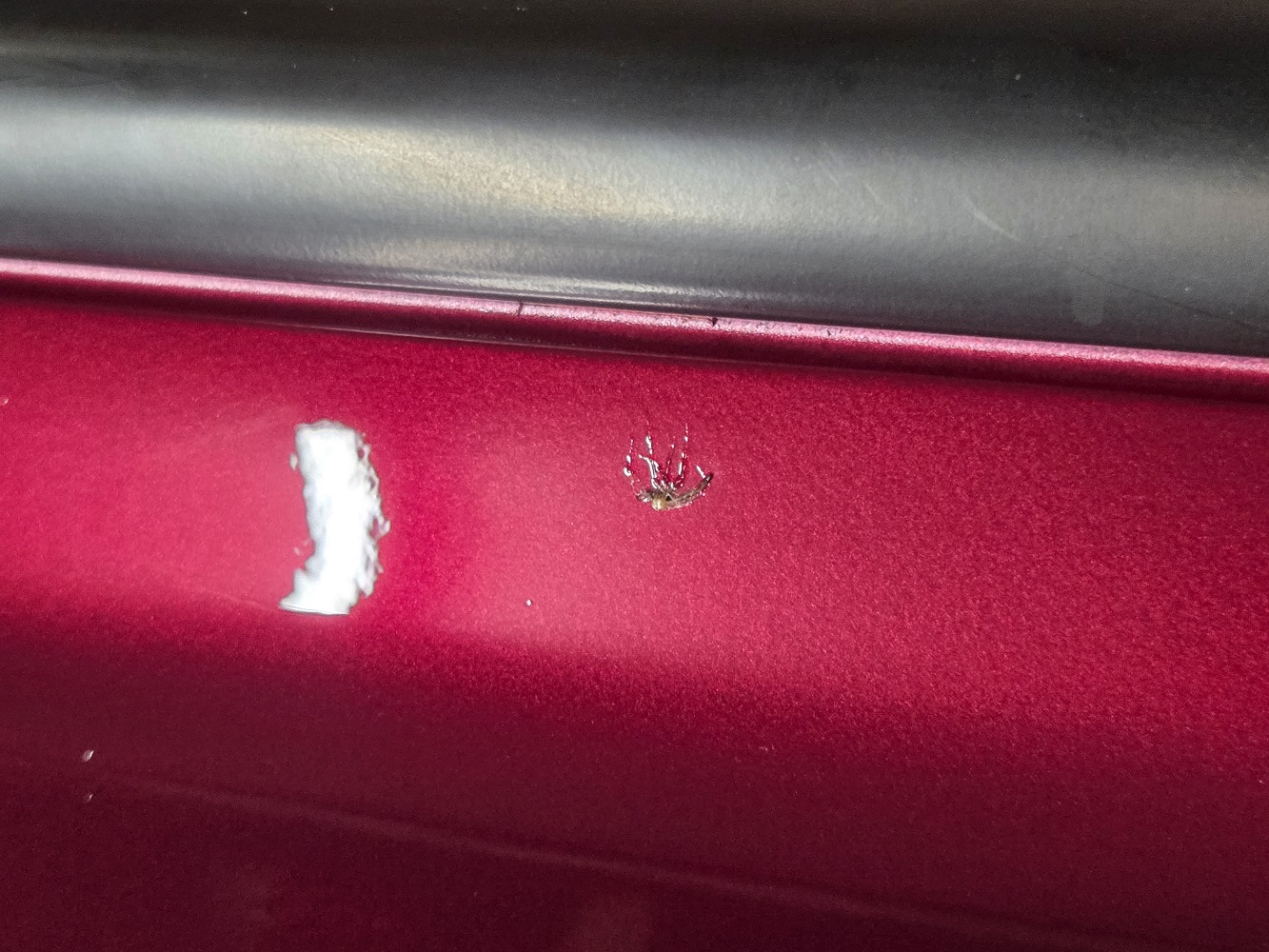

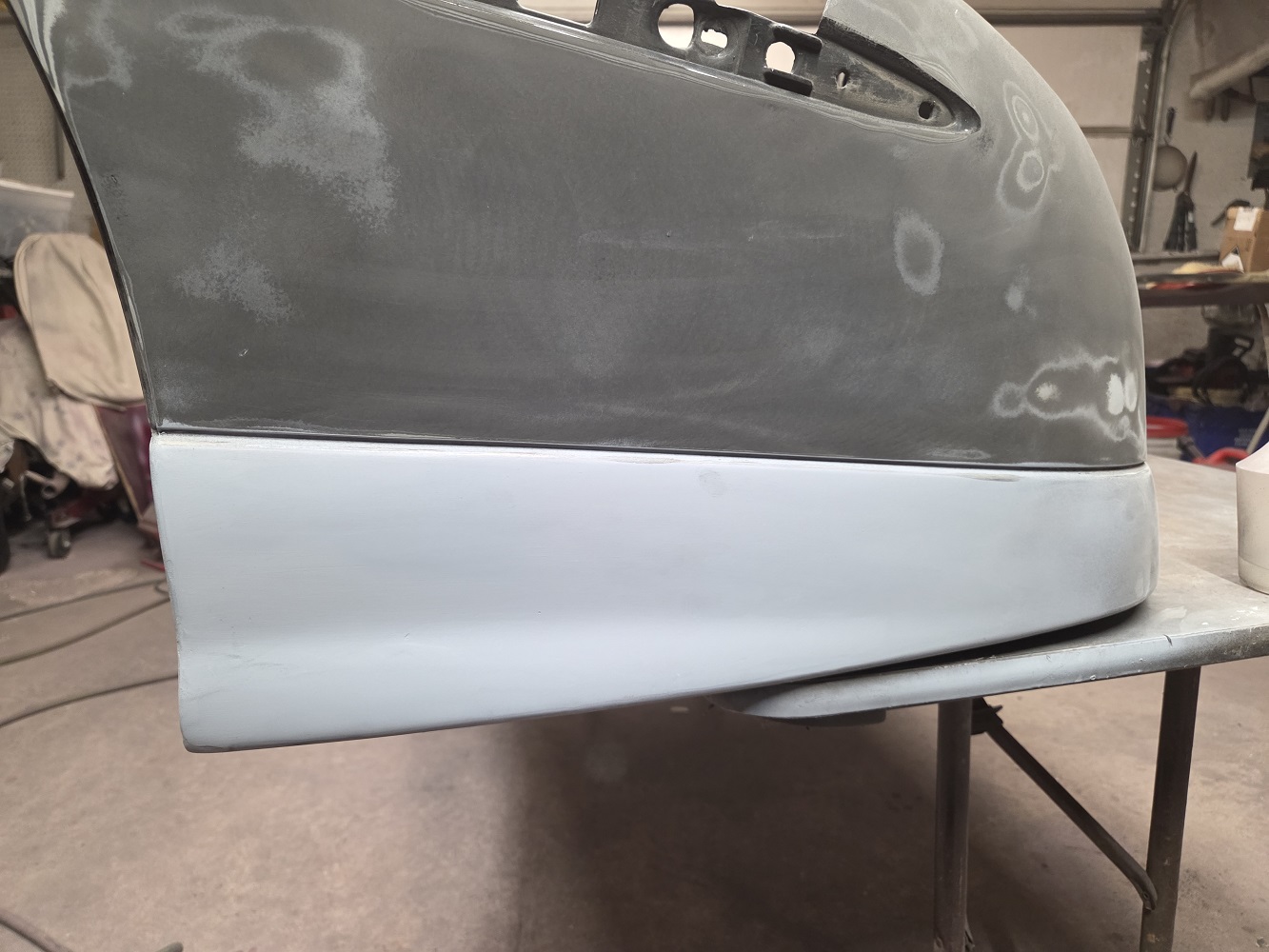

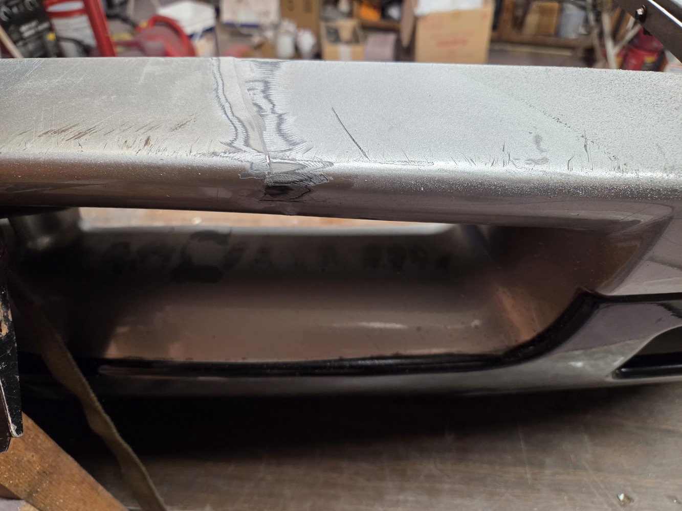

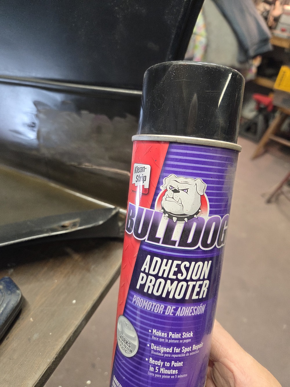

This was a previous repair gone horribly wrong. It was just bondo on a tear. Needless to say it failed. I had to chisel out a ton of filler from the area. 3M sticky patches and flexible filler is the only thing that will last.
This is an old picture. This summit link is a current product.
[This message has been edited by hercimer01 (edited 10-19-2025).]

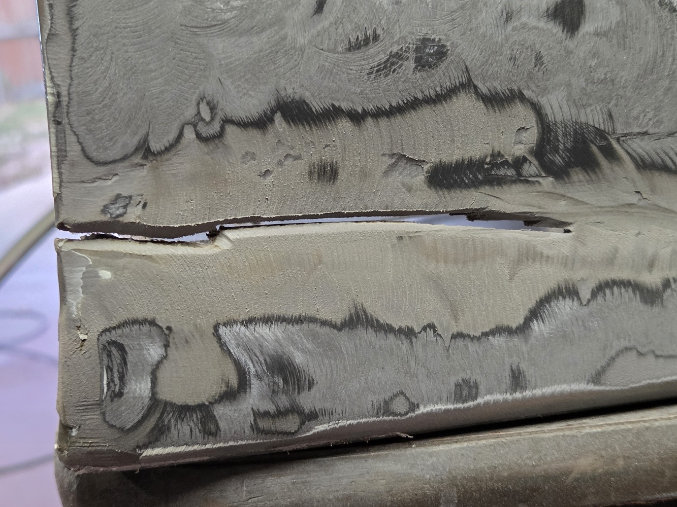

hercimer01 OCT 19, 11:44 PM

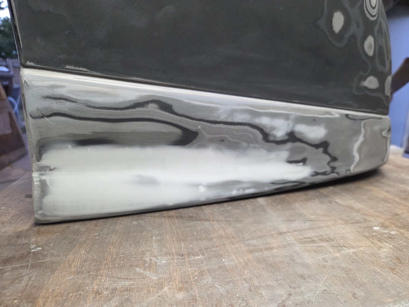

I had to give the repair one more skim coat of filler.
Also I had to grind out all of the spider web cracks because they will just show back though in the new paint.

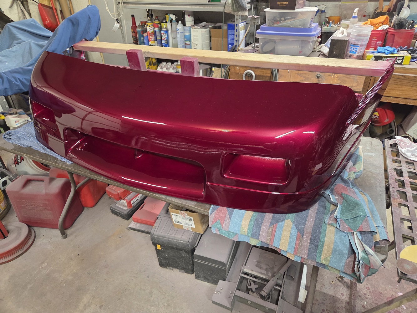

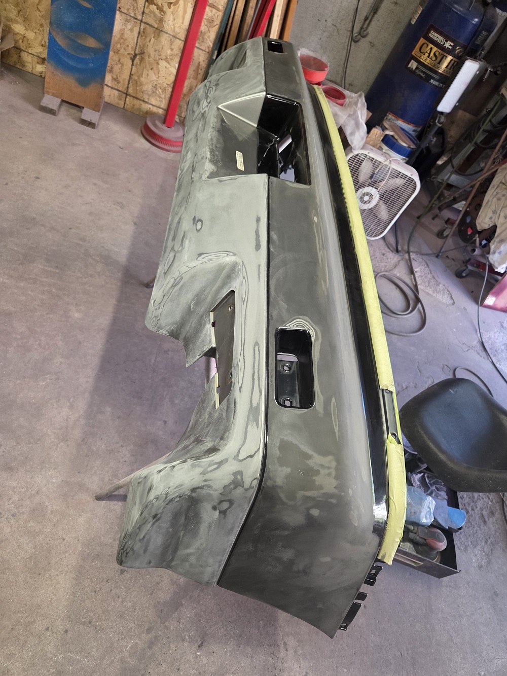

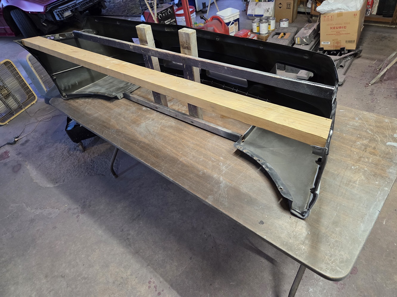

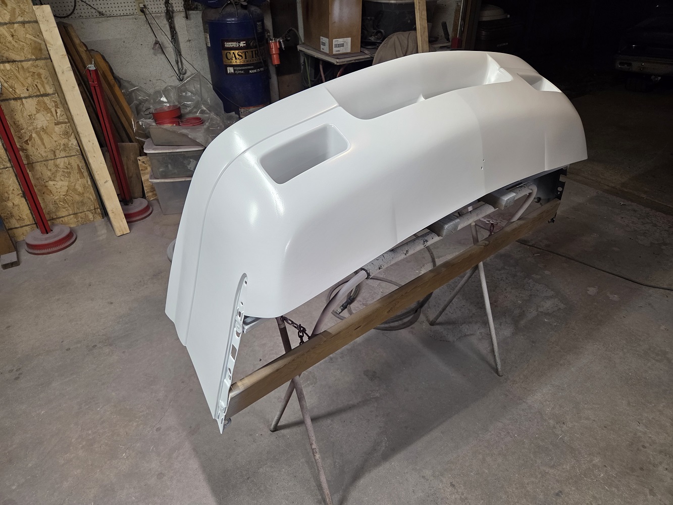

I have a frame to strengthen the bumper cover while handling. It's ready for primer now.

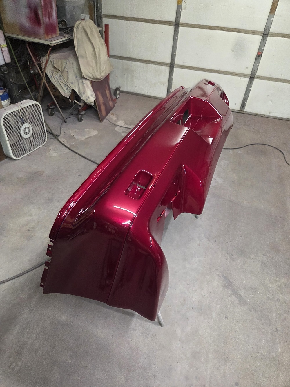

hercimer01 OCT 23, 12:09 AM

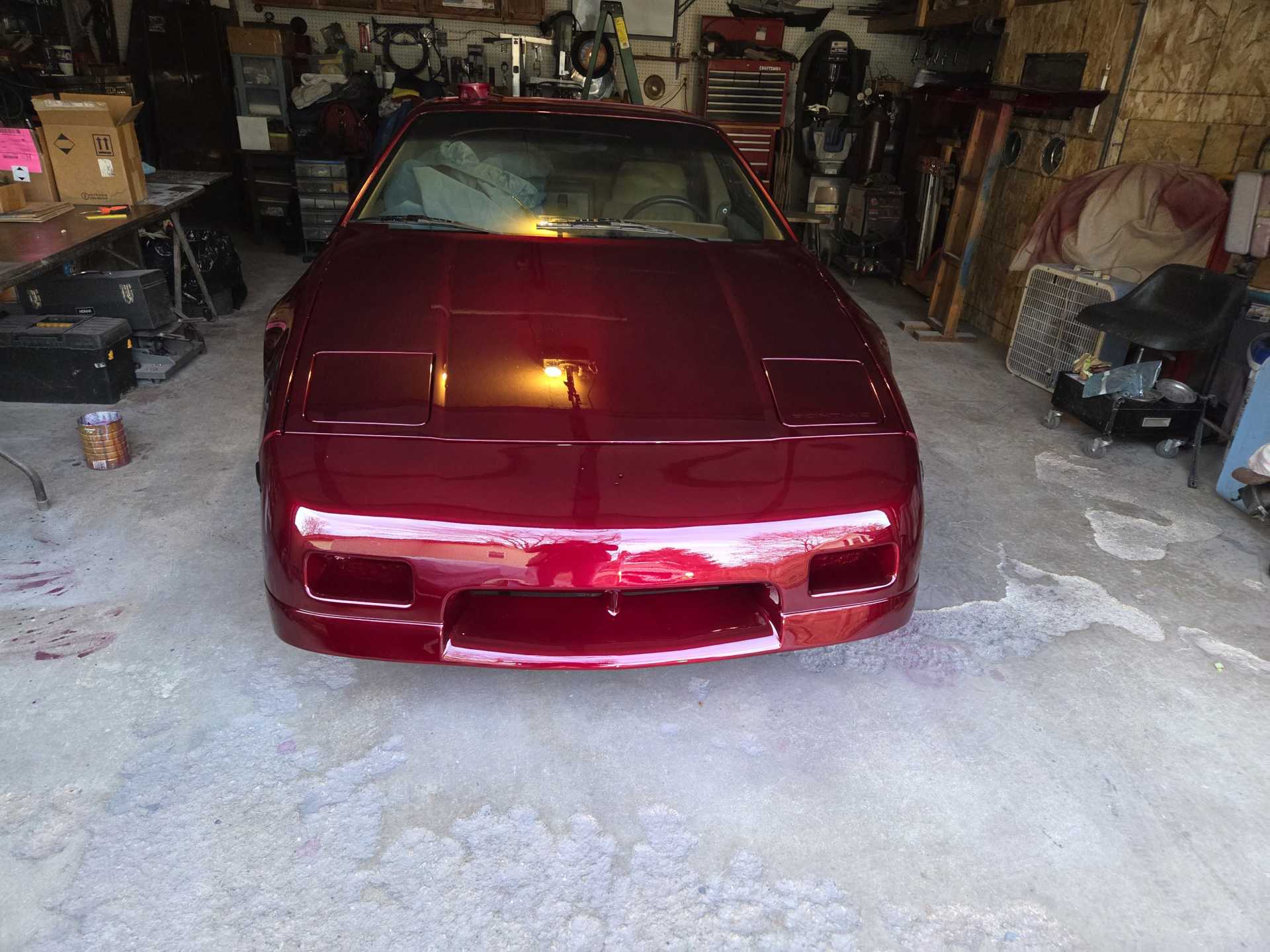

Finally got the nose done.

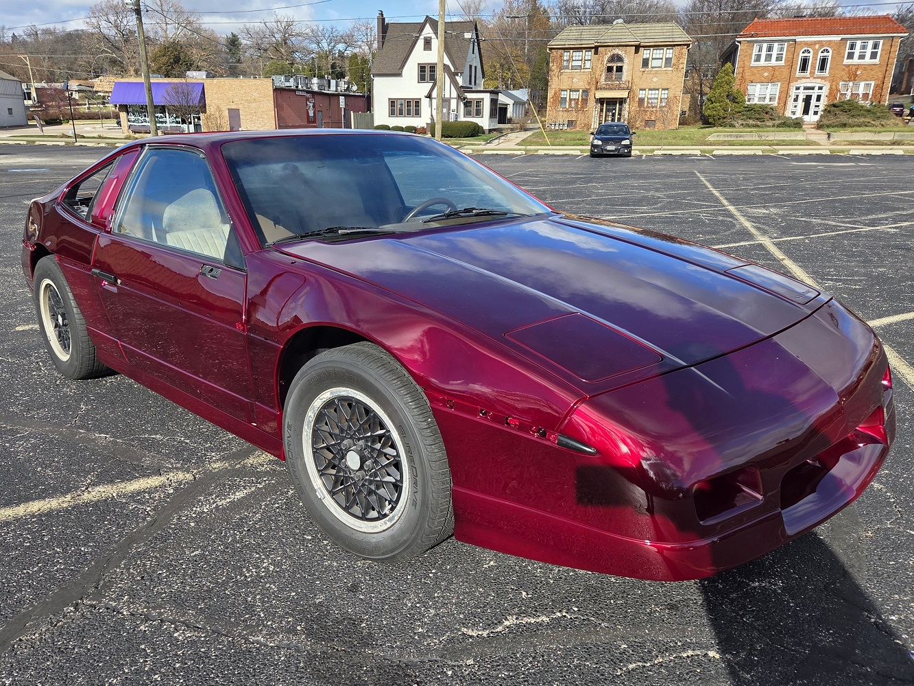

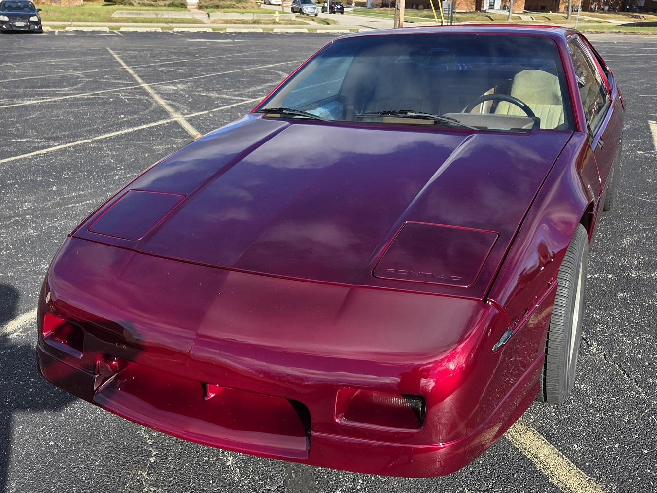

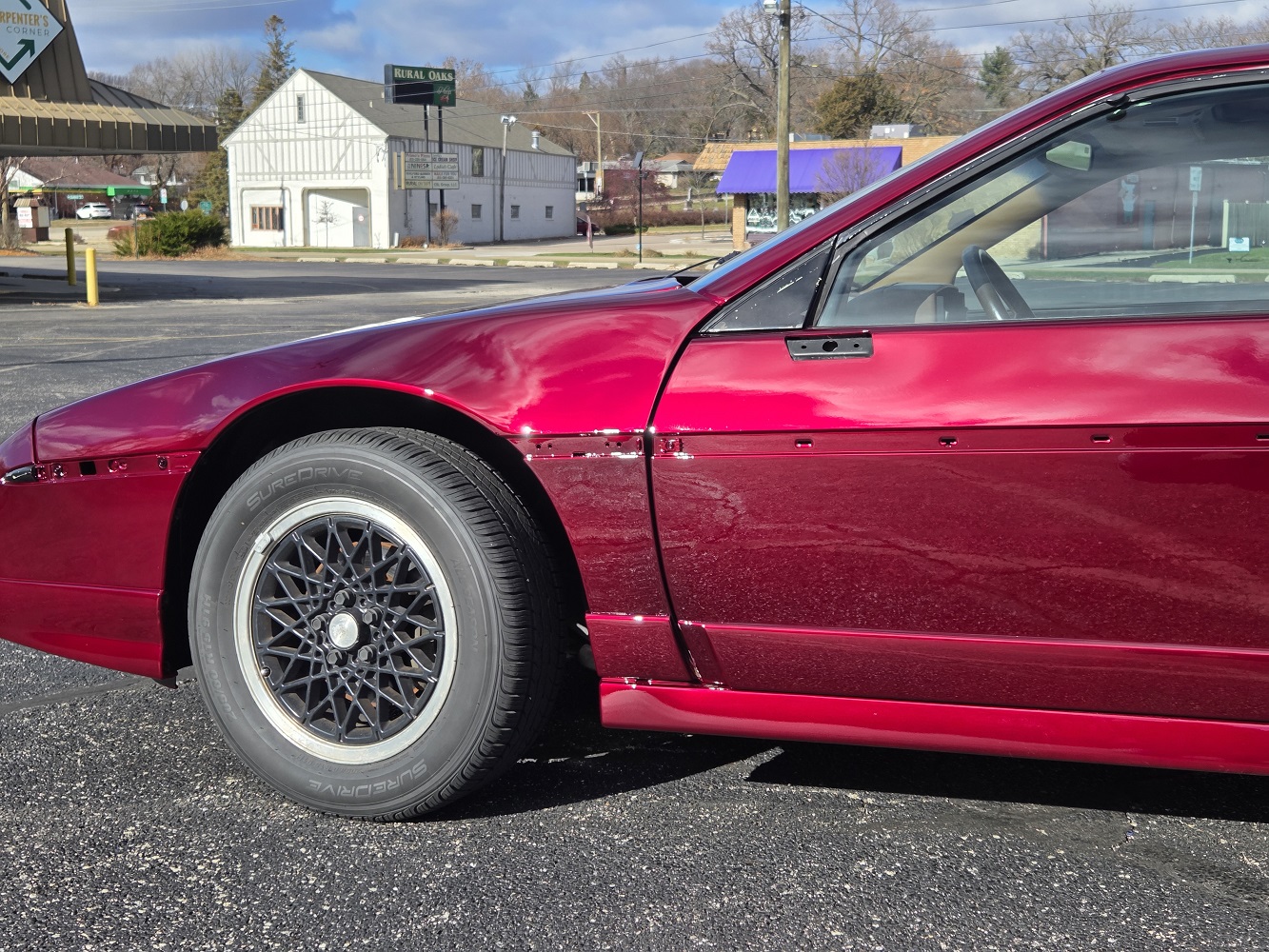

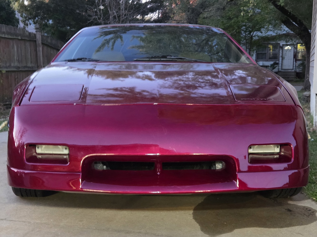

I got the nose mounted and the color shades are matching up really well. It just came down to making sure I had full coverage with the base coat.
This is the repair.
I think I might do a ghost Pegasus in Solar Gold on the hood. What do you guys think I should do if anything.

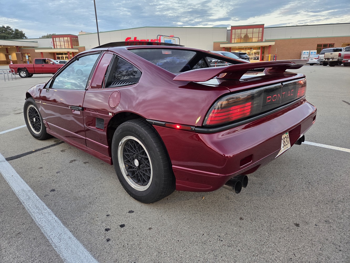

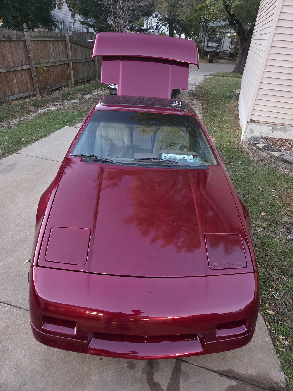

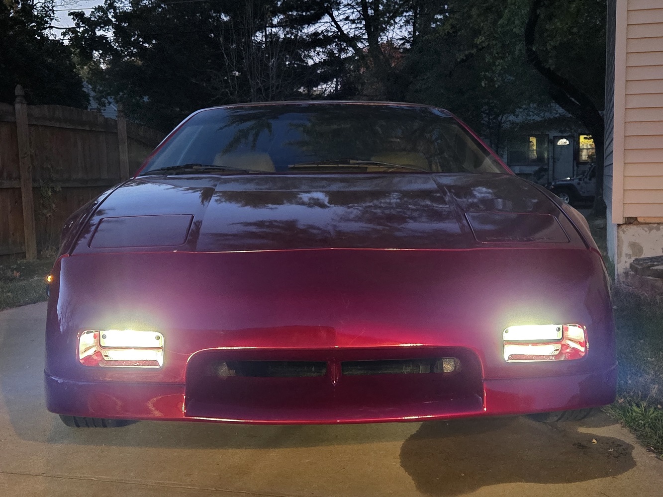

White COB running lights. They are bright at night. Not enough to be overwhelming like today's modern cars or butthole jeepsters like the one behind my car in the picture. I'm sure Ogre would have something to say about that.

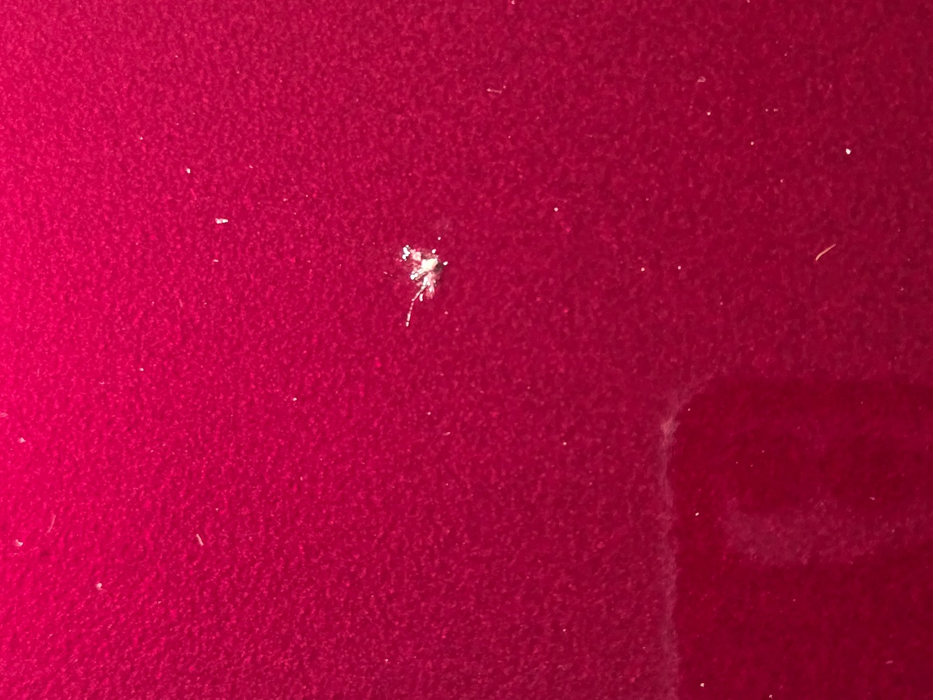

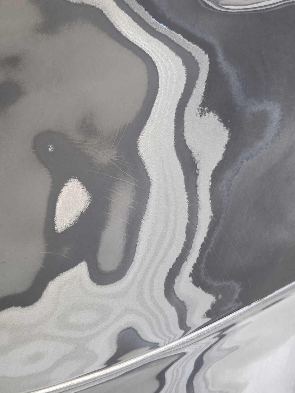

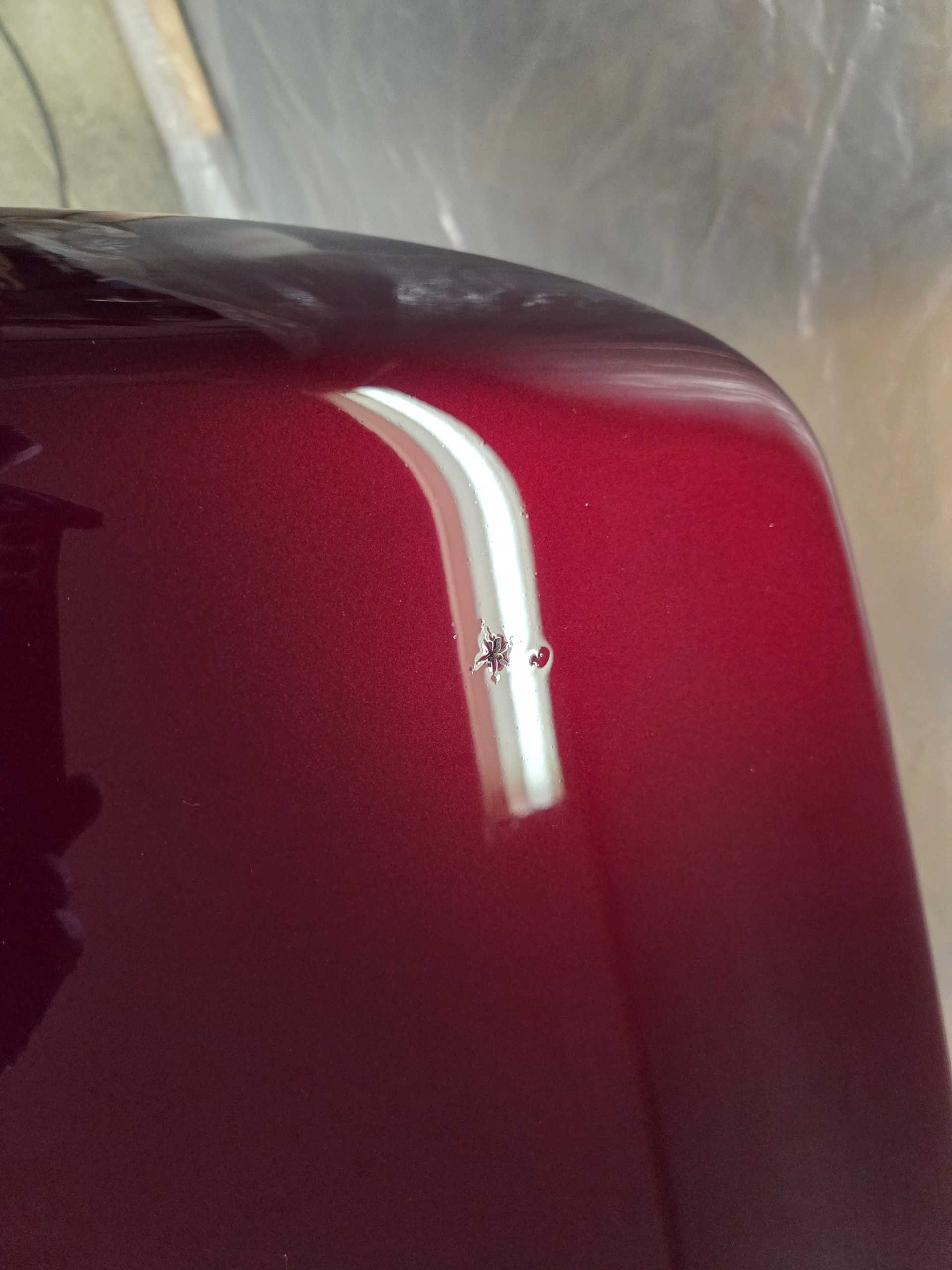

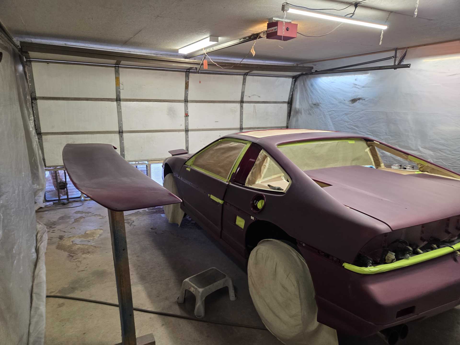

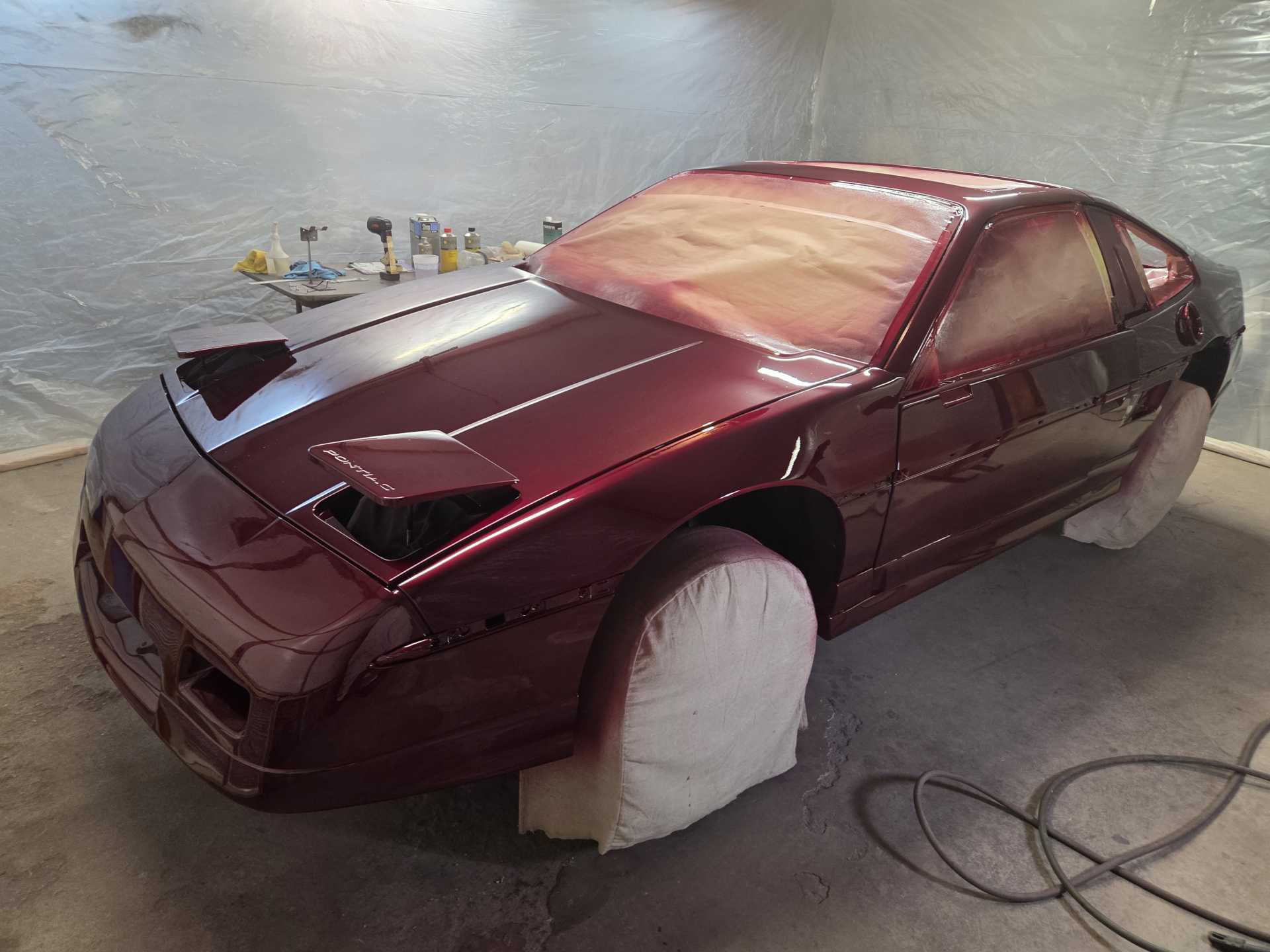

Note to self, don't use white for a base. Its too hard to cover evenly. I had to put on 2 more coats of colr and 3 coats of clear. I finally got the paint done. But it needs to be buffed out still. I sprayed it at 48 degrees Fahrenheit so clear laid out like glass. It's been cooking in my heated garage for 2 days now. I have plastic rolled up to the ceiling that I drop down when I paint. I also make a filter system for the garage door, but it doesn't seal at all on the top. It looks like Dexter's workshop. And of course one lowly mosquito survived our freeze and had to get in the paint some how.

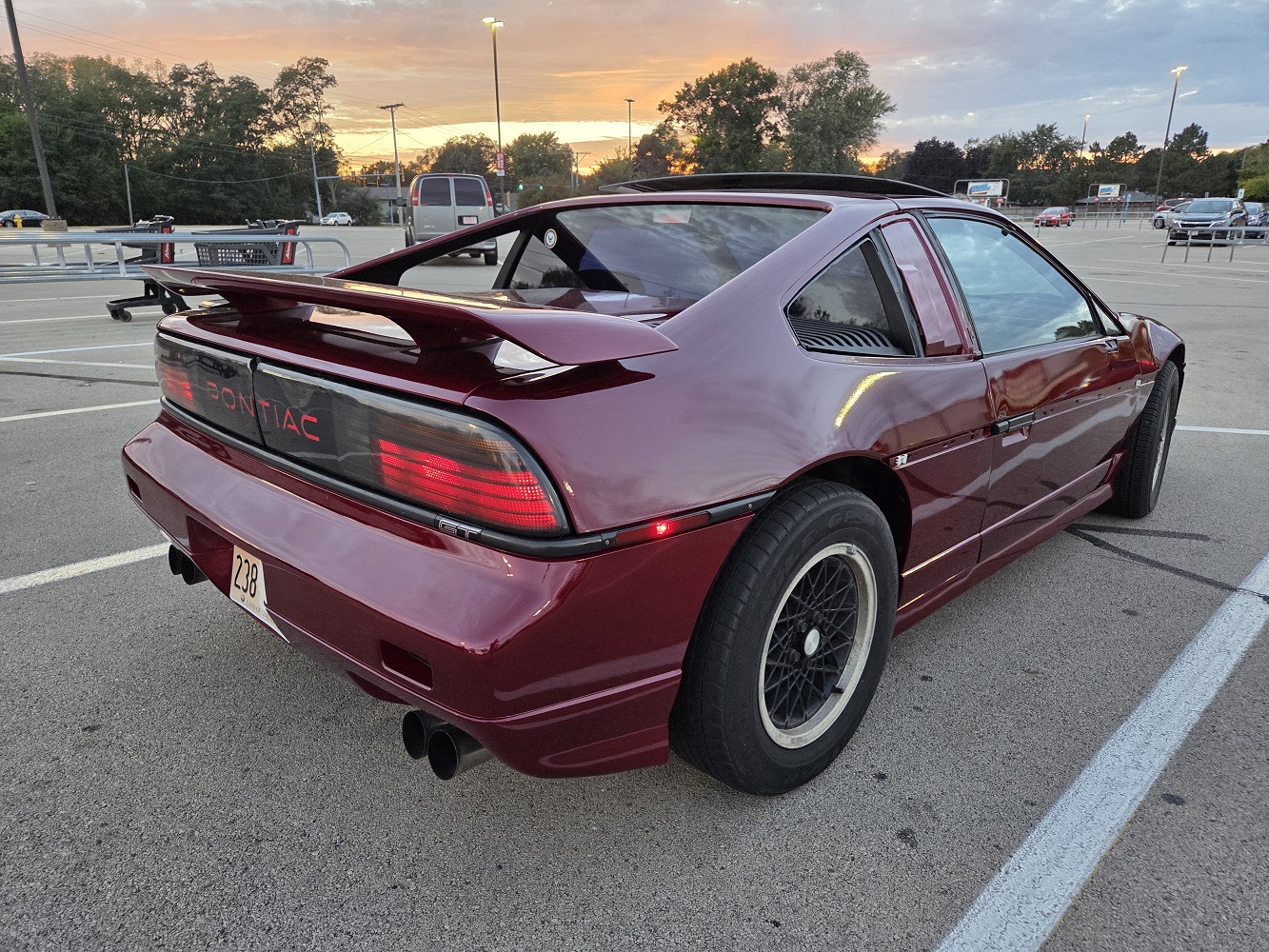

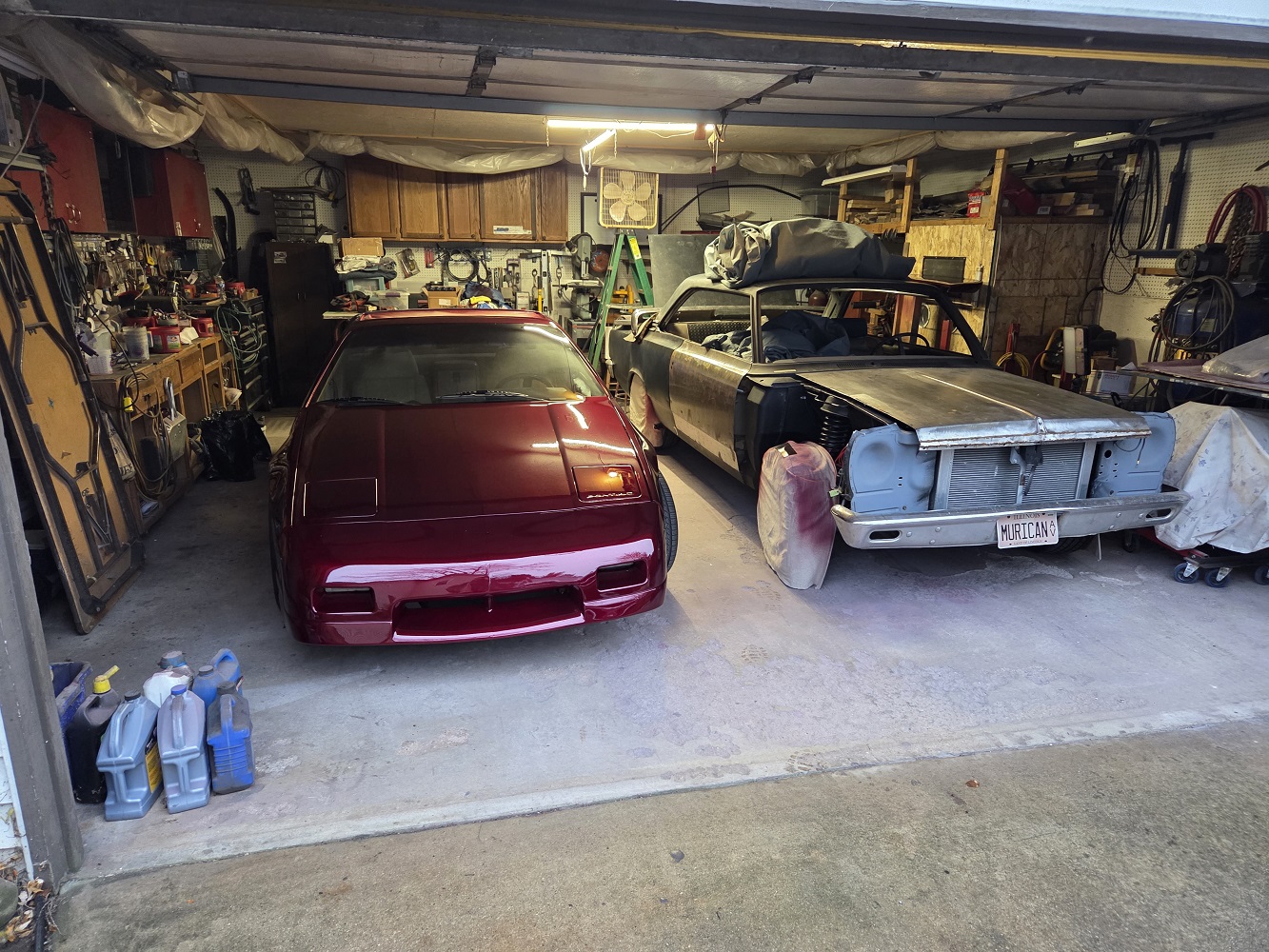

hercimer01 NOV 27, 10:54 PM

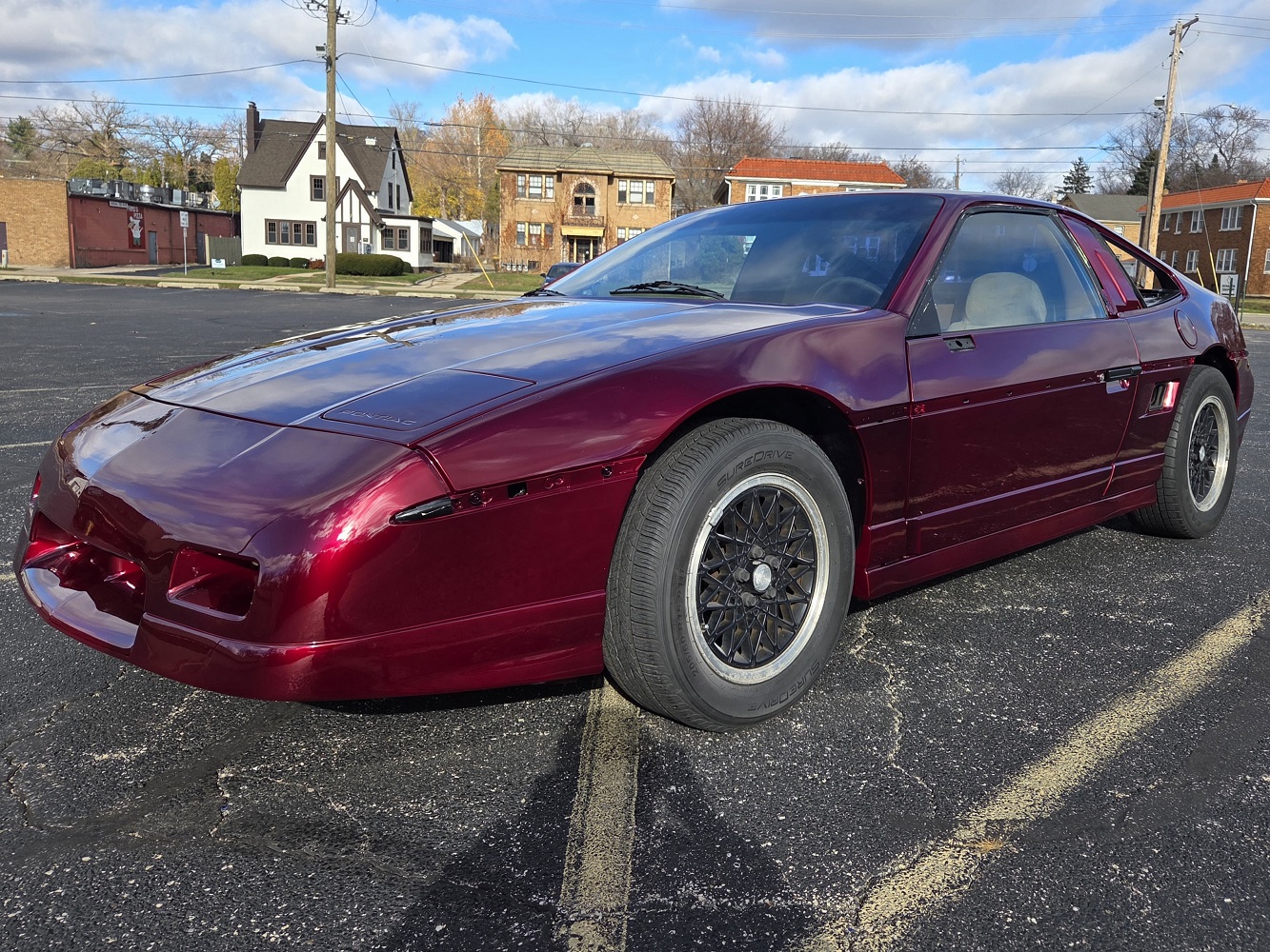

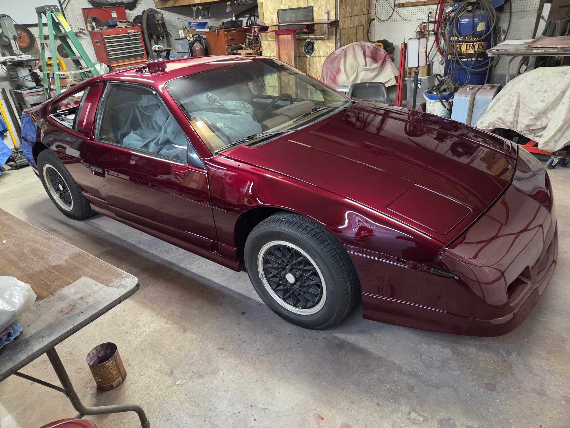

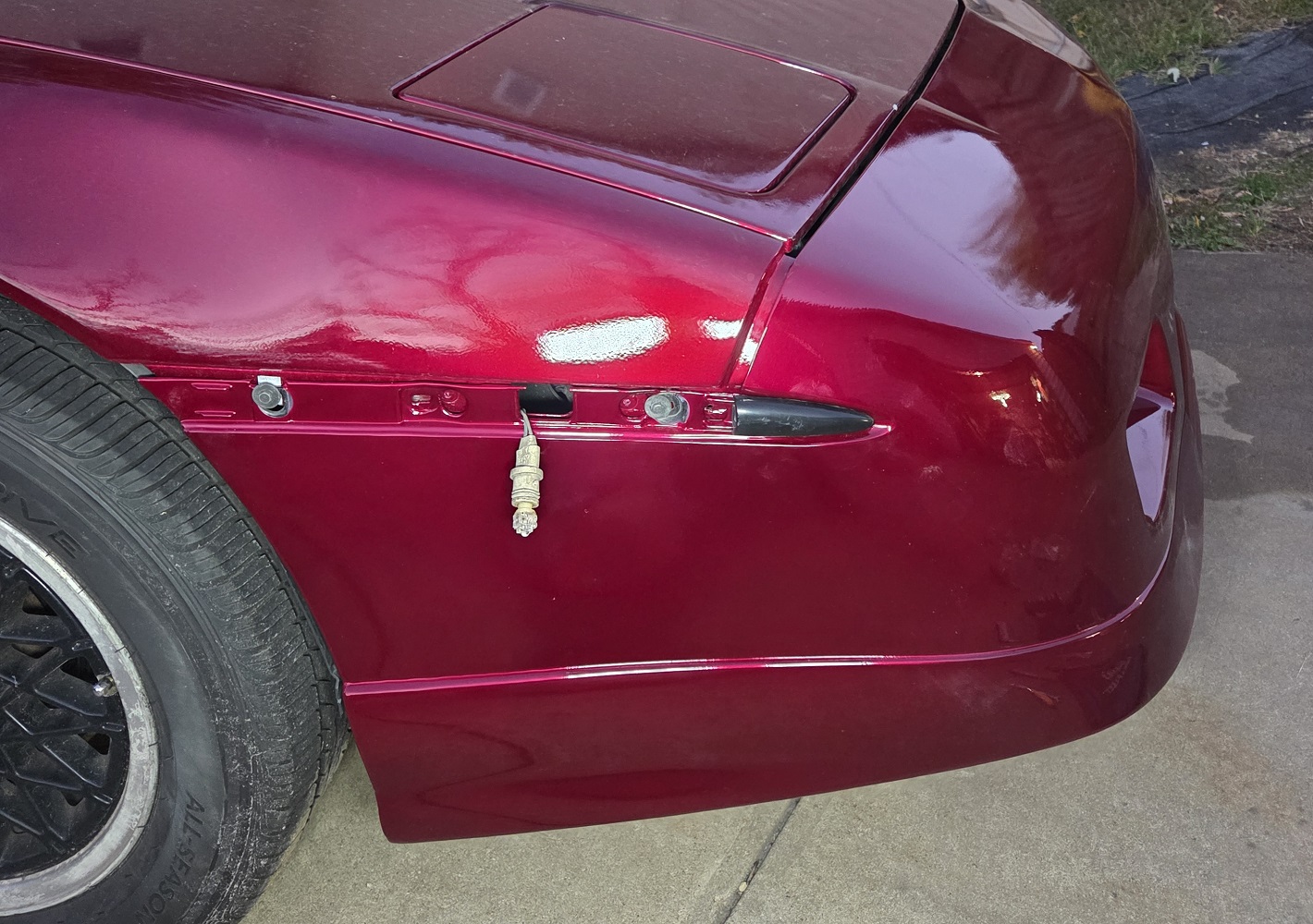

It was sunny today. I took it out to verify the color coverage. Looks good, It is a bit hard to tell in the pics though.
Every ones back in the barn for the winter.
