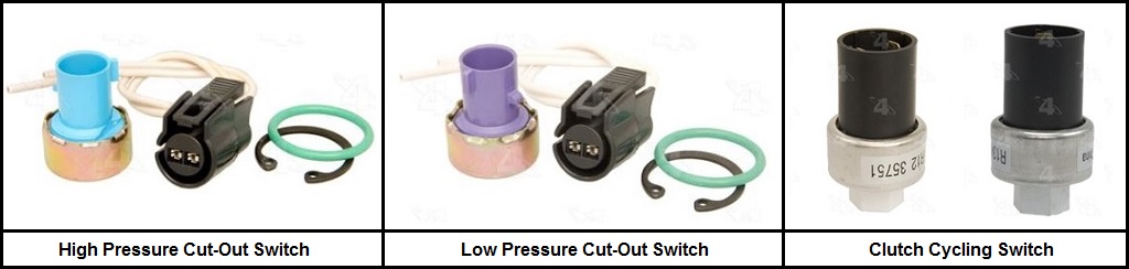

On eBay: A/C High Side Pressure Switch Global PN 1711328 (fits Fiero)

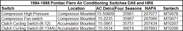

I made another Air Conditioning parts post a while back with more switch information, pictures, and part number cross references
http://www.fiero.nl/forum/Forum2/HTML/000652.html
The black piece on the clutch cycling switch is removable, it protects the terminals in shipping.
