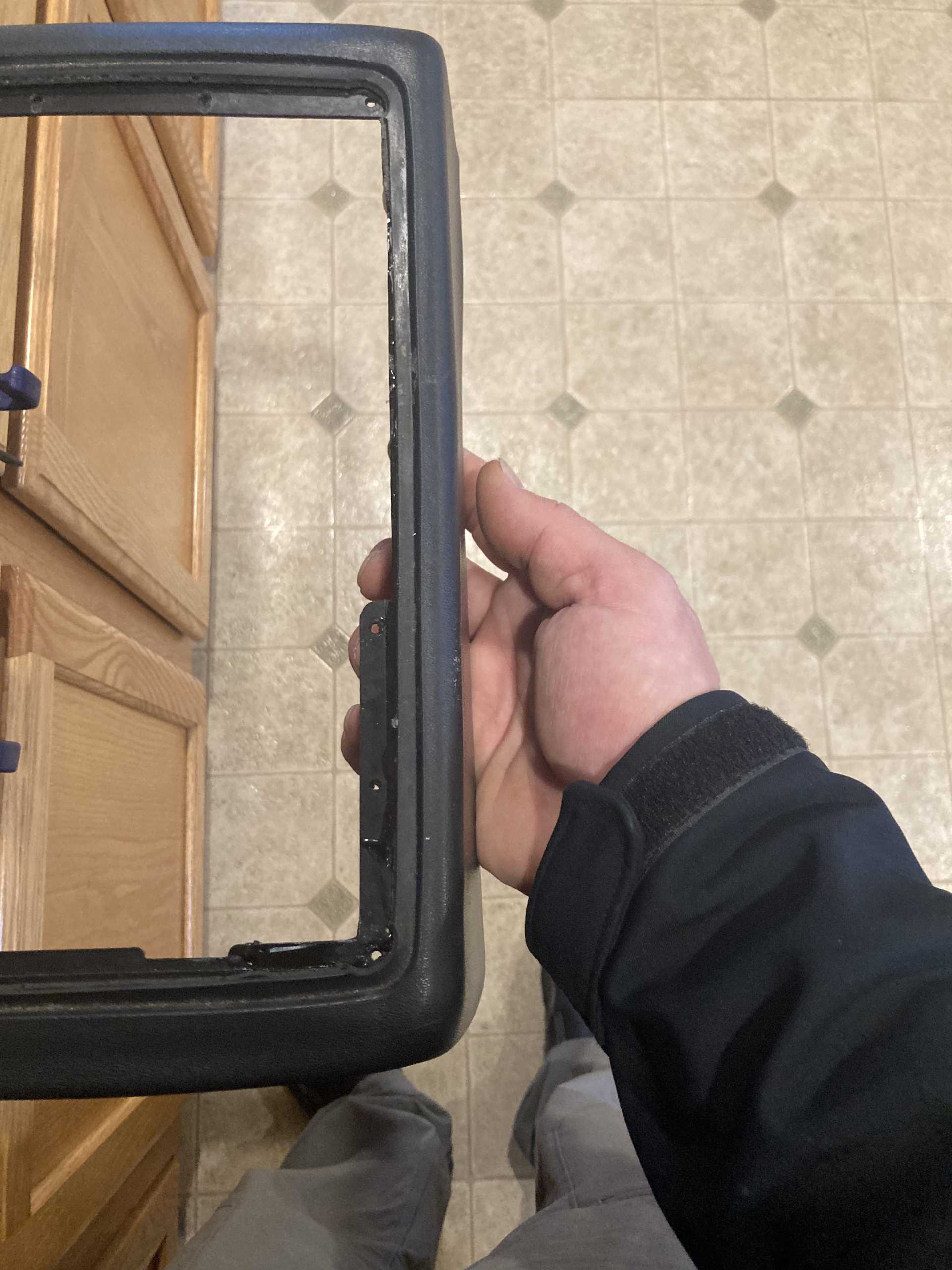

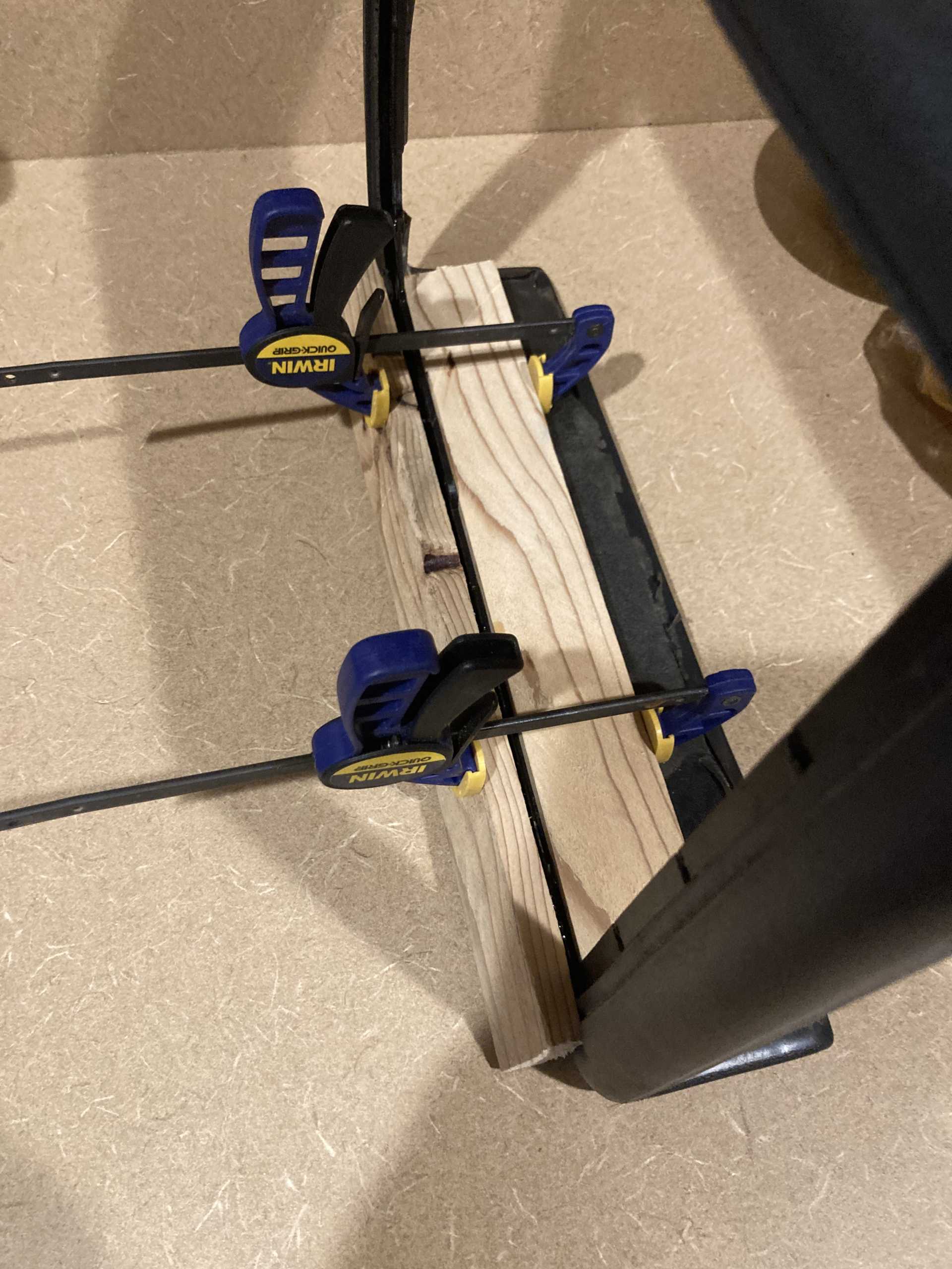

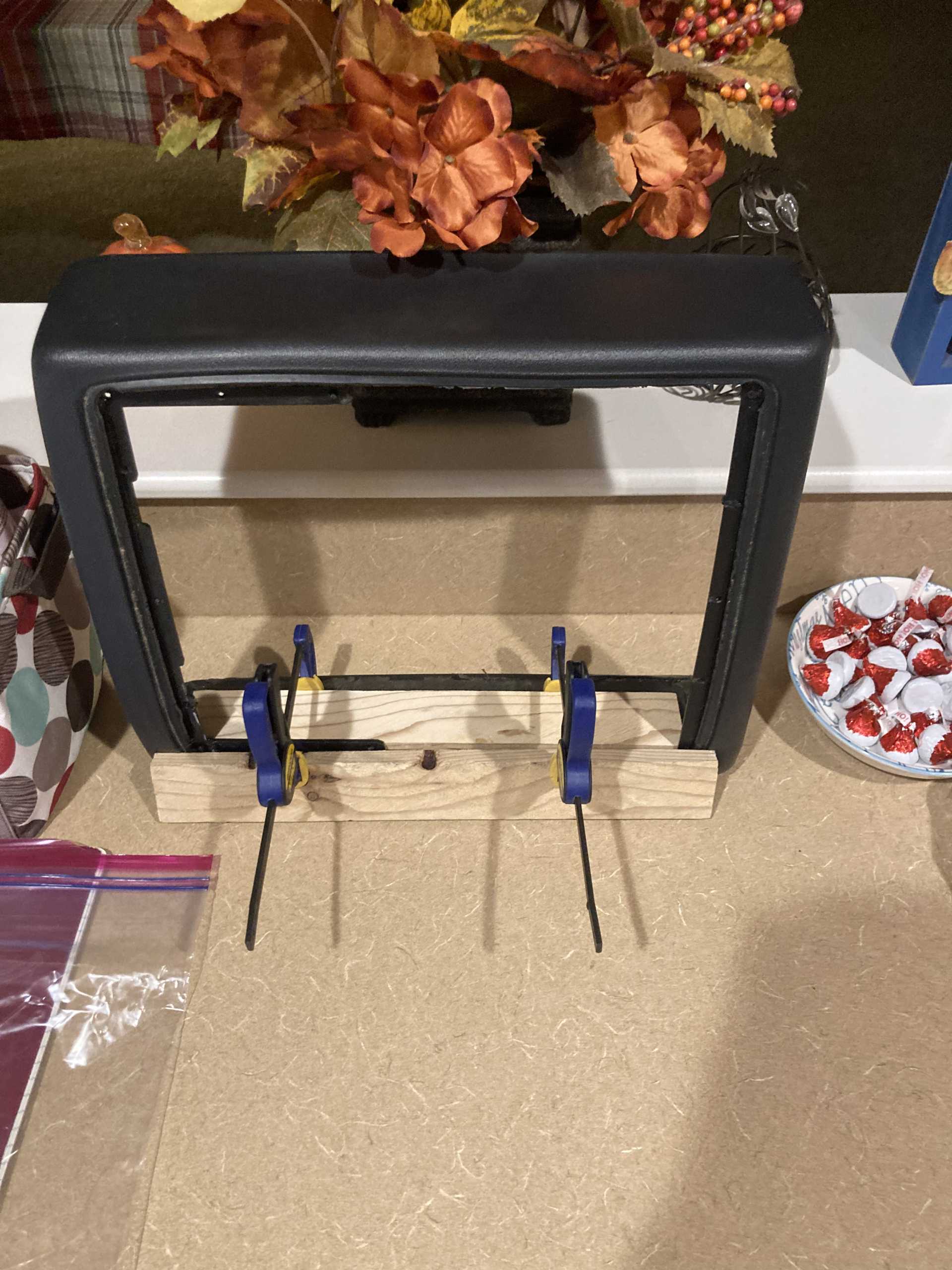

  Fixed list: - Interior Lights (dash, overhead, radio) INOP - replaced a blown fuse and rewired the 4th grade science project that was going on behind the fuse panel. - Power Mirrors Cigarette lighter INOP - fixed with wiring repair. - Sticky Door Locks - cleaned and lubed the mechanisms. - New wiper blades installed - Blown front Speakers - replaced with Cerwin Vega 4x10's -- pretty awesome for about $50!!! - Radiator electric fan INOP - hardwired and installed a switch. - Horn - is this a common problem? Yes the fuse is good. Plunger at the wheel was installed wrong. - Idles about 1800rpm until it warms up??? - May be normal, but new to the Fiero. Idles around 1000rpm in neutral once warm. Convinced this is normal after reading on the forums. - Rubber trim around the shifter / center console is popped out on passenger side, looks like multiple attempts have been made to fix it.  Gluing Complete. - Cruise Control INOP - Re soldered and wrapped the broken wires in the stalk. Tested Good!. - Engine Light, Code 13, O2 sensor. Advance Auto Parts had anew GM part in stock, installed and problem solved. - *EDIT* - New tires are here, need to be mounted and balanced - Riken Raptor (Michelin) 215/60R14.  Mounted / Balanced / Installed.  Highest Road force is now 9lbs after force balancing!!!  SIDE NOTE - I want to punch people who use fix=a=flat.  - *EDIT* - Temp Gauge - Works but reads low ~130 at full temp. I assumed the thermostat was hung open, but boiled it and it starts to open ~190. Seems right.  Ignoring for now, I'll know anything above that is a problem.I[This message has been edited by Brivander (edited 12-02-2021).]
