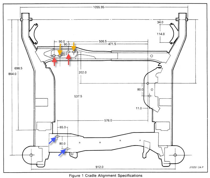

| quote | Originally posted by MulletproofMonk:
For the automatic your mounts should look like this picture, and you could have them in either the red arrow pair or orange arrow pair, then it could be to the far right or far left.
Yes sir, my mounts looks just like that. Ill look again but I only remember seeing 2 slotted holes for my rear mout but I will check it out again. Thank you for the pic. When you on you back and its dark and dirty im sure I could have missed it
MulletproofMonk
JUL 29, 08:35 AM
Well, you said the issue is on the front side, so it has to be the orange/red pairs. There is only one set of slotted holes in the rear of the cradle (I put blue arrows).
1) if you get under there with a flash light, you might see the old circles from the nuts being tighten against the cradle. 2) i think mine are in the red slots. i think when i put them in the orange slots it twisted it in like you are describing. 3) since those holes are slotted, you could have the rear slots pushed to the far left and the front slots pushed to the far left (or in the wrong set of slots), which would make it twist the motor mount too.
