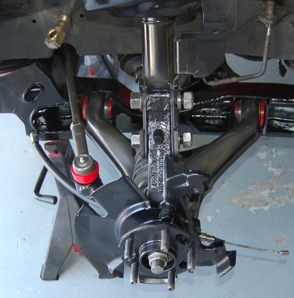

Resurrecting this old thread with some questions.
How does the installation hold up? Any wear on the poly? I'm also replacing all my ball joints and tie rod ends with Rodney's. Is it wiser to just leave them as the came or to put those poly boots over the rubber ones too? Will the poly rub on the rubber boot?

| quote | Originally posted by cebix: How does the installation hold up? Any wear on the poly? I'm also replacing all my ball joints and tie rod ends with Rodney's. Is it wiser to just leave them as the came or to put those poly boots over the rubber ones too? Will the poly rub on the rubber boot? |
The poly has held up well for me, 2 years on the car. I didn't really corner hard in the car though. My buddy Matt corners hard in the LeMon/ChumpCar and it needed replaced within a year I think.
Use the rubber boots that came with the ball joints, they seal better. You can put the poly over top if you want, but it might compress the boot...------------------ -Brian

I'm doing it on a daily driver. Did the whole front today, going to do the rear in a few days. Drives pretty hard after installing the poly bushings but it's good! Very, very tight. Only used the rubber caps, threw away all the poly ones.
