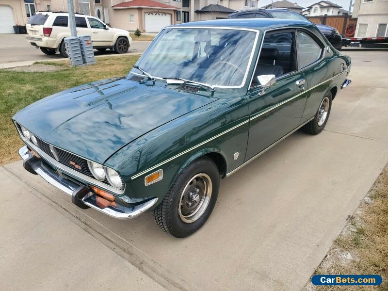

In the mid 1970s I had a dark green Mazda RX2 coupe 4 speed. I thought it was a phenomenal performer.
This is why I'd like to have a rotary powered Fiero:

Cool idea- If you need a motor, there is a shop close to me in Newmarket that has one of these old mazdas and the engine is in running condition
