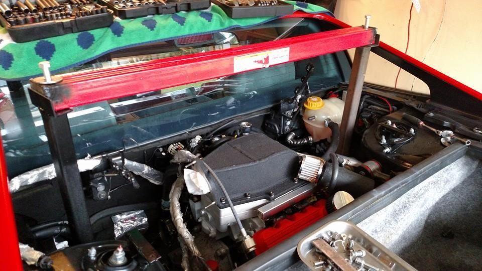

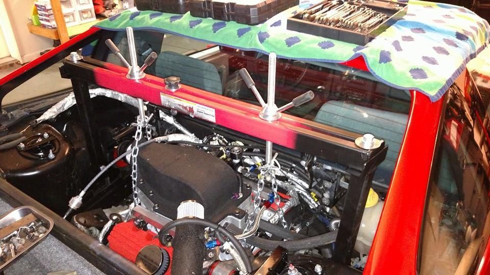

Originally posted by Justinbart:
I put the car on 4 jack stands. Lower the cradle, about 6" on the pass side and rest the cradle on blocks. Remove trans mounts. Put jack under engine. Tip cradle down on drivers side and the trans will pop right off.
[This message has been edited by rcp builders (edited 04-11-2015).]

BV MotorSports APR 11, 12:00 PM
Even on an 88 with solid mounted cradle? I was just going to support the engine and swing the cradle down on the front 2 bolts.

Justinbart APR 11, 07:03 PM
I don't swing it down it makes everything too awkward.

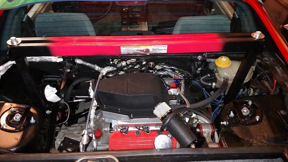

BV MotorSports APR 15, 08:40 PM
Engine brace nearly finished. I just have to add simple cross braces to each strut tower.
[This message has been edited by BV MotorSports (edited 04-15-2015).]
