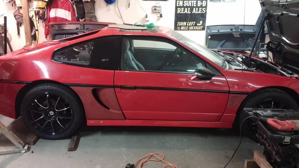

Almost there, should start tonight.
BV MotorSports
OCT 04, 08:20 AM
Update:
Will not crank. Stater was seized. Replaced with new unit. Cranks better than ever. FIXED
Crank, no start. No 12v signal at coil packs. Replaced CPS. FIXED
Crank, no start. Spark plugs soaked. Spoke with DH and he told me how to rescale the tune for 60# injectors w/ pictures! lol AWESOME.
Just need to burp the coolant, nut & bolt check and clean her up. I plan on driving it around for 2 weeks then trailer it to MASE to get it dyno tuned. Vids to come!

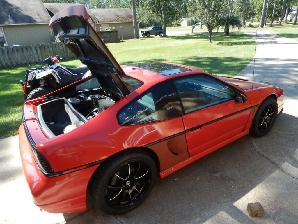

Needs tuned... its a mess.
Justinbart
OCT 04, 08:21 PM
darkhorizon
OCT 06, 10:05 AM
| quote | Originally posted by BV MotorSports:
Needs tuned... its a mess. |
There is currently no maf sensor connected. So technically it needs a maf and not a "tune"
It was tuned well when it was parked and the changes the new injectors made are very simple to do in one flash. Dyno tuning would be a waste of money without a doubt.[This message has been edited by darkhorizon (edited 10-06-2014).]
