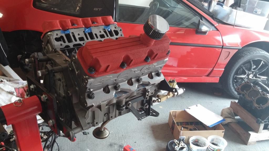

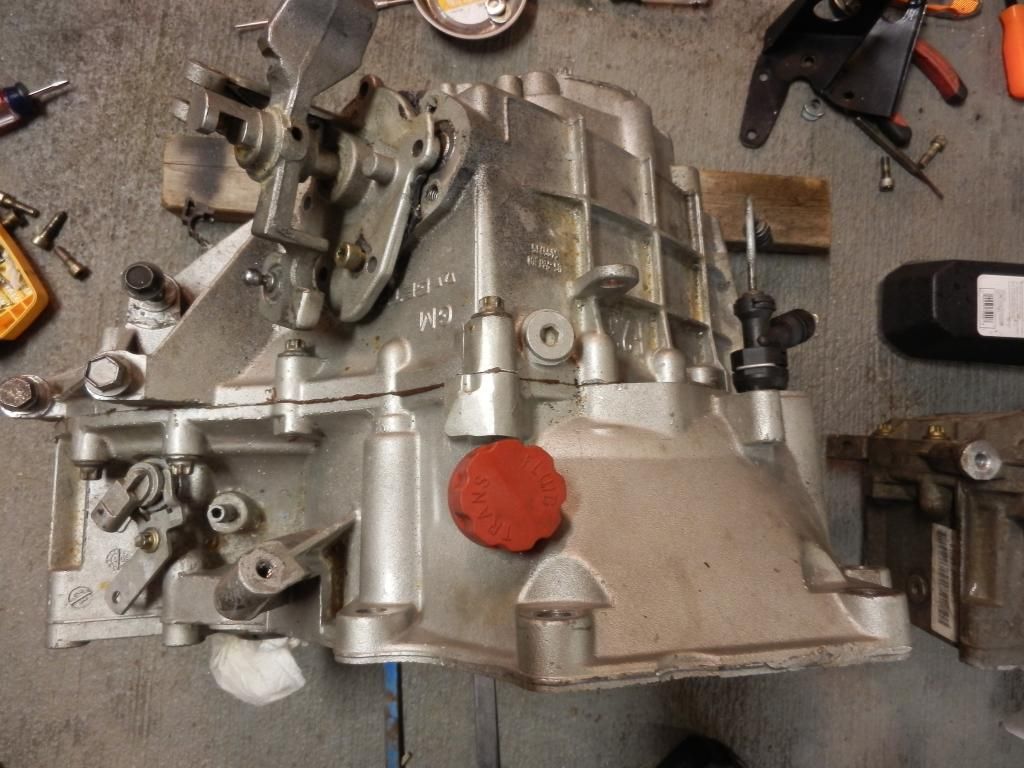

Plugging along. Making good progress. I should be able to pick up my heads today. Turns out one of the guides was a bit egg shaped. Its also the same valve where the new LS6 spring broke. I also had the guides machined for the lower height seals. All is well....
HOWEVER!! You knew this was coming.

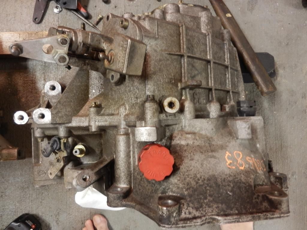

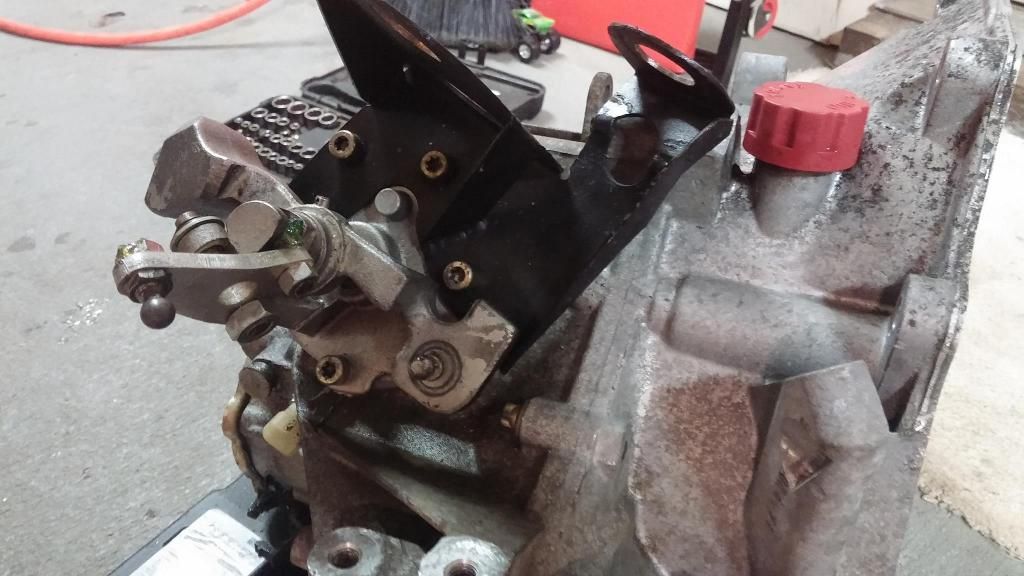

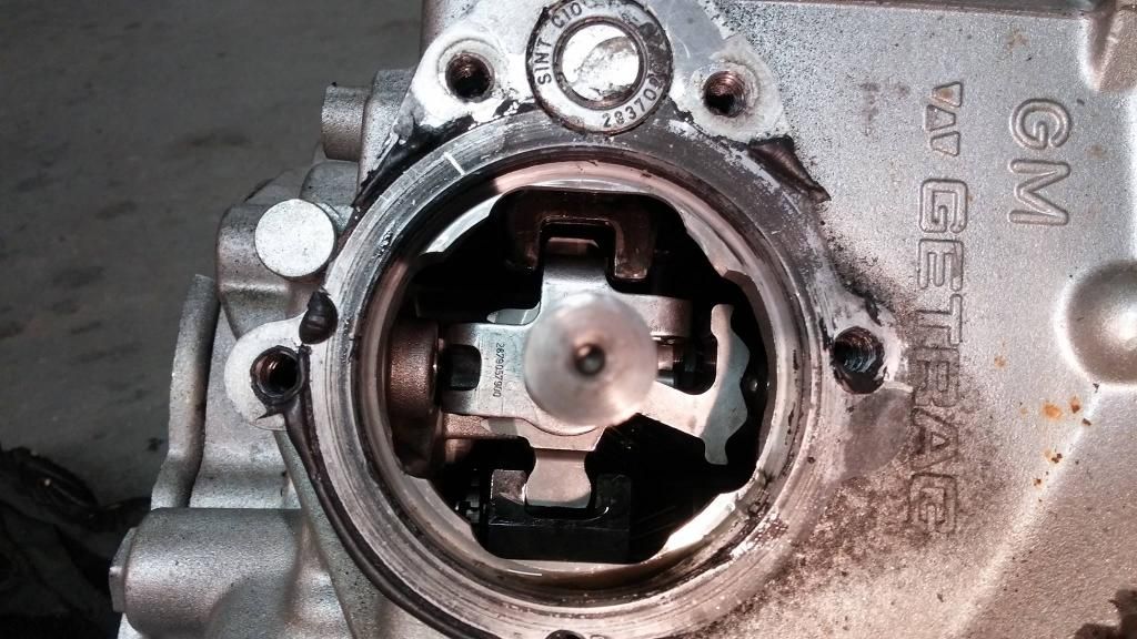

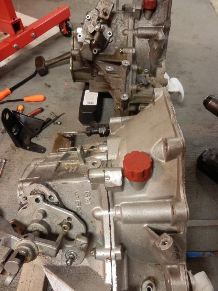

WTF moment. My F23 has the shifter rod clocked 45 degress. Somehow ol' smoke and mirrors clocked it. Luckily I noticed this as I was transferring everything over to my replacement F23 (damaged due to improper FW thickness). So either I need to find the correct shifter brackets for an f23 swap or figure out how to rotate this and use what I have. Personally, I would rather go the correct route.
Have a look:
"new"
old
both
johnyrottin
SEP 26, 12:29 PM
Good to hear you are still working the issues Steve. keep with it. Your workmanship is far superior to he who shall not be named.
Justinbart
SEP 26, 06:52 PM
Probably just drilled a new hole for the roll pin to go in. ------------------ Turbo 3800 E85 F23 5spd spec5 10.91@133.1

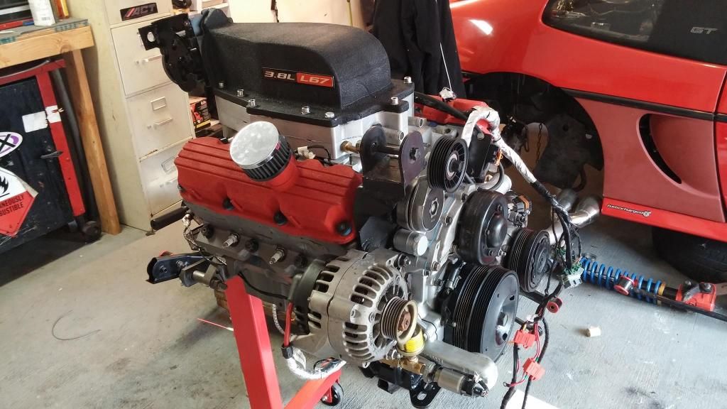

BV MotorSports
SEP 26, 10:14 PM
Sorted!

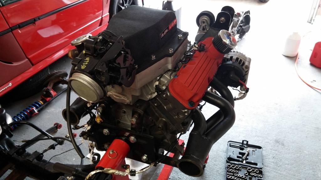

BV MotorSports
SEP 27, 02:10 PM

BV MotorSports
SEP 28, 03:12 PM
BV MotorSports
OCT 01, 01:09 PM

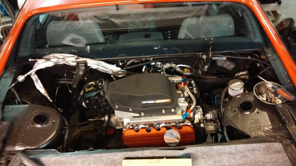

In the car and the 1st job was to bleed the clutch. No leaky HTOB. Time to get busy.
Oh yeah.. notice the orientation of the bolt for the dog bone... LOL[This message has been edited by BV MotorSports (edited 10-01-2014).]
