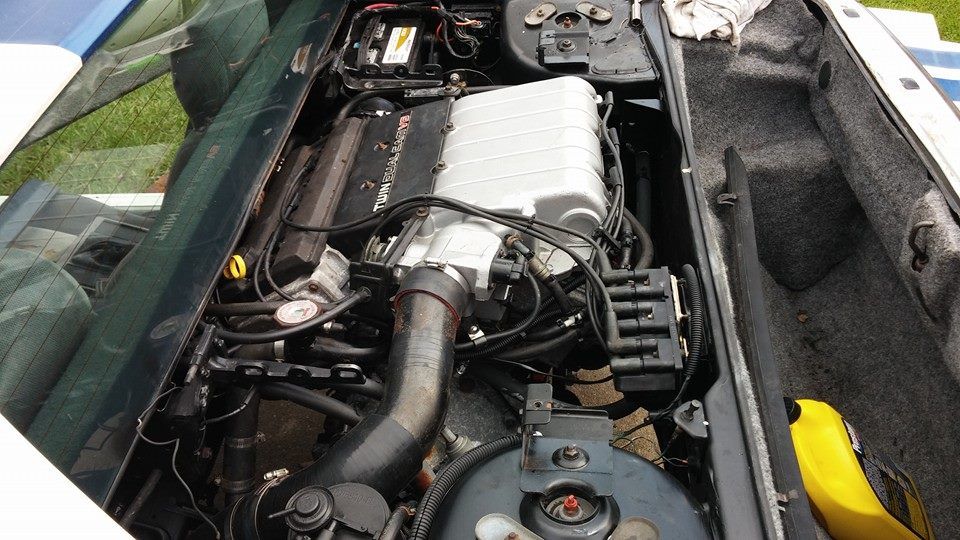

Engine is on the engine stand, car is in a million pieces. I have a new trans ordered that Scott (DH) located for me. Found a broken valve spring. Odd, since they are brand new LS7 springs. Making some new fuel lines right now. I never liked the old ones.

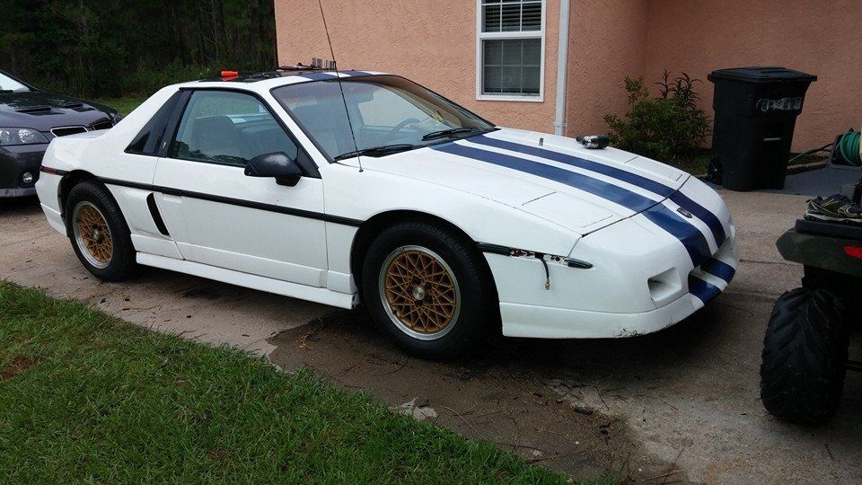

I am almost done putting Garths LQ1 swapped Fiero. Its got to go to the exhaust shop, alignment shop and I have to install some fuel lines. I'll be hauling it to Virginia on the 9th of July. When I get back, I'll get back to work on my 88. AFTER, I clean and organize my nasty garage.  ------------------ 2009 G8 GT Kook's 1 3/4 LT's, Kooks catted Xpipe, Magnaflow axleback, Vararam CAI, HSRK, HPTuners, Atari gauges

Garths LQ1 1985 GT
