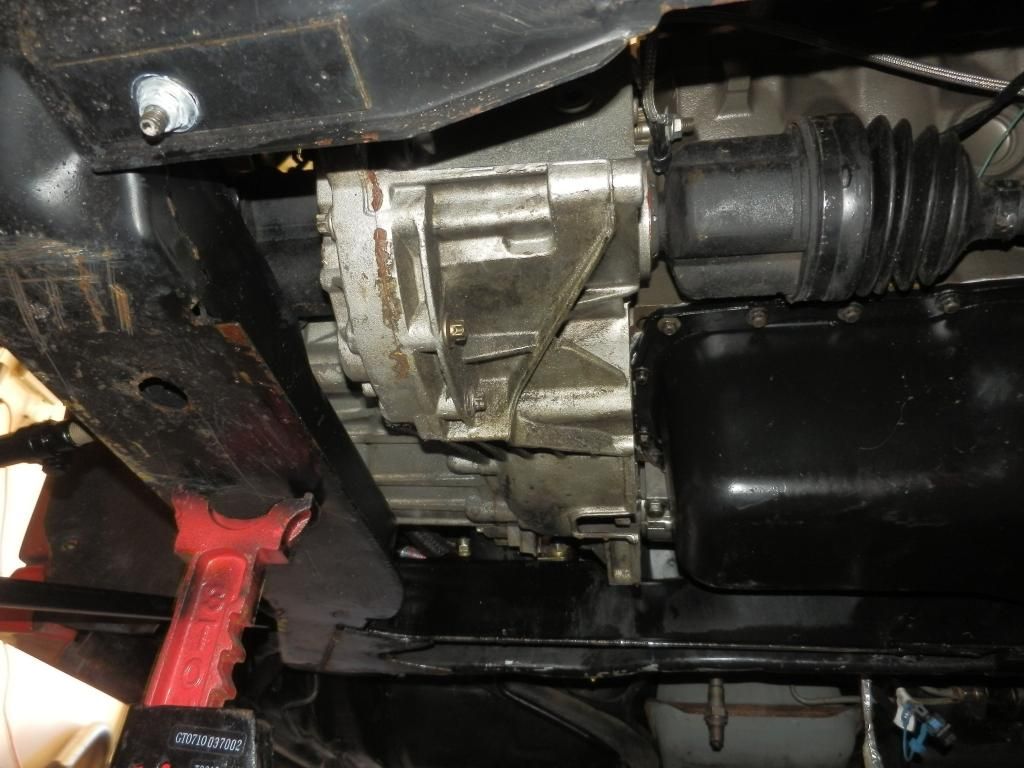

Got it 99% back together. Just adding fluids and bleeding the clutch. Hmmm clutch isnt feeling "right". I look under the car and there is brake fluid leaking out of the bellhousing. Yep, HTOB is leaking. WTF? This car is cursed.

Yes, its coming out of the square notch at the bottom of the trans by the flywheel. :/ I am going to try to check the HTOB tomorrow before I start to rip it apart.

Drip drip...
