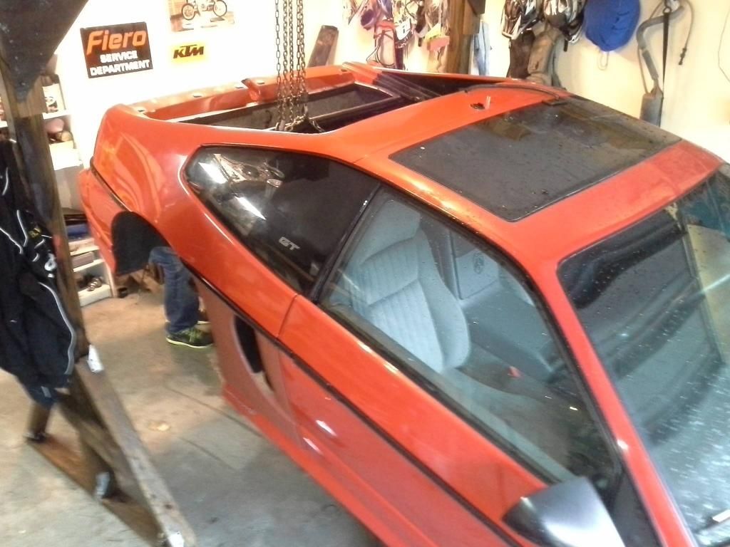

BV MotorSports DEC 22, 11:13 PM
Just a quick update, I started pulling the 88 apart. I am also going to powdercoat a bunch of stuff and ceramic coat my headers, ypipe and downpipe.
p.s. *fingers crossed* its just a clutch issue. I could use some good luck!

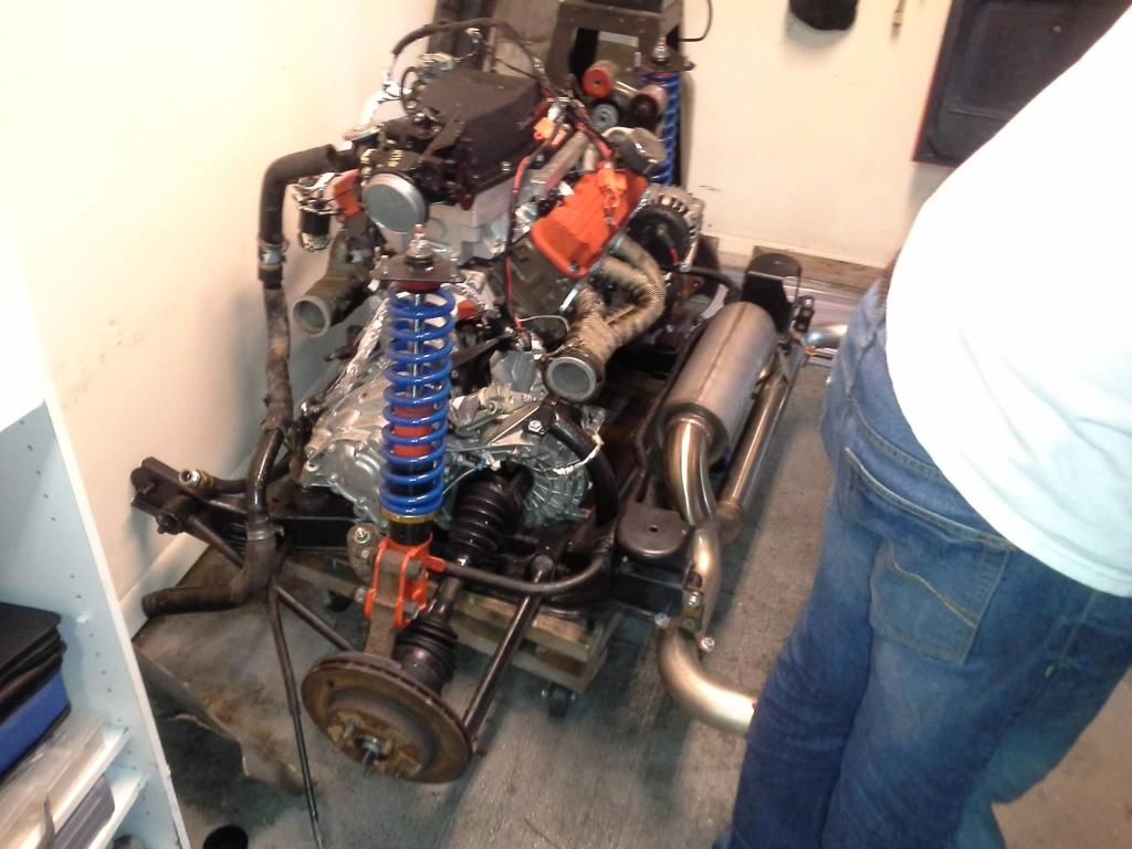

BV MotorSports DEC 23, 03:15 PM
Classic good news, bad news situation with the turbo '88. Good news, my engine is not damaged. Bad news is, every single flywheel bolt backed out and egg-shaped the bolt holes. So I need an entire clutch kit. Not cheap for a L67/F23 swap Fiero. Moral if the story, GM cam bolts (ARP) are a big fail in my opinion. Use GM fw bolts.
I need to know the EXACT clutch kit and FW bolts needed for this swap. I am going to call SPEC and get their 3+ for it.
All the suspension bits are getting powder coated and new poly bushings fitted. I am also going to brace the U shape trailing arm (idea from the classic 3rd gen f-body mod). Even at 14k miles, my bushings are shot.
[This message has been edited by BV MotorSports (edited 12-23-2013).]
BV MotorSports DEC 23, 04:28 PM
I went with 8 of these bolts:
http://autoplicity.com/prod...6_18_1_000_bolt.aspx
