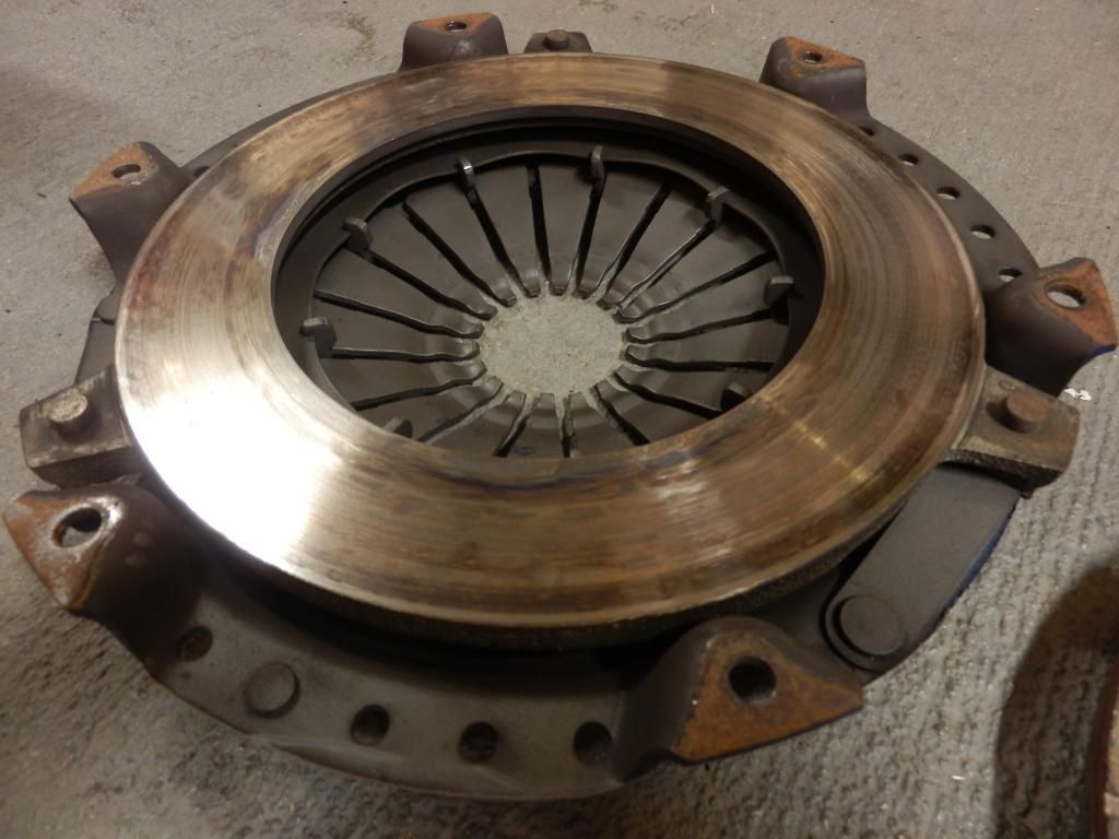

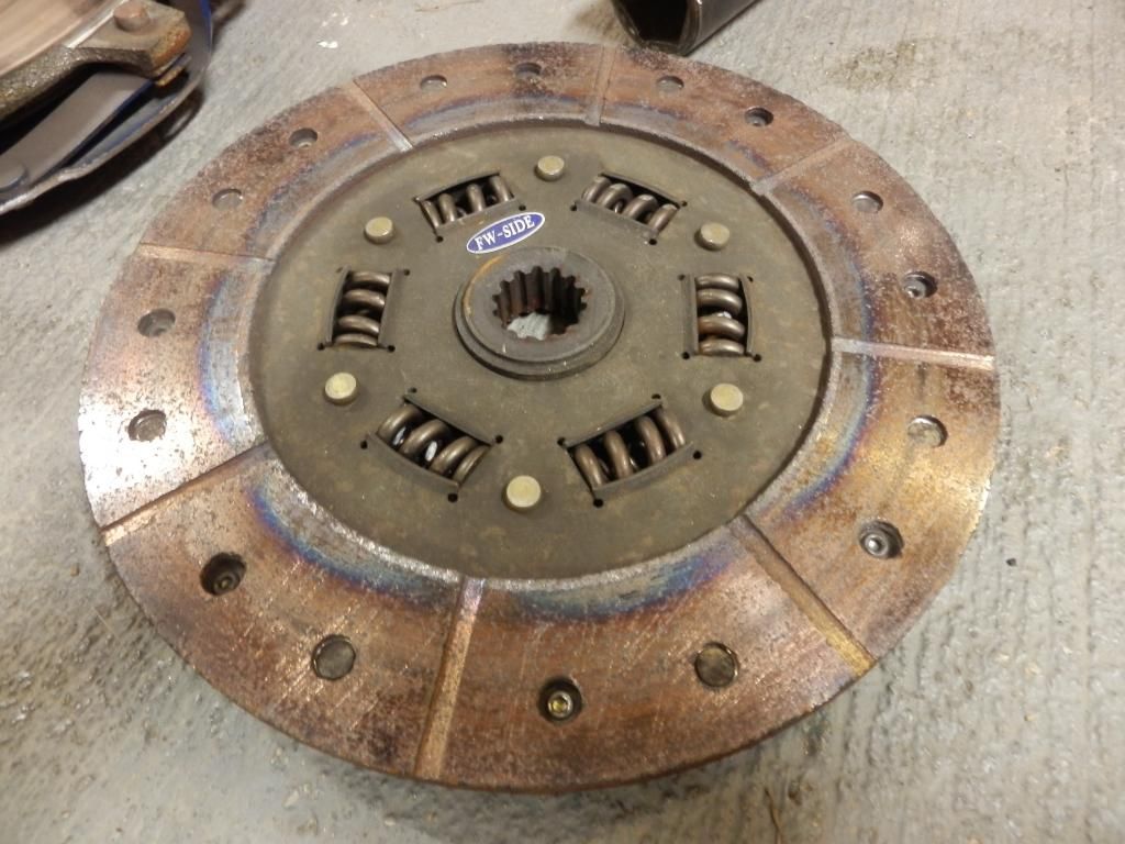

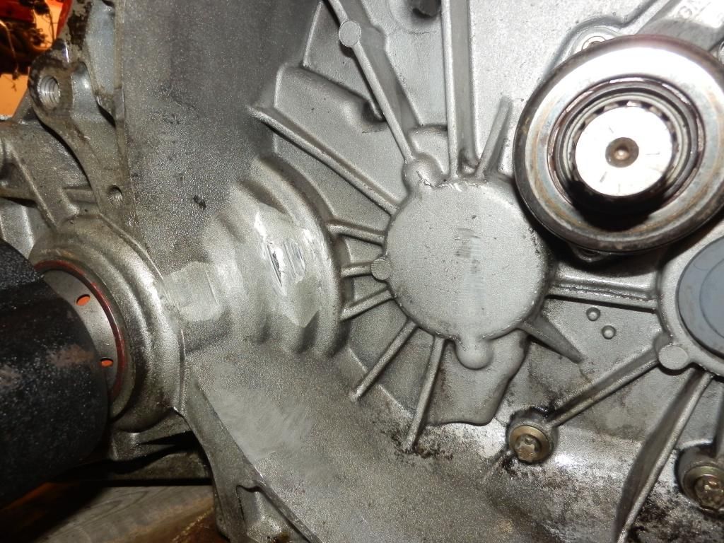

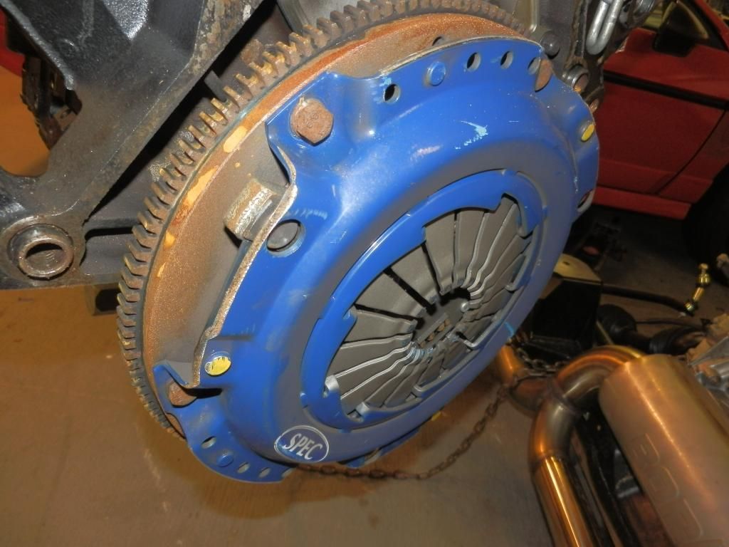

BV MotorSports AUG 24, 02:38 PM
Yeehaw, screwed again!
This is not a spec 3+ and it is NOT the correct fitment for the F23. Notice the PP has been ground down and its still hitting the inside of the bellhousing.
[This message has been edited by BV MotorSports (edited 08-24-2013).]

fieroguru AUG 24, 03:04 PM
That is indeed a Spec Stage 3+. The Spec Stage 3 is a 4 or 6 puck style, the Stage 3+ is the solid face material. The Stage 4 is a Stage 3 with no springs, the Stage 4+ is a Stage 3+ w/o springs.
But, yeah that pressure plate should not have been used.
