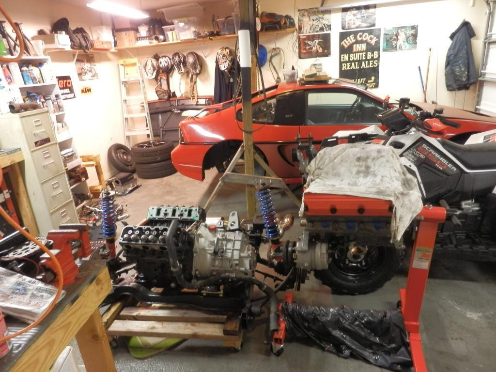

Engine is out. I am about 1/2 way with swapping everything over to the new motor. I swapped in my ST2 cam (has 3311s engraved on the end) and got the valvetrain in place.

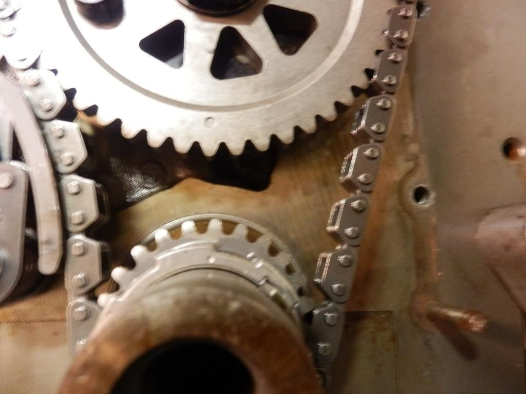

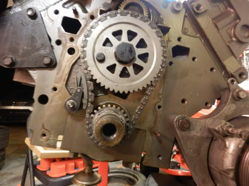

Here is a good question. Balance shaft to cam is dot to dot. That is the easy one. Eyeballing the cam to crank dots is a different story. I set the engine to TDC before I started the break down. I am 90% sure I have the cam to crank dots pretty close. its just hard to eyeball it since they are pretty far from each other. Only thing I can thin kto do is try a plumb bob or something. Suggestions?
Hey Scott you'll love this. The oil bypass spring was very sticky in the bore. I had to pull it out with pliers (old engine).
