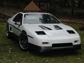

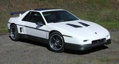

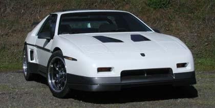

Well.... everything that I have for the IMSA is now reassembled. Only things left are to get the eyelids and fuel filler door painted and installed, and when the windows get back from the tint shop they go in along with the inner door panels. At some point after it gets the "cut and buff" I may have some minor pin striping done, and of course no car of mine is ever truely "finished", but it's getting pretty darn close to "compleat"
It was a nice day today so I took a few pics and thought I'd share:
[This message has been edited by Russ544 (edited 07-09-2009).]

Very nice! I like the color combo. The dark trim and wing look good like that. Have you thought about painting the roof the darker color, also?

wow that looks sweet - need more pics!!!

Love it Russ great job,..about the only thing i might have changed was the color of the wing stands to the darker shade.
The eyelids are going to be white ?

No I haven't concidered a dark top
Eyelids will be white
I did think about painting the wing stands charcoal, but decided that it might make the wing look "stuck on" instead of being a part of the car.
Actually I thought about putting a dual stripe the length of the car, over the roof etc, but the dark vents and wing fit better with my desire for an "understated" clean look.
Russ

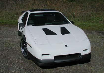

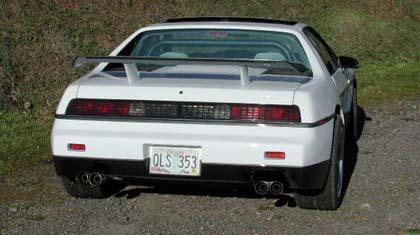

OK.... here ya go. I guess I'd better stay with turning wrenches and not start a new career in photography LOL . I took 30 or 40 photos today and these are the best I could weed out of those. I did a little minor ps and crop on some of these, so if you want the original 640x480 let me know & I'll send the ones you want your way. A lady friend of mine has a really good eye for digital photography, so perhaps one of these days I'll get her to shoot a few for me also.
The white body color tends to reduce the visual effect of the body flare in photos, so I really tried to get an angle that shows the "bowtie" shape best. The second shot below does pretty well at showing that, but non of these really do justice to the full amount of flare. for a better idea of just how much wider it is now, go back to page one or two where I had the narrow stock wheels/tires on the car LOL.
I still need to get the car aligned, but I've driven it quite a bit in the past week or so, and done a lot of fine tuning on the carb jetting and timing. It will never beat my sbc car in a drag race, but I'll tell ya what ........ it's a surprisingly quick little ride, and a ton more well manered than the sbc (425HP tends to be a bit volatile on the street).
With special thanks to Tedd and to Aaron, It's been a really enjoyable project !!

Looks incredible. The white on black contrast is an eyecatcher. It just seems that the wing may look a little narrow compared to the widened rear end. I think you need a massive IMSA wrap around spoiler

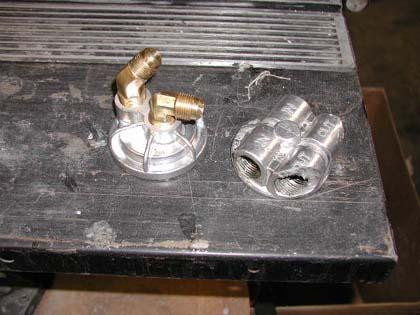

The other part of my "to do" list was dedicated to fixing an oil leak at the remote oil filter adaptor. When I put this motor together, none of the places I looked could come up with the correct 18 x 1.5MM adaptor so I ended up modifying (the one on the right in the photo below) a side outlet unit to go on the 4.3 . The problem with using this unit was that the 4.3 filter pad is recessed into the block slightly, so I had to grind off some material from both the adaptor and block to be able to screw the adaptor on. by the time that much material was removed, not enough threads remain at the hose connections to effect a reliable seal. It wasn't as severely cut up as it is now however, as when I originally installed it the oil pan wasn't on the engine, and I sure didn't want to remove the pan now, wile in the car, so I just hacked pieces off the adaptor until it would go full circle to come off. In the meantime I found a guy at an auto parts store that had a brain, and he came up with a correct adaptor for me. as pictured on the left below it's a Mr. Gasket # 7678. I ended up using different fittings from those shown, as I'm using the Toyota starter with my setup and clearance is really at a premium. It really tore my guts out to do it, but I had to use the Archie method of tapping off the side of the block for one oil line and using a 90* fitting on the adaptor in the other side. It's back together now and not leaking, so now it's time to start on the balljoints. .......oh yippie........

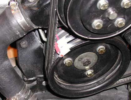

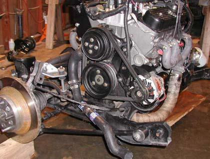

UPDATE:
Well I decided to just yank out the engine and do the job right. I had several small items that I wanted to alter on the engine anyway, and it's just easier, and makes for a better end product, to pull it out where you can get at things.
It's amazing how grungy the engine can get in only a few months. of course much of this was due to wetsanding on the bodywork.

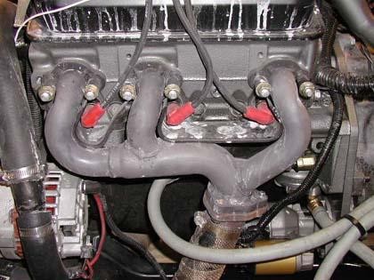

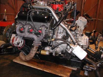

3 of the items I wanted to change were all kind of "plumbing" related. the first was the oil filter, which now mounts at an angle so less oil will end up in my face and on the cradle when changing filters. I also had shorter hoses made up so they could be routed further away from the exaust. The second item on my list was to remove the tin heat schields from the headers that surround the plugs. changing plugs was a real pain because you couldn't access them from under the car very well. The third item was to flip the water pump "right side up" again. I opened up the steam holes again and came up with some new hoses to re-route the inlet side around the balancer.
tomorrow I'll clean things up, take a few pics, and stuff everything back in the car again.
It sure is cool being able to pull a Fieros engine so easily. 2 hours and it's all sitting on the floor ! If this was my Vette it would take one full weekend just to pull the engine, one more to work on it, and a third to put it back in again. and I doubt that I'd be in a very sociable mood after any one of those weekends
more pics tomorrow
Russ

Although the motor is back in the car now and has the four cradle bolts installed, I found a couple more things today that needed attention before the motor went back in, and that held me up enough that the rest of the installation will have to wait till tomorrow. I figured now was a good time to install the rear sway bar that I got from PaulV a few months ago, and that required some sandblasting and paint work before it went in. Then after flipping the water pump right side up again, the timing mark, which had been just barely visible before, was totally hidden by the pump inlet. I was able to sneak a new pointer in behind the belt, and hopefully there will be a "hole" where it will be visible when in the car. A big patch of white now covers the area from TDC to 10* , so as long as I can get a glimpse of that area I should be able to set the timing when necessary.
The filter adaptor and it's hoses look a lot tidier now, and the hoses are far enough away from the exhaust that I won't worry so much about it becoming another Fiero fire statistic. It should be a lot more pleasant to change the filter now as well, without having a 1/2 quart of hot oil running up my shirt sleeve and all over the cradle from the horizontally mounted filter. (note drip quide under the filter gasket area also).
As I calculated, the radiator hose has a clear path, once the necessary hose bends were figured out, to snake around the balancer, and various suspension, on it's way to it's source for cool water.

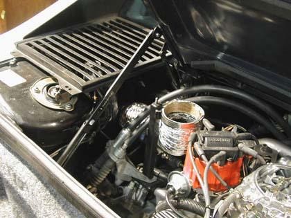

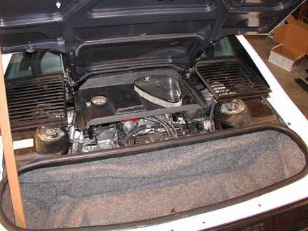

Back in... running great.... and looking good . It's always nice to get things put back together again. even though it's been raining all weekend and I wouldn't take the car out in this kind of weather anyway, it's nice to know that I could now, if I wanted to LOL.
I was tireing of all the stick jokes when I would prop up my rear decklid to show people what's under the hood, so I modified a spare front decklid support to perform the task.
I'm afraid I didn't take any "in progress" photos of the modifications, but it was actually pretty simple, and developed in pretty much the same manner as most of my creations. I'll use my usual analogy of building a canoe from a tree trunk: "once you find a suitable tree, lay it on it's side and clamp securely. then cut everything off the tree that doesn't look like a canoe".
I still need to build some screens for the hood vents.... guess I'll do that next weekend.... then I need to...uhhhh ................................................ uh oh. I don't know what to do to it next... does that mean it's..... "finished"? It can't be, cause I don't have that word in my vocabulary.
I'll think of something.

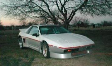

Originally posted by FieroMonkey:
welcome to the wide-body family.
Thanks ! yours looks nice as well. What's the history on yours? did you build it and if so how long ago? what kind of powertrain?
The "true" widebodys do seem to be a pretty scarce package. I'm sure there are more out there, but yours would only make 3 street IMSAs, besides mine, that I've seen.
