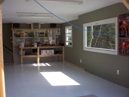

05-21-2004 10:26 PM Click Here to See the Profile for fiero67Click Here to Email fiero67Send a Private Message to fiero67Edit/Delete MessageReply w/QuoteDirect Link to This Post
Thanks Linenoise.....my garage used to be a rental trailer that my parents owned. After the last renters trashed it....we cut it in half with a sawzall and towed it to my house. I put another floor over the exsisting floor giving it 1 3/4 inches thick. I ripped out the old panel walls, insulation, and wiring. reinsulated and re wired the entire thing...then sheetrocked it. Did it all myself. I wanted a place to display all my Fiero stuff besides the living room
I had to make sure it had lots of outlets.....including the ones in the ceiling......and loads of light....that way i can work all night in it. Not to mention...the West Coast chopper posters on the wall.....lol

ClearDark

jscott1
Posts: 19513
From: Houston, TX , USA
Total ratings: 402
05-23-2004 01:05 PM Click Here to See the Profile for jscott1Send a Private Message to jscott1Edit/Delete MessageReply w/QuoteDirect Link to This Post
You get a "+" from me just for the garage.
That looks like a very pleasant place to work on your Fiero. Especially compared to mine Keep up the good work. I love body off restorations, especially on 88s.

fiero67
Posts: 2265
From: Maine
Registered: Jan 2003
Total ratings: 107
05-23-2004 08:13 PM Click Here to See the Profile for fiero67Click Here to Email fiero67Send a Private Message to fiero67Edit/Delete MessageReply w/QuoteDirect Link to This Post
Thanks Jscott1.....it is nice to work in the garage....especially when the only things that are really allowed in there are Fiero parts. The red and yellow containers on the wall are the ones you buy at Wal*Mart and have many clear slide out compartments. I put all my extra small Fiero parts in them from stripping down the other two Fieros. I had to make the garage livable just because I spend alot of time in there...and if I am ever in need of a dawghouse....lol

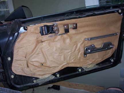

Heres the step by step process of removing mirrors from a Fiero.
1) (red arrows) pop the tabs off the arm rest and remove the three phillip head screws, remove arm rest.
2) (blue arrows) carefully pry off the fiero emblem on the door handle and also the round cap behind the door handle exposing the two philip screw. Remove them. pull the door handle bezel out towards you. Reach behind the bezel and pull the lock slide towards you. This should disconnect it so you can now slide it out of the bezel. With a little effort, you can now slide the bezel towards the front of the car and off the door handle.
to remove the door panel you should have a special tool designed to pop the plastic holders that hold it in place. There are 8 of them.
the plastic holders are the white things on this door frame. I did notice that there was one missing from mine on the top left hand corner.
Now that you have the door panel off, you can see the threw screws that hold on a rubber like cover on the opposing side of the mirror. remove them and you will see the two 10mm nuts that hold the mirror on.
To get better access to the nuts I marked the position of the inner dew wipe(not sure of the real name of this) plate before removing it. Its the metal strip that follows the top of the window. After you remove this metal plate... the dew wipe just lifts up and off.
Now with a 10mm socket on a 3/8" drive rachet..you can remove the mirror.
....then let yourself go crazy and start modding...or put it back on, your choice.

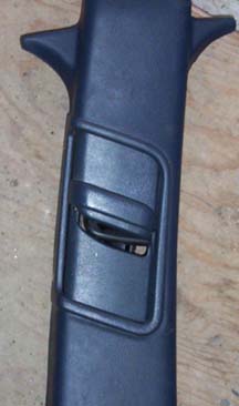

before I get going on posting more on the mirror mounts...
Ill throw in a picture on the next mod Im making to my interior...does anyone want to guess what it is?
It looks like you are adding an adjustible seat belt anchor. Cool! It's the attention to little details that separate the really nice Fieros from the hacked up looking ones. I think yours will be one of the really nice ones when you are done. It will be in the Skitime class...
fiero67
Posts: 2265
From: Maine
Total ratings: 107
09-18-2004 11:15 PM Click Here to See the Profile for fiero67Click Here to Email fiero67Send a Private Message to fiero67Edit/Delete MessageReply w/QuoteDirect Link to This Post
you are right, It is an adjustable seat belt anchor. Good eye. I will post a step by step on that as well.
