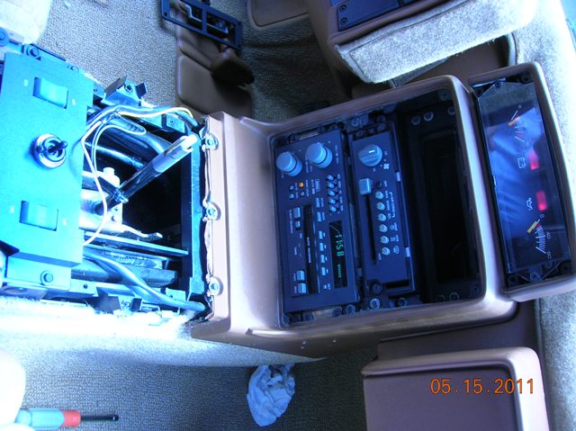

Here is a link to gluing the center console in my build thread. The same technique and glue used apply for the radio surround as well.
You can hit up harbor Freight for the clamps if you need to get some. Pick up some free paint sticks at your local Home Depot / Lowes. They will hold the piece level / flat when you clamp things till the glue dries.
johnyrottin
Posts: 5513
From: Northwest Florida
Registered: Oct 2007
Total ratings: 85
Report this Post10-14-2014 09:35 AM Click Here to See the Profile for johnyrottinSend a Private Message to johnyrottinEdit/Delete MessageReply w/QuoteDirect Link to This Post
Notice that in the picture there is a small piece of wood on the outside edge...VERY IMPORTANT! I didn't use that on one that I did and I ended up having to get another. The clamps left dents all the way up the side that never came out...even in the sun.

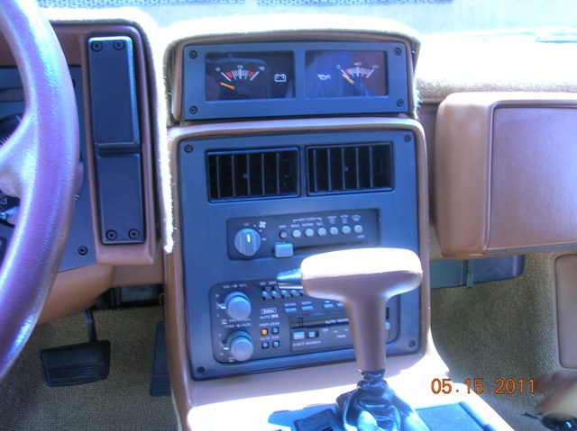

Here is another simple project to do while you have the console completely apart. I hate seeing the rusty metal through the little center vents. I also disliked barely being able to see which gear I was in. This link will take you to how to recondition the orange gear indicator for your automatic, recondition those ashtray doors, and how to clean that rusty metal up behind those vents. Looks fantastic.
https://www.fiero.nl/forum/A...130314-1-084600.html

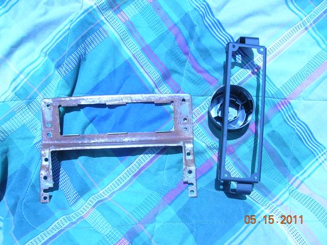

Clean and and refresh the brackets:
Reassembly:
And the finished product:
While I was at it I also installed a left ashtray door to replace the duel rights that were in there so they were correct. I also cleaned up and painted the ashtrays so that they were fresh. I hate rust! The ashtray doors were reconditioned as well. Lastly, I cleaned and repainted the shift indicator with a bright new flourescant so you can clearly see which gear you have selected. I found that at some point the center console had been apart (two right hand doors and the indicator not on the stalk) This is the thread I did before on how to:
