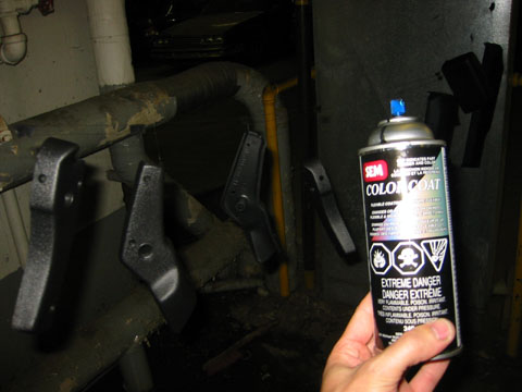

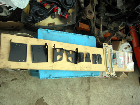

Some of the parts from the kit i got prepped after sand-blasting and paint

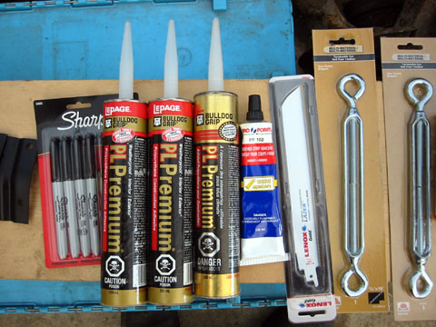

~Some of the materials used

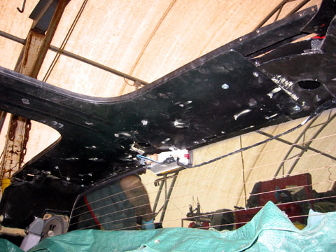

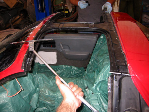

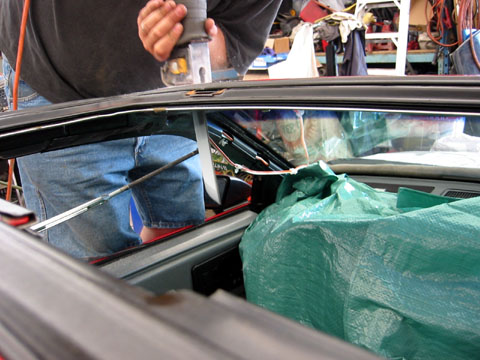

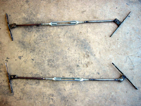

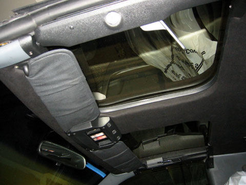

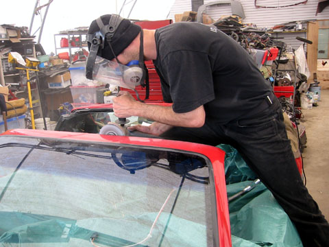

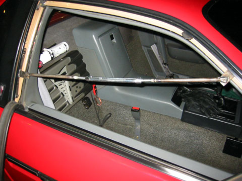

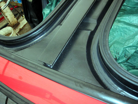

After a couple of prep days (sand-blasting and painting) reading the installation manual 7 times and running virtual mock ups we embarked on the project.
~Custom made frame spreader bars
~ Interior removed
~ Measure 5 times
~ Cut once

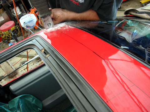

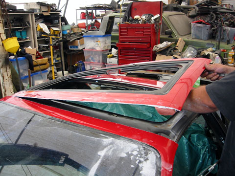

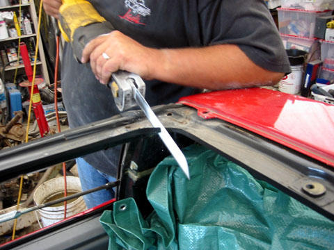

~ Rear section cuts

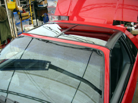

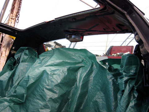

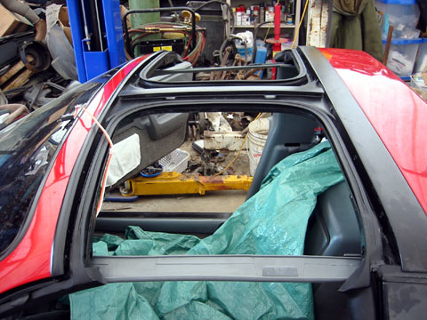

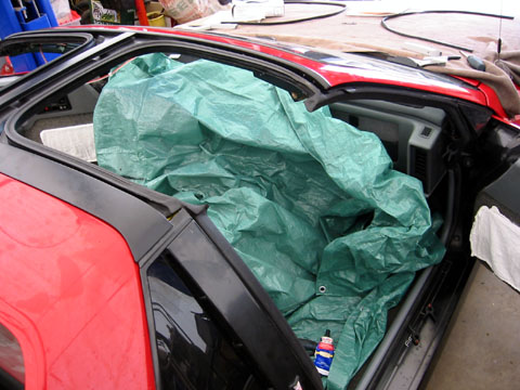

~ Sunroof section removed

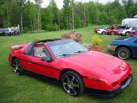

~ Targa Top Fiero ...Sexy

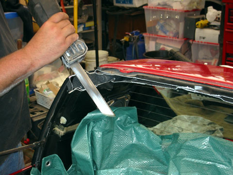

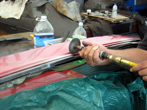

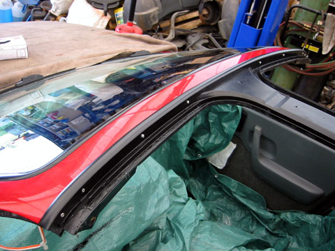

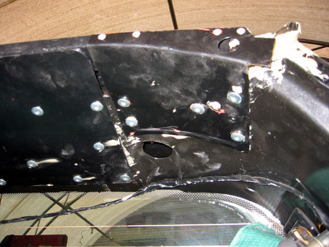

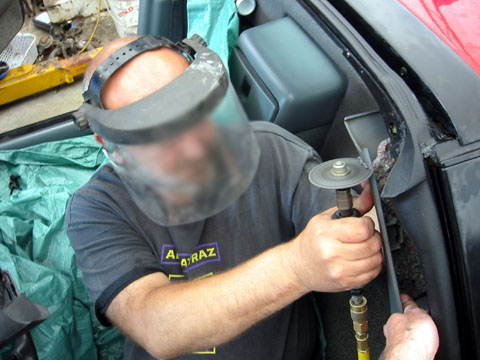

~ Some light trimming on the back...
~ And some heavier trimming on the front

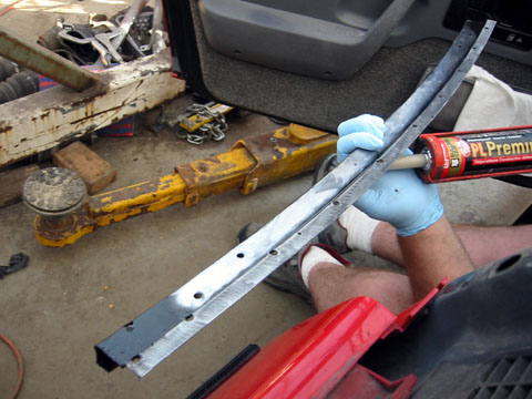

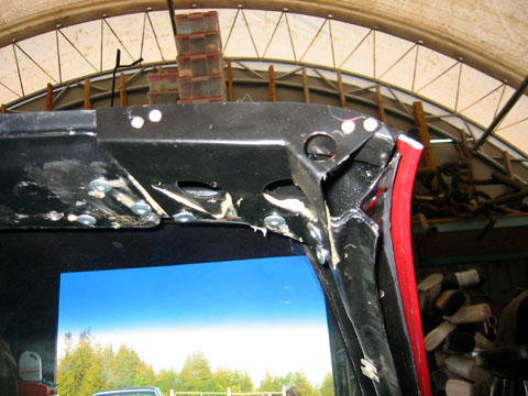

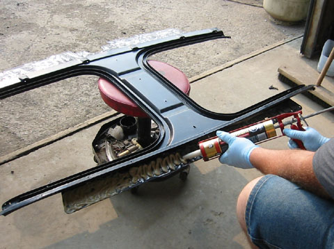

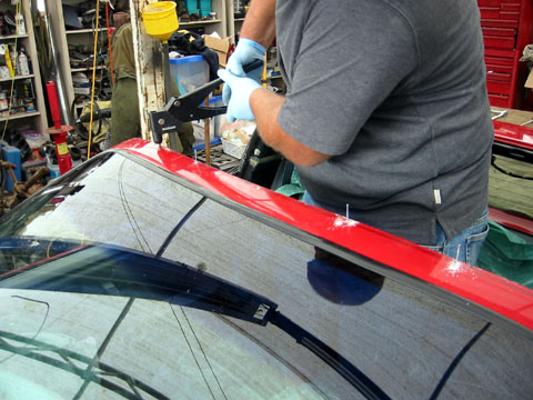

Windshield Header Reinf - glued and riveted
Roof Frame Asy Insert

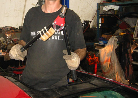

~ Slight modification on the rivet gun to prevent injuries (bad design)
~ Frame glued and riveted... Frame spreader bars come off

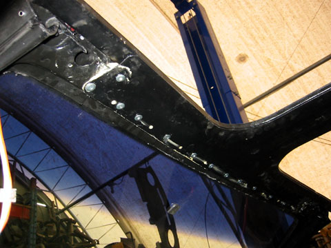

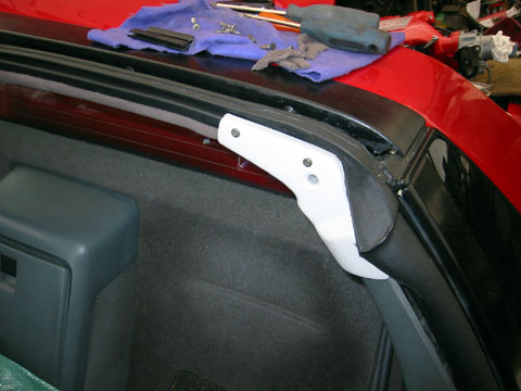

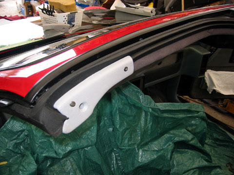

~"B" Pillar Bracket
~ "A" Pillar Bracket

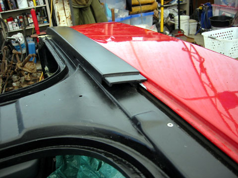

~ Front Roof Outer Molding
~ Rear Roof Outer Moldings RH
~ Center Frame

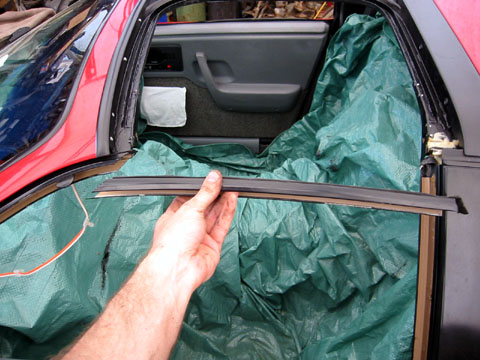

~ Weather seal retainer cut
~ Roof Weatherstrip Seal
~ Silicon on the seams

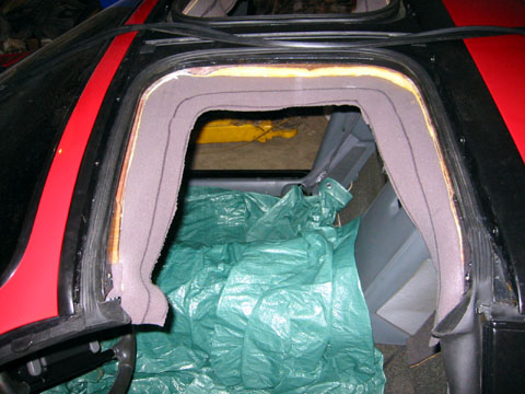

~ Interior trimming

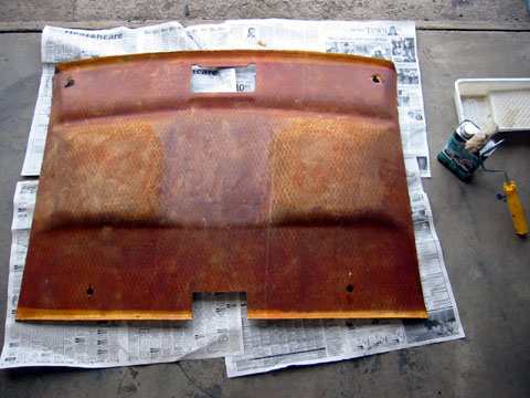

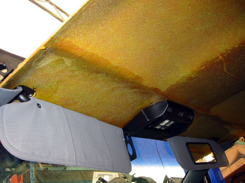

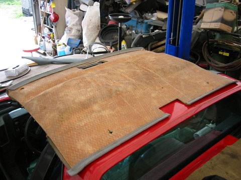

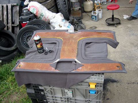

~ Hard-Top Headliner
~ Fiberglass resin for reinforcement
~ Installed for measurements
~ Headliner fabric installed
~ Headliner Lock Molding
~ "B" Pillar Cap Trim
~ "A" Pillar Cap Trim

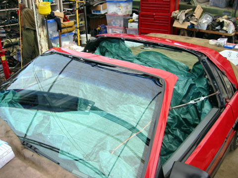

~ Glass Panels installed for the first time

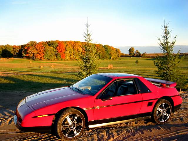

~ The Fiero was now drivable again in it's new form
From CHOP to TOP the project took three work days including all steps required and overnight dry time of the glue and paint used.

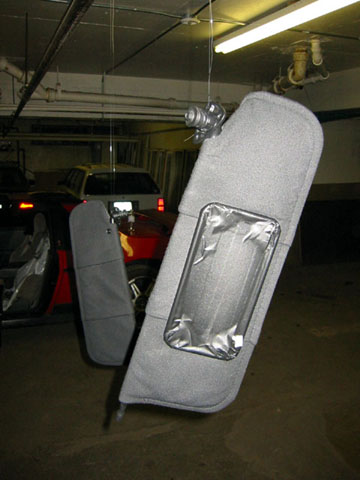

~ Prep
~ paint
~ Recover
~ Voila

I think your wind noise is coming from the lack of P-seals. I don't see where you put them in...I looked at your completer tops but don't see them. Did I miss that step. They make a big difference in wind noise level. Nice job by the way, I just ended up buying a t-top as I didn't want to cut up mine. -Jason
Your supposed to rivet the p-seal thru the front header panel and to the rear two panels. #6 is the p-seal in your pic here:
I just went thru and repbuilt mine last month, what a difference those seals make.

Thanks Jason, you are right, I'm still waiting on the P-Seals to arrive from fieroparts.com
The whistling noise I have is actually when the tops are off, and the flapping sound is the P/S seat belt.
BTW - I spoke to Skytime in Carlisle and he is running without the P-Seals for years with no problems

Report this Post06-16-2007 06:15 PM Click Here to See the Profile for MisterSend a Private Message to MisterDirect Link to This Post
Mister
1975 posts
Member since Aug 2004
Weekend camping...Some pics for your T-Top viewing pleasure
Some rare T-Top images (by Miss T)
Posts: 39478
Total ratings: 464
Report this Post06-16-2007 06:43 PM Click Here to See the Profile for PatrickSend a Private Message to PatrickDirect Link to This Post
Originally posted by Mister:
Heh heh, clever shot of the T-Top.
Excellent write-up of the process!
