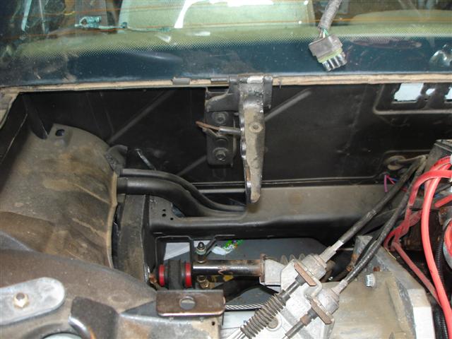

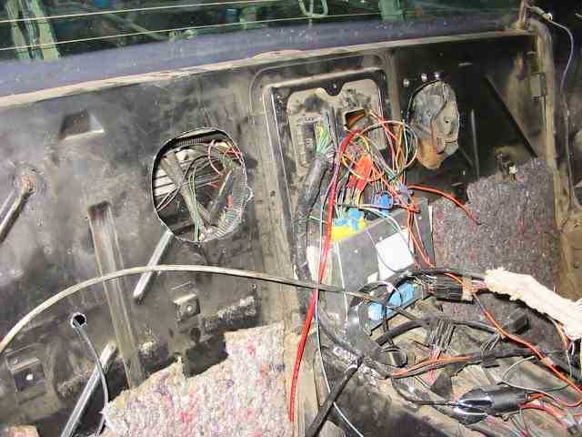

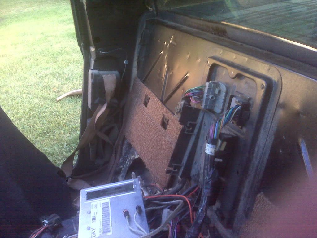

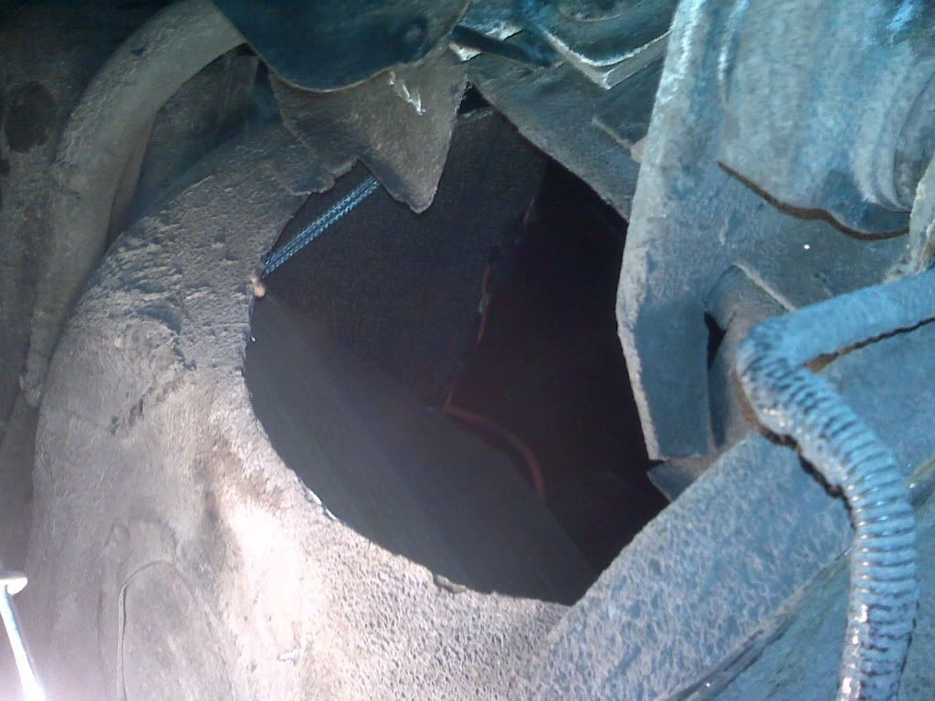

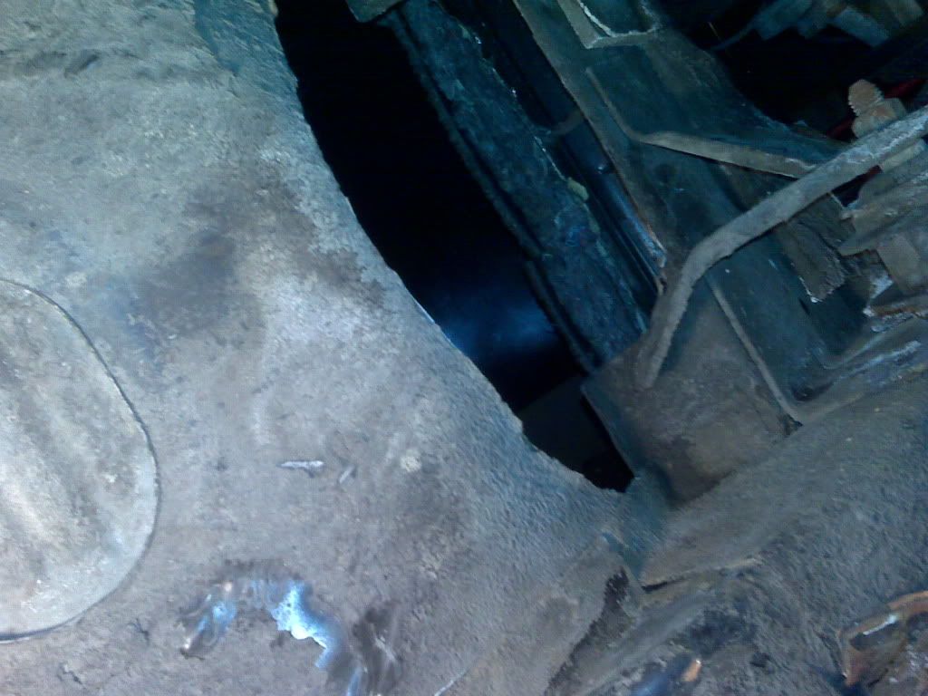

Previously there used to be two 12" subwoofer boxes being free-aired out the back of the car. I just used them until I could find something better. Surprisingly, 2 years later they are beating strong except for the rips in the surround due to over extension. The back sides were dusty but not too damaged at all. Anyways, now while the car is down and I am waiting for electrical components to ship, I might as well take a few days and fix it right. My question is though, should I fiberglass it or weld it? I would want to have it somewhat domed out in the back to give some extra room for the speakers magnet if possible. Here is an idea a saw a while back and liked the finished result. Not sure who posted these but I loved your work.
After ripping out the boxes, this is what I am left with. Currently being sealed up with duct tape and cardboard.
From the top looking down
and the bottom looking up.
Now, what would you recommend? Weld it up and shape the metal to fit a speaker or fiberglass?

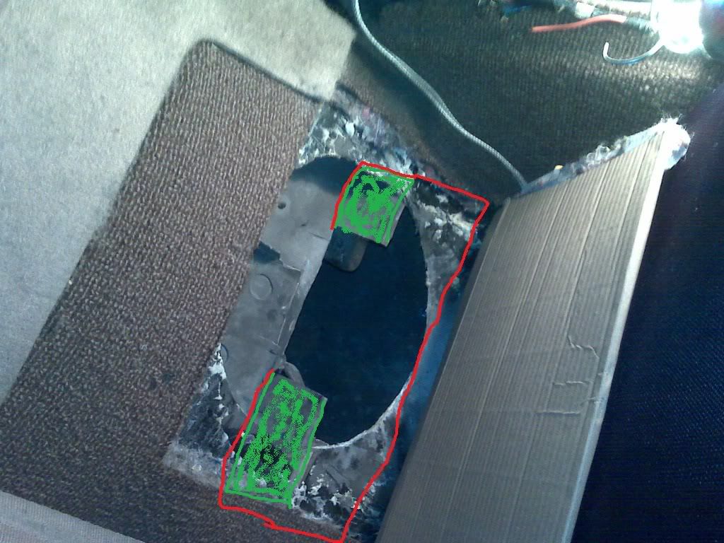

So, would the be my best option to maximize airspace while keeping legroom?
Sorry i'm not an elite photoshopper. but heregoes.
Red lines would be new welds and metal going in.
Green lines would be cuts and the green dotted area would be the metal removed.
Keep in mind this green lines will extend clear up to the rear window if there are no obstructions. If my idea is wrong please let me know as this is only the planning stage.

I'm no engineer but it looks to me like if you remove that much metal out of the firewall, you have seriously compromised the integrity of the spaceframe. If you're in a head-on collision, the car is gonna fold up on top of you.
I would weld those holes back up and make a custom sub box in place of the console box. You could relocate the ECM behind one of the seats. You really only need one sub but you could stack two smaller ones in that space.
CAN'T DO THAT. You'll have the entire back of the passenger compartment open to "free air" and worse off than you started.
That channel is only about 8" high. It's welded to the firewall for rigidity. You want to sheet metal cutout to stay within that channel and not cut the welds or that channel. It's already partially open, so you can feel how high up you can open up the sheet metal, but staying within the channel area.

Report this Post04-10-2010 06:50 PM Click Here to See the Profile for ShillSend a Private Message to ShillDirect Link to This Post
What about removing the top and bottom lip of that channel and extending them to the bottom of the car and also upwards to the bottom of the window. Basically would be more of an extension on the firewall I currently have.

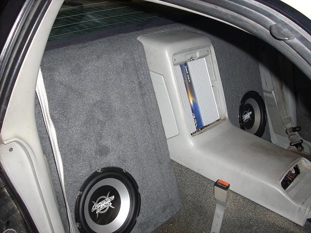

Thank you, I'm glad you like it.
I'd listen to what Fierosound is telling you. It was his install that I used as a basis for mine. He is VERY knowledgeable on this.
What you suggest at the bottom is doable - the idea for the upper end, not so likely (there's an engine there).
I think your best bet at this point is to look at a chassis with stripped interior and empty engine bay so you can see what's on the engine side of the firewall. You'll then get a better idea of what you can and can't do with the fuel and vent lines, decklid hinges, decklid torsion bars and everything else on that side.
You can then decide to do what you like.

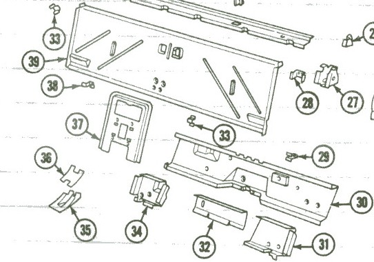

One last thing. From the P22 Parts Book - some pieces of how the firewall is put together - good luck.
More: https://www.fiero.nl/forum/A...070315-2-073338.html

i'd be welding it; that and thoes holes are currently a fire and exhaust hazard.

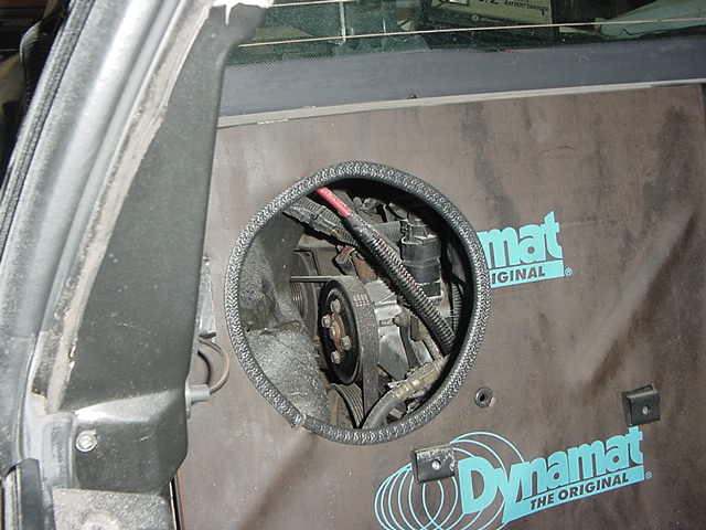

How a couple other guys have done it to mount speakers higher up in firewall.
From here: https://www.fiero.nl/forum/A...020511-2-016830.html
...and here: https://www.fiero.nl/forum/A...090219-1-066435.html

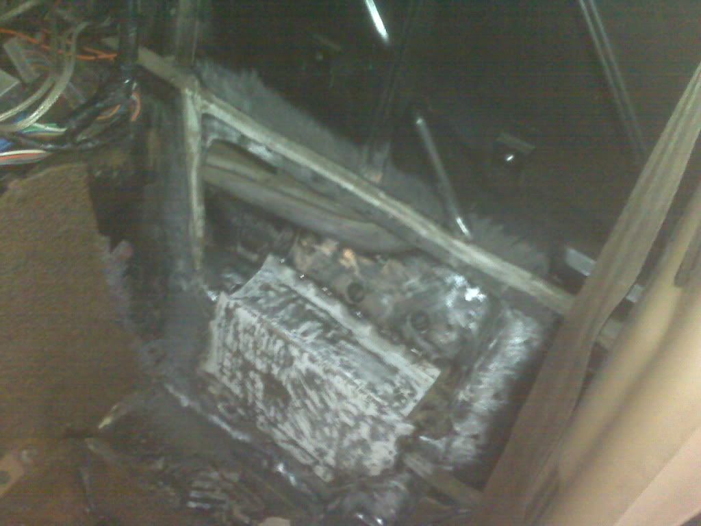

Report this Post08-02-2010 02:18 PM Click Here to See the Profile for ShillSend a Private Message to ShillDirect Link to This Post

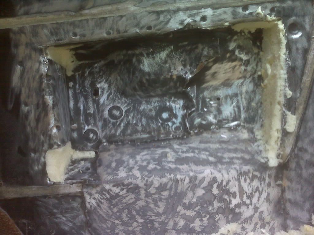

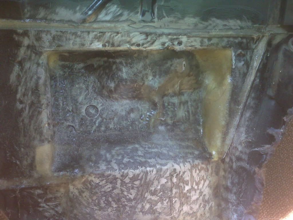

Updates.
Getting ready to glass later today.
Made a new thread with a simple question, hopefully Cliff can merge the two into one.

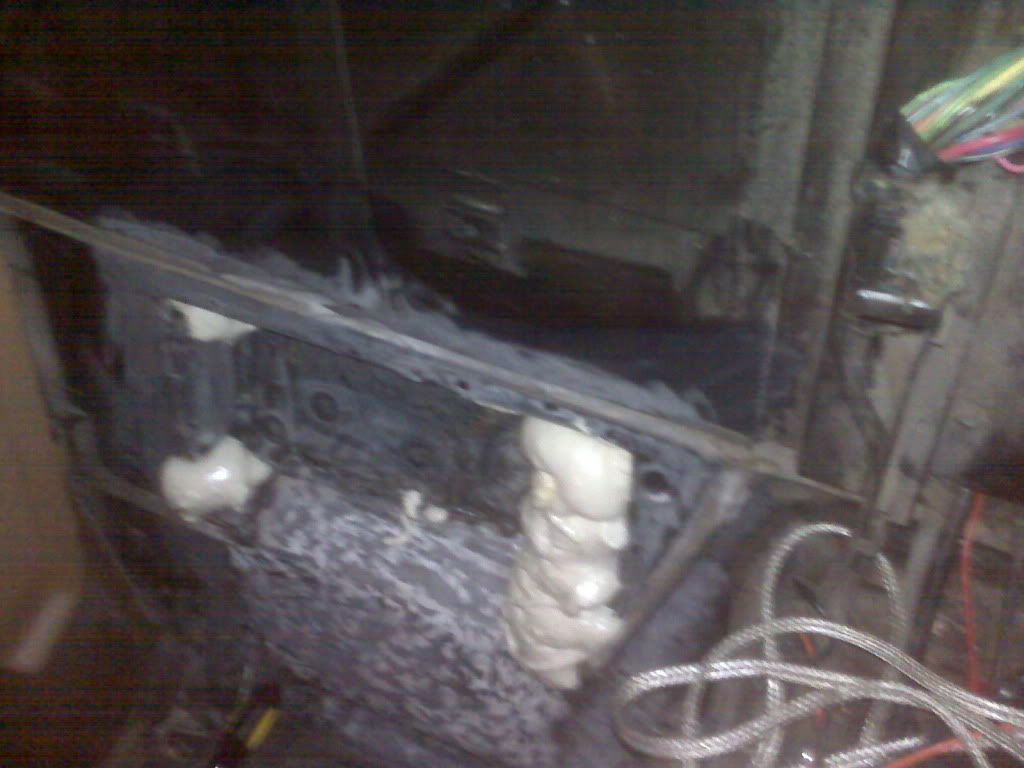

Report this Post08-02-2010 10:28 PM Click Here to See the Profile for ShillSend a Private Message to ShillDirect Link to This Post
Shill
2166 posts
Member since Apr 2009
Waiting for it to cure, will be sanding and glassing tomorrow.

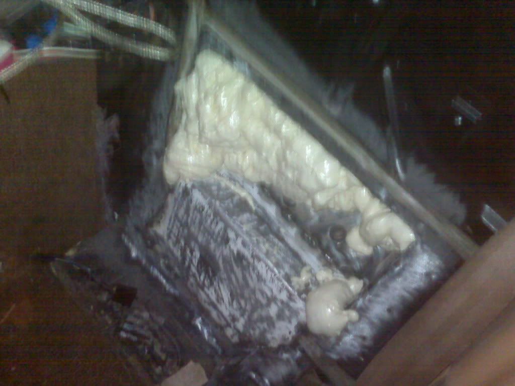

Shill

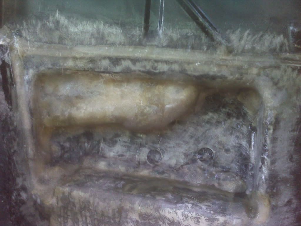

Posts: 2166
From: Spokane, WA
Registered: Apr 2009

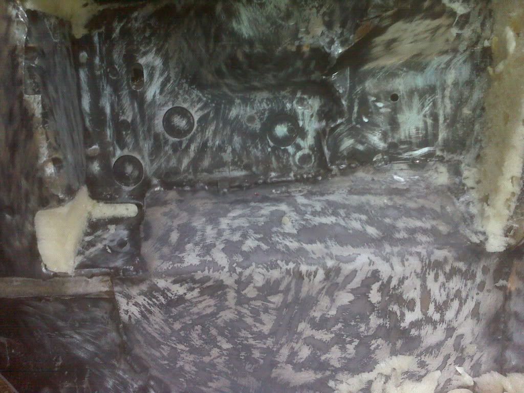

Report this Post08-03-2010 03:09 PM Click Here to See the Profile for ShillSend a Private Message to ShillDirect Link to This Post
Having troubles squaring off the foam on the other side, will post more when done.

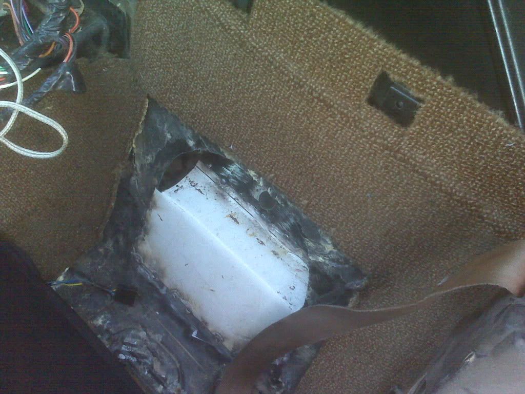

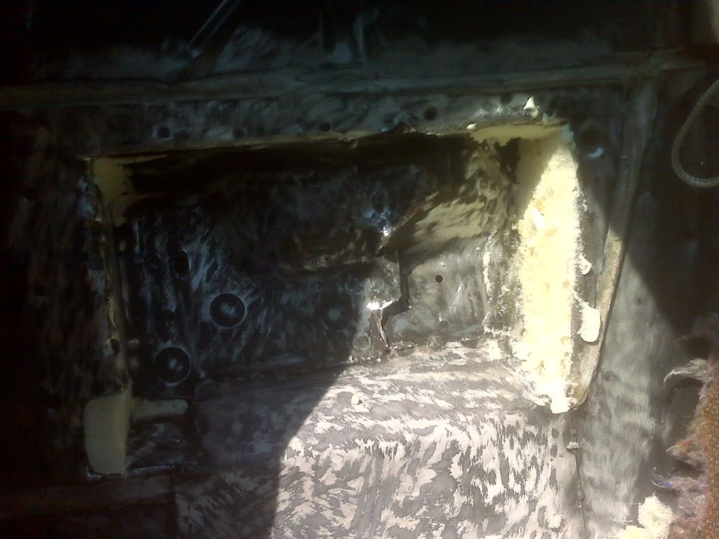

Report this Post08-05-2010 04:24 PM Click Here to See the Profile for ShillSend a Private Message to ShillDirect Link to This Post
Never done this sort of fiberglass before, i've only done repair work so feel free to point out what you please. Have a few small holes to fill yet where the fiberglass is a bit thin, but here are close to the final pics.

Report this Post08-05-2010 05:07 PM Click Here to See the Profile for ShillSend a Private Message to ShillDirect Link to This Post
Shill
2166 posts
I have begun cleanup, vacuumed most of the large strands out of the carpet, but there is still fine particles and the dust from sanding. How do I get this up out of the carpet?
