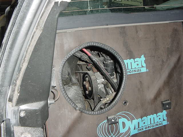

The firewall is double walled. When you cut through from the inside you reveal a small cavity. The small cavity is not large enough to mount a speaker it's only about 2 1/2 inches deep. But it gives enough room for the magnet of a large subwoofer and allow you to build your enclosure to a smaller depth.
You REALLY don't want to cut all the way through into the actual engine compartment. It's called a firewall for a very good reason. You would likely asphixiate yourself with carbon monoxide poisoning as well.

I cant say that I've had any problems with my 8 inch sub install yet because it isn't finished.
But I thought i would speak up since it seems there aren't many firewall subs out there (I'm not counting console mounted subs of course).
I only have the passenger side hole for now. I'm not sure if I will need the drivers side or not
because one sub might just be enough bass. That's the way I have planned it anyways.
However, the drivers side can be done but you will have to relocate the relays and the fuel filler pipe probably will be an issue and perhaps the air filter as well (V6 car). Yep, have to move some stuff.
An enclosure will be necessary in my opinion. One of the earlier posts eluded to the fact that it would just be a speaker stuck in the hole.
Never mind the danger of fumes coming in the passenger compartment, the speaker itself would deteriorate from the heat and from the rain water, or the car wash spray or a bunch of other things that could happen there.
I have relocated my battery, so the area behind my sub is clear for an enclosure.

Well there is a first time for everything. I've never seen anyone actually cut through the firewall. Make darn sure your enclosure is airtight or you are going to get serious heat, smoke and vapors into the cabin and it's not going to be nice.

I put mine in the double wall area down low - like in jscott1's pic. or more like fierosound's pic - both sides, kinda square.
then, made a fiberglass shell to fit the hole. the dbl firewall area is NOT that big, or very deep. like someone said - adds maybe 2"
the speaker generates WAY more heat than what is transmitted thru the firewall. but, I also dont have a cat conv, which is right by the drivers side, and is a MAJOR heat soak source.

I chose this sub location because it would be able to be hidden behind the firewall carpet panel and it was easier to put them up high because the lower firewall area has a wiring harness in the way and the sheetmetal below the battery tray (part of the wheel well) would have to be cut.
Also, it cleared the trunk hinges and fits just nicely.
Driver's side
Ok, the firewall is double walled but only down low (at least on the passenger side, I haven't cut into the drivers side). What I mean to say is there is a space between the layers down low, but up high (on my 85 GT) it is two layers of sheetmetal directly against each other, no space between at all until you get back up the the area right against the base of the rear window, then there is a hollow channel across for structural support.
