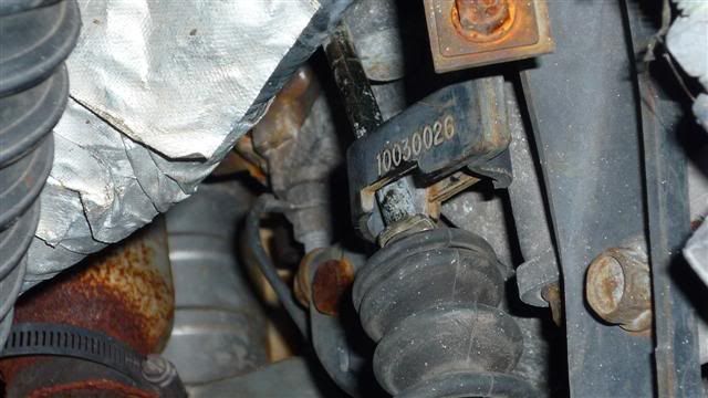

Just got back from the shop. Seems it's not the rod that's broke, but the little square plastic part that the rod goes up against. They know it was plastic because they found a piece of it. See pic...
The rod is coming up from the bottom of that pic, and going through where the broken part used to be.
That square plastic part was originally in the clutch release lever. Do I have to get the whole lever, or can I find just the little plastic square part somewhere?
Is the lever an 84-only part?
[This message has been edited by Cheever3000 (edited 03-02-2009).]

can you take a picture from farther back?
No, not today. It's at the shop 5 miles away, and I'm not going out again today. I could do that tomorrow, but I have already ordered a new clutch arm from The Fiero Store. They said it has been redesigned to eliminate the extra plastic part.
That is the 'old' style release arm. GM replaced it with the cast part that you find on most of the transaxles now. My 86 also had this style of arm on my Izusu, at least till I replaced it with the cast one.
edit: guess you figured it out already with a call to the Fiero Store.

yeah, that arm cracks out where it grabs the spline on the fork arm. had that happen on my 86. welding didn;t hold for long, only got another week out of it, then replaced it.

If it's just the plastic part you want, I'm 99% sure I have one, (probably 2 of them) but can't check on it till tomorrow. Go ahead and PM me your mailing address and I will get it in the mail to you tomorow. And--Yep, you want to look down at where that lever attaches to the spline of the clutch fork shaft and make sure it isn't broken or cracked. If it isn't now, it eventually will be. You need to replace the stamped part with a cast part as soon as possible. (I ran on a welded up one for about 3 weeks but was scared of it the whole time.)

Get the cast arm!! If you replace it with the old one it will just happen again.

This happened to me before too. Swap the arm with the cast one like the others have said.
