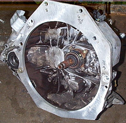

Welcome to the build up thread of the West Coast Fiero 5/6 speed transaxle.
For the longest time, Fiero owners have had to accept the weaknesses in the Fiero 4 and 5 speed transaxles. Hitting only 25 mph in first gear, weak spider gears etc.
No longer.
We are now introducing the first of the WCF5 and WCF6 Transaxles.
http://www.westcoastfiero.com/transmission/transmission.html for details.

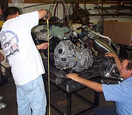

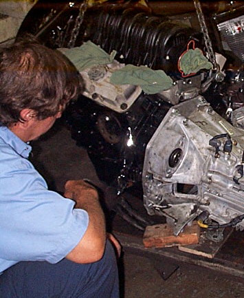

The transaxle is now ready to bolted up to our mock 3800 block for fitting purposes.
The tranny and engine are now bolted and ready to start the fitting process on an 84-87 cradle.
Measurements are painstakingly made and confirmed for a level powertrain and top notch craftsmanship.

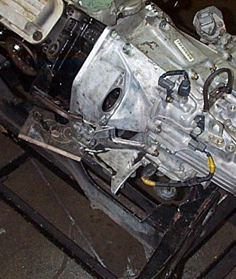

The powertrain is now mounted on the 3800 engine mount and we have found it necessary to modify the cradle for tranny mounts.
Tomorrow, the mounts will be created. Chris has confirmed that a dual clutch setup which will be used for maximum clamping power.

The 3800 will most likely not have the maximum power to push the transaxle very hard. It is up to the customer to decide how far he wants to go later on in this project. What we are doing here is purely prototype mock ups for when the actual recipient Fiero arrives.

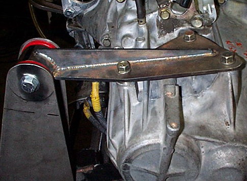

Shown is the prototype of the rear tranny mount/ bracket.
Work is still being done and considered for the front tranny mounts and bracket. Modifications to the cradle will be shown soon.
As far as jumping off the line, a 25 mph 1st gear BLOWS even with the 2.8. Give it 10 more miles with the torque of the 3.4 and it would be perfect in my opinion. Put a V8 on it (as I remember in the days before California Kid took his car) and you might as well just have a 4 speed transaxle because the 1st gear is useless with that much torque. You might be having an engine singing but its got NOTHING to sing about crawling at 25. Granted, 55 may not something that you want (though 65 seems to be good enough for the Ford GT's first gear) but multivalve engines just don't have the low end torque as the push rods. The push rods trade that off by not being as efficient at mid to top end.

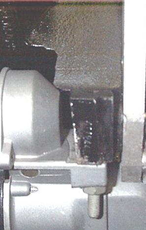

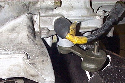

An early prototype for the front tranny bracket. It is unlikely that this will remain in the final design. Preliminary designs will most likely have the adaptor plate extend further out to double as the tranny mount. This will keep torsional forces away from the tranny case. The adaptor plate at this point will have to be redesigned to become a load bearing structure.
In order to maintain a low position of the power train it has become necessary to alter the cradle for shifter arm clearences. This will keep the center of gravity a little lower (every little bit helps) and will also enable the axles to spin in a more central position relative to the position of the wheel when the Fiero is on the ground. The alterations to the cradle will be boxed to maintain cradle strength and craftsmanship.
Something that we have not encountered for a 3800 conversion is this odd interference from the block on the top of the starter solenoid. It will be necessary to grind a little bit off from the block for a flush stock starter position. Has anyone else had this problem? The block we are using for mock-up purposes is a 2002 Buick (model unknown)

WKDFIRO
Posts: 1637
From: Cerritos, California, USA
Report this Post10-29-2004 04:02 PM Click Here to See the Profile for WKDFIROSend a Private Message to WKDFIRODirect Link to This Post
Originally posted by dguy:
Anthony & WCF:
Is there a difference between the amount of slave travel the NSX clutch requires for proper engagement/disengagement, and the amount of available travel resulting from bolting up the NSX slave to the Fiero's stock hydraulic system? If so, what is your solution for this?
We will be using the Fiero slave cylinder since we are most likely going to be using as much of the stock Fiero clutch set up (Fiero flywheel, clutch disk, preasure plate) for the simplicity.
Originally posted by LoW_KeY
I know this will be a far shot to ask, but if this goes good when do you guys plan on selling them? I think I'd be more inclined on taking a travel out there. I'll be a test mule for an 88
This first transaxle is a customer's and not the shop's prototype so we are technically already selling these transaxles, its just a matter of who wants to step up to the plate and pay for the transaxle itself.
[This message has been edited by WKDFIRO (edited 10-29-2004).]

Report this Post10-29-2004 05:27 PM Click Here to See the Profile for WKDFIROSend a Private Message to WKDFIRODirect Link to This Post
WKDFIRO
1637 posts
Member since Nov 1999
Originally posted by donk316:
Do you mean it wouldnt be possible and cant be done by the customer? Is that what you meant to type?
I dont understand what your saying......yes or no is easiest for me to understand.
No.
I'll be posting some pictures of the casing and cradle modifications as soon as I get a chance.
Anthony
West Coast Fiero

WKDFIRO
Posts: 1637
Report this Post11-22-2004 05:06 PM Click Here to See the Profile for WKDFIROSend a Private Message to WKDFIRODirect Link to This Post
Sorry for the delay in updates, I seem to be having a problem with PIP on this computer.
Still working on it and will get pictures up ASAP.
