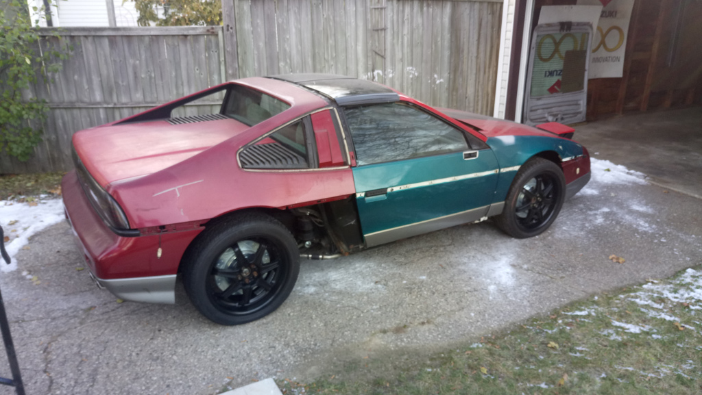

I'm feeling giddy.
I drove the car out of the garage under its own power. Woo hoo!
This car was towed home on a dolly and pushed into the garage several years ago. It has now emerged as a running, driving entity. Albeit an ugly duckling in its current state. I feel good about the car and I now have a desire to continue on and actually finish it. It will need an alignment, body and paint and finishing. My friend owns and runs his own body shop. I'm hoping that I can leave the car at his shop over the winter and he can pick away at it.
