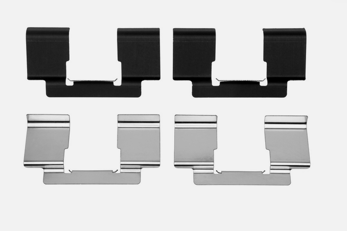

I needed to replace one of the shims on my wife's car due to it breaking. I ordered from Rockauto and received a set of 4 shims, 2 are silver and 2 are black. They are all identical. Does anyone have any idea if there is a specific order for these? In other words black on bottom, silver on top etc?

So to make myself look REALLY stupid, here's the outcome. I ordered 3 bags of shims. Looking through the clear plastic bag, they all had 2 black and 2 silver shims in a bubble pack. I decided to open one pack to do the job and realized that they were silver on one side and had a black coating on the other. I guess I should have taken them out of the package BEFORE creating this thread.
So......if you order shims and 2 look black and 2 look silver, open the damn package and flip 2 of them over. Then they'll all match

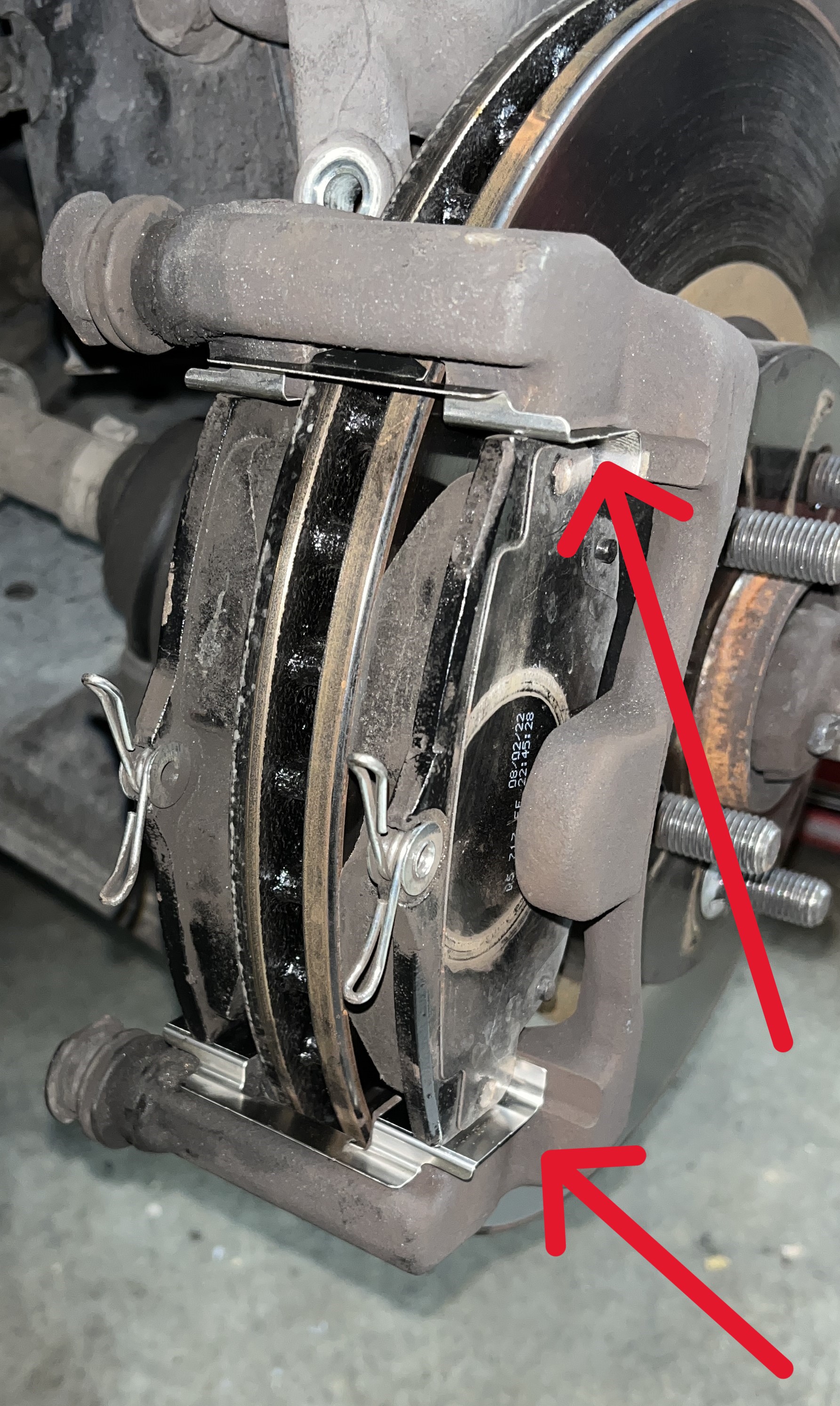

Cliff, here are the shims. They allow the brake pads to float with the caliper:

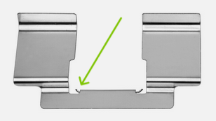

I guess the way they're made, there's no real way you could install them backwards right? So the black side will always be outward facing?

Correct and as it turns out, the black coating is some sort of tacky material so that it won't vibrate in the caliper bracket.
