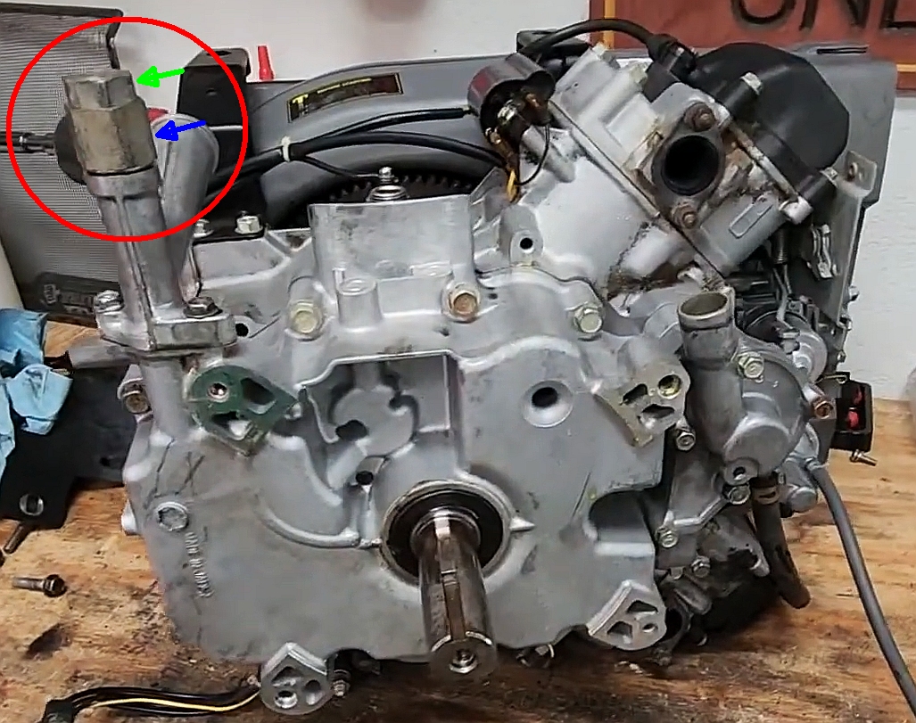

I recently bought a new (to me) home on 1.1 acres. It came with a John Deere 345 lawn tractor. The previous owner wasn't exactly a mechanic, so I've stripped a lot of the lawn tractor apart to check it over and repair as I see fit.
The grass is rapidly growing, and I need this lawn tractor ready to rumble this week.
I've got its Kawasaki FD590V (V-twin) water-cooled engine now running smoothly, so I'm ready to change the oil and filter before I put this beast to work. Seems like something simple, but... I'm not 100% sure how the oil drain plug is supposed to be removed. There appear to be different types of drain plugs used on these machines, and I grabbed the image below from someone's YouTube video of their engine which has the same type of drain plug as mine. Keep in mind, this is a vertical crankshaft engine. The engine in the image below has been tipped on its side.
I assume (because I don't know for sure) that the plug on the end (green arrow) unscrews from the fitting identified with the blue arrow. I've been spinning wrenches enough years to know how to use two box wrenches in such a manner that you can slightly offset the two wrenches and squeeze them together to loosen such a fitting. However, when I try this, the end plug does not want to budge. I don't understand why an oil drain plug should be so freaking tight... which is why I'm wondering if anyone one else here has a similar oil drain plug assembly on their John Deere lawn tractor.
I'm about ready to try an impact gun on the plug with a box wrench holding the inner fitting. I don't want to go too crazy with the impact gun though, as the rest of the assembly (which attaches to the block) is just aluminum and I don't want to crack/break it.
So, is anyone familiar with this style of oil drain plug? Am I going about loosening the plug in the correct manner?

Patrick, that is not a lawn tractor, it is a lawn mower.
I have never seen a oil drain "plug" like that. It appears to me it is all one unit.
Over tightening is a common problem, be it an oil plug, an oil filter, and many other things. I was taught to tighten first, before trying to loosen. I don't know how that makes sense but I have never broken a head hold since.

If the area identified by the blue arrow was smooth (like a pipe) I'd agree with you, but it isn't. It's made to accept a wrench, as is the plug on the end identified with the green arrow. Deductive reasoning would indicate that a wrench is expected to be used on both components, which makes sense as this would prevent any twisting motion to be transferred to the rest of the aluminum assembly which bolts to the block. I suspect that I am trying to go about this in the correct manner... but I'm hoping for some reassurance from someone who's familiar with this style of drain plug.

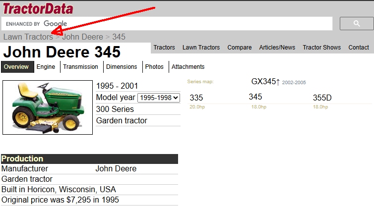

Originally posted by cliffw:
... that is not a lawn tractor, it is a lawn mower.
Not sure why you wish to be pedantic about this... but here's a screen grab from the site I linked to above.

The little bit of research I did seems to show there's supposed to be a spout under the filler cap to drain the oil from. That appears to be missing so I wonder if ol boy broke it off by accident and just found something with the same thread to stick in there. I have half a mind to say try to remove the part the blue arrow is pointed at. It almost looks like there's a washer or something between it and the tube it's screwed into.
Worst case I think you had the right idea about impacting the green arrow off while holding the blue with a wrench. If you break it, I'm sure you can find something with the same pitch at ACE.
Worst worst case, unbolt the tube from the block!

The little bit of research I did seems to show there's supposed to be a spout under the filler cap to drain the oil from. That appears to be missing...
Keep in mind that the image of the engine above of somebody else's engine has exactly the same oil drain assembly as mine... so I suspect this is OEM. There were variations over the years of the oil drain assembly used/installed by John Deere. The following is an enlargement of the oil drain area from the photo of my JD at the top of the thread. If you squint, you can see it's the same style of oil drain assembly as the engine from the YouTuber's video pictured above.
Yes, it kind of looks like a rubber O-ring in the photo. I'll have to take a closer look at my engine the next time I'm out there to see if it has that same feature. (I haven't actually moved in yet, and I'm an hour away from the place.)

I was hoping to avoid doing that, as the oil would come out of the block on top of the middle of a frame rail. Could be messy... but yes, it's an option.
I dug a bit deeper online... and yes, that is an O-ring. I discovered this by doing something I probably should've done in the first place... I looked up this lawn tractor in the John Deere parts catalog. The two red arrows below pointing at #14 and #15 are what I have, and #24 is the O-ring. So yes, it does appear that the plug on the end (#15) is supposed to unscrew from the fitting (#14)... but damn it's tight!

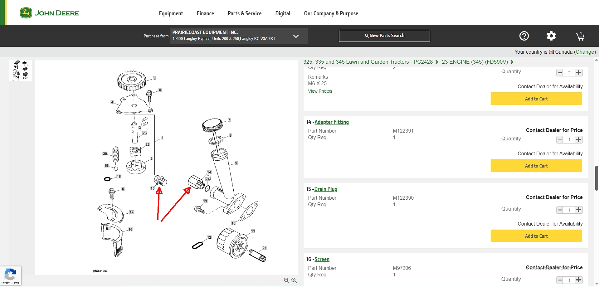

I found an image of an oil plug with the part number indicated in the parts catalog image a couple posts back.
CLICK FOR FULL SIZE
Yes, that pretty much looks like what's on the end of my oil drain assembly. Armed with this knowledge, I was bound and determined to get the oil drained from my John Deere's engine today.
I tried that again today. No dice. I've got a pretty strong grip, but I could not squeeze hard enough to loosen the plug. So... slight change of tactics. I offset the two wrenches in the opposite orientation and used a short prybar to separate the two wrenches. It took a few attempts, as that drain plug did not want to budge... but finally... (as George Costanza divulged)... it moved.
I have no idea why anyone would've tightened that drain plug so friggen tight. There's a rubber O-ring on there for crying out loud. It was not going to leak or get loose if it was simply snugged up like a normal person would do. Geez!
Anyway, I changed the oil and filter, changed the coolant, sharpened all six blades, greased all the fittings, reinstalled the mower deck... and tried cutting some grass. Worked like a charm. I'm a happy camper.

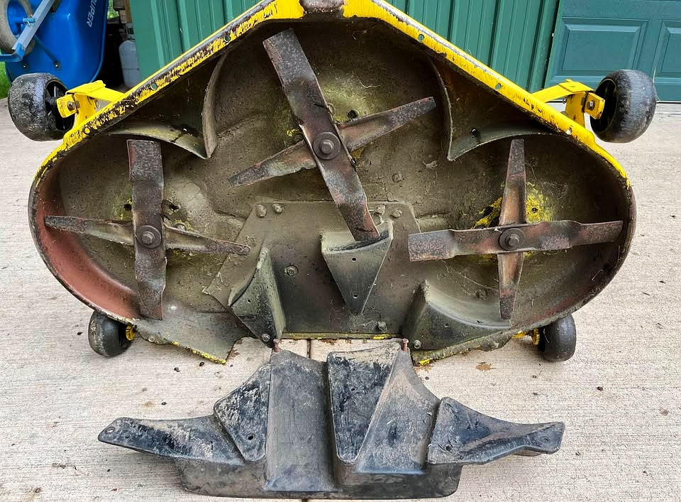

In a former life, I worked for an ag distribution dealership whose shop worked on any make or model lawn equipment and farm equipment. If you only knew how many times we got lawn equipment in with no oil in the crankcase because someone did not tighten the drain plug tigh enough.......
'o' rings deteriorate and that plug is probably straight threads, not tapered. That means the only thing really holding tension is the 'o' ring. Once it gets smaller, the tension is gone and the plug can back out from vibration and heat/cool expansion/contraction cycles..
Your missing deck piece is a mulching plug. Without it, the cuttings will prematurely exit the rear of the deck instead of getting rotated around in there, and cut up finer each go-around. That part also acts as a wear shroud for the rear part of the deck. All that grass/dirt and sand swirling around under there will wear the rear part of the deck thin pretty quick. Cheaper to replace the wear shroud than the whol;e deck.
The other option is to buy and install the grass chute that would be there if ya don't mind a long windrow of brown dead grass cuttings, which will eventually lead to long dark green live grass swaths where the long dead brown grass decayed into natural fertilizer.
You could also acquire the bagger attachment instead of the mulching plug if you really like handling and storing rotten stinking piles of grass to spontaneously combust when you least expect it to..
Yes, it is... and the price for this large chunk of plastic locally is $324 (Cdn). I was thinking it probably wouldn't be all that difficult to fabricate something relatively simple to effectively restrict the three exit chutes in much the same manner that the mulching plug does. I then found a thread on My Tractor Forum where the fella discussed the homemade mulching panel(s) that he had created.
If I decide I need to try this mod...The blue arrows below point to the type of metal stock I'd start with to utilize and mount where the mulching plug would normally reside, indicated by the red outline. The green arrows indicate the three exit paths, with the different levels of restricted flow. Looks like a relatively simple concept to implement.

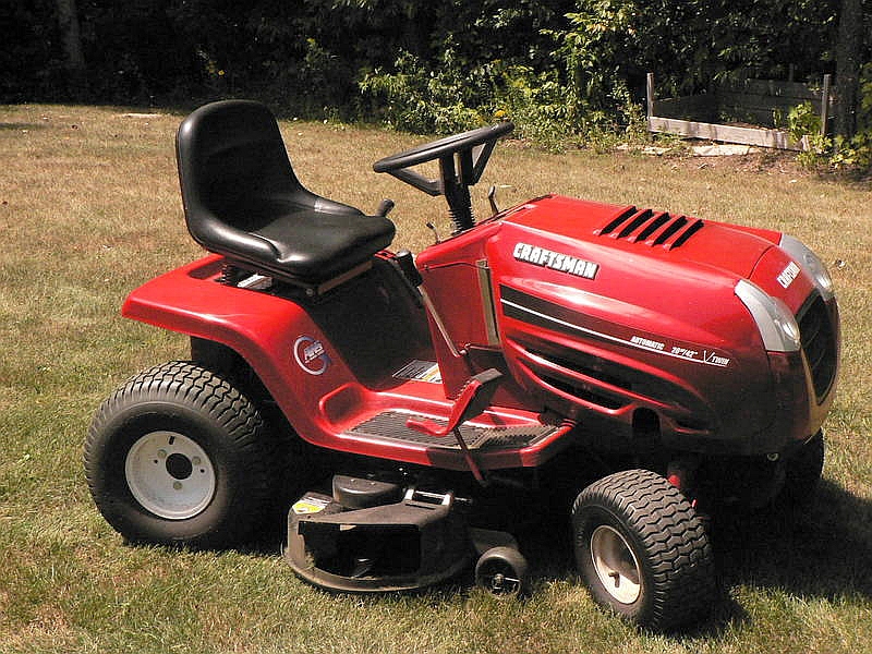

I've come to the conclusion that just about any new zero turn mower made for the residential market is pretty much crap regardless of brand name.
Does all wheel steering count as "zero turn"?
When I bought my property, I actually negotiated to have two lawn tractors included in the deal... the John Deere 345 (discussed above) and an AWS unit labelled as a Craftsman (sold by Sears Canada) which was made by Murray. This is what it looks like...
I didn't even realize that AWS was something that was available on lawn tractors. I soon discovered though that something was wrong with it (after I bought the property) when I realized that both rear wheels/tires could be turned independently by giving either tire a good kick. It turns out that a lever is broken underneath the tractor that connects the rear wheels to the rest of the steering mechanism. Anyway, I focused on getting the John Deere running (mission now accomplished), and this lawn tractor will be a future project.
I mention all this just to bring AWS into the discussion in case it qualifies as "zero turn". I can't say I'm impressed with the build quality of this Murray lawn tractor (ie the broken rear steering lever), but AWS may be an option to look at depending on what is currently available.

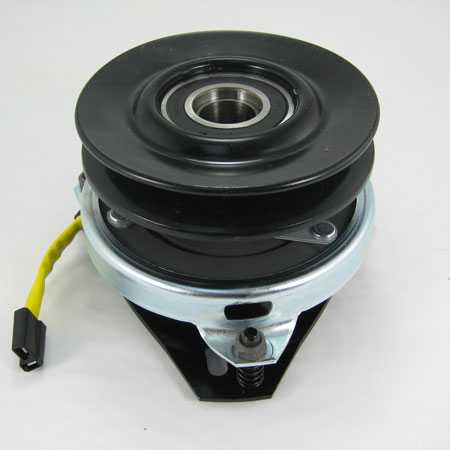

Originally posted by Patrick Here:
In regards to the PTO. I haven't actually looked up how to engage it yet. I've got the mower deck removed in order to sharpen all 6 blades (12 cutting edges!) and to service the three blade spindles. I can tell from looking under the engine that it has what appears to be a brand new PTO unit installed. Nice and shiny!
I've been using my John Deere lawn tractor for the last two months. Works great. Yes, I eventually figured out how to engage the electric PTO for the mower deck/blades.
So earlier this week I was mowing the lawn, and the blades suddenly stopped. Turning the PTO switch off and on didn't do anything. I went to back up a bit, and the mower thumped up and down as it ran over something. I couldn't believe what I saw. There sitting in the grass was the electric PTO from the John Deere!
When I had the John Deere mostly all apart earlier this year, the one thing I didn't check was the tightness of the bolt holding the new looking electric PTO onto the end of the engine's crankshaft. Obviously, whoever installed it didn't tighten the bolt enough... and it had come completely out at some point while I was cutting the grass this week. I thought it might be an impossible task to find the bolt in the grass... but there it was, complete with its washer, about 20 feet away.
The wiring connector got a bit screwed up when the PTO dropped off the crankshaft and yanked the terminals apart, but I put it all back together (tightening the bolt with an impact gun) and it all works just fine. I think I dodged a bullet there!
The previous week I picked this up from the lawn. Can you say... "awwwwwww". The babies are so slow, as opposed to the adults that can move like pinballs on crack!
[This message has been edited by Patrick (edited 06-22-2025).]
So earlier this week I was mowing the lawn, and the blades suddenly stopped. Turning the PTO switch off and on didn't do anything. I went to back up a bit, and the mower thumped up and dawn as it ran over something. I couldn't believe what I saw. There sitting in the grass was the electric PTO from the John Deere!
This, is/was a very common problem with electric PTO magnetic clutches on many different brand riding lawn mowers. That clutch gets lots of stress and vibration from the belt and deck and the bolt either backs out or breaks off..or both. Tech notes said to use red thread locker on the bolt but the problem with that is, if the electric coil quits working, it's almost impossible to get the bolt out to change the clutch. Broken pto bolts were an almost weekly thing where I worked..or bring the unit in just as you described with a perfectly good working pto clutch but the wires broken off too close to be able to splice back together. That means a customer had to buy a new clutch assy and they were not cheap even back around 2010. I can just imagine what they cost nowadays.
I'm not going to tell you to bypass the reverse gear safety switch (Kicks the pto out anytime the machine is put in reverse) but that constant on/off of that pto clutch is one of the major contributors to wearing it out early.......
I've never used much thread locker over the years, so my experience with removing a nut or bolt where it's been applied is quite limited. Are you saying that an impact gun would have a problem with removing that bolt if red thread locker was used? If so, would a weaker version suffice?
CLICK FOR FULL SIZE
Just for "fun", I looked up the price at my local John Deere dealership... $568.14 (In US funds that would be $413.78) Outrageous!
Right from the get-go, I suspected that engaging the electric PTO would be a high stress operation for it, so not only do I limit doing it as much as possible, but I always throttle down the engine prior to engaging the PTO. I also cut the grass in such a manner that I do not back up at all during the process. If I can't enter an area of the lawn and continue to drive forward in order to exit it, I return to that spot later with the gas-powered push mower to finish the job. That might be a heckuva nuisance with a larger property, but for 1.1 acres it's not really a problem.

Yes, an impact wrench 'should' be able to remove that size bolt except they are usually a relatively long bolt with most of the bolt's shank not being threads. Lots of room for fatigue in the length vs the width of the bolt. Many different brands use that same type elec clutch and we removed them with a torque wrench set at 70 ftlbs IIRC. Had to use a narrow strap wrench to keep the engine from rotating. Ya never knew if the boolt was going to unscrew or break off froma pre-existing crack and if it did, you better hope it left some bolt sticking out the end of the crankshaft..
You pay extra for any part on those green painted things.
I suspect that's a typo?
I wasn't sure how to keep the crank from turning, which is why I ended up using an electric impact gun to tighten the PTO bolt. I didn't wish to hammer away with it too much, and possibly break the bolt, so I erred on the side of caution. I'll be double-checking that bolt before cutting the grass for awhile!
Combine that with price gouging by certain Amazon vendors and you have this...
CLICK FOR FULL SIZE
Not even free shipping at that ripoff price. In total it would be just over $50(US). Turns out it's actually quite a bit less expensive at the John Deere dealership, but still a lot for a damn washer (for the PTO).
