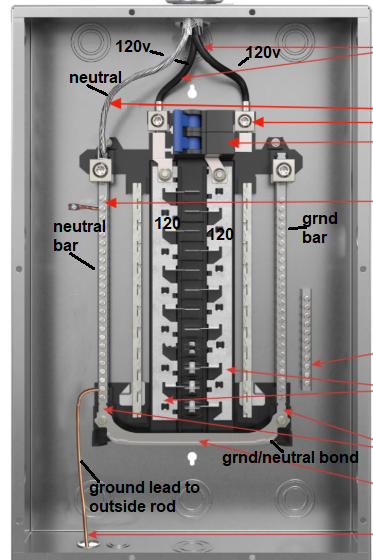

You have 2 lines, of 120v EACH coming in, along with 1 neutral. YOU, the homeowner or business owner supplies the ground. To get 240v,/220v for high voltage needs, you run 2 lines.. of 120/110v each to your appliance.

Can one just add a short ground lead from the breaker box to a ground rod just out side where the neutral is needed and swap the long reach ground ground wire to a neutral ?
That's what I was thinking. The panel Maryjane posted (thank you!) has the Neutral and Ground tied together inside the box. So what benefit is there to ALSO running the 4/0 (or whatever) neutral wire all the way back to the street?

It will be in Section 250.2?, meaning 250.2 thru a bunch more subsections.
Keep in mind that NEC doesn't MANDATE that neutral/ground be bonded, it just states that NEC 'allows' it. Note what I posted:
"Yes, ground and neutral can be (and probably are) bonded together at the "first means of disconnect) "
and
"The ONLY place National Electric Code allows Neutral and Ground to be tied together is inside "First means of disconnect"
