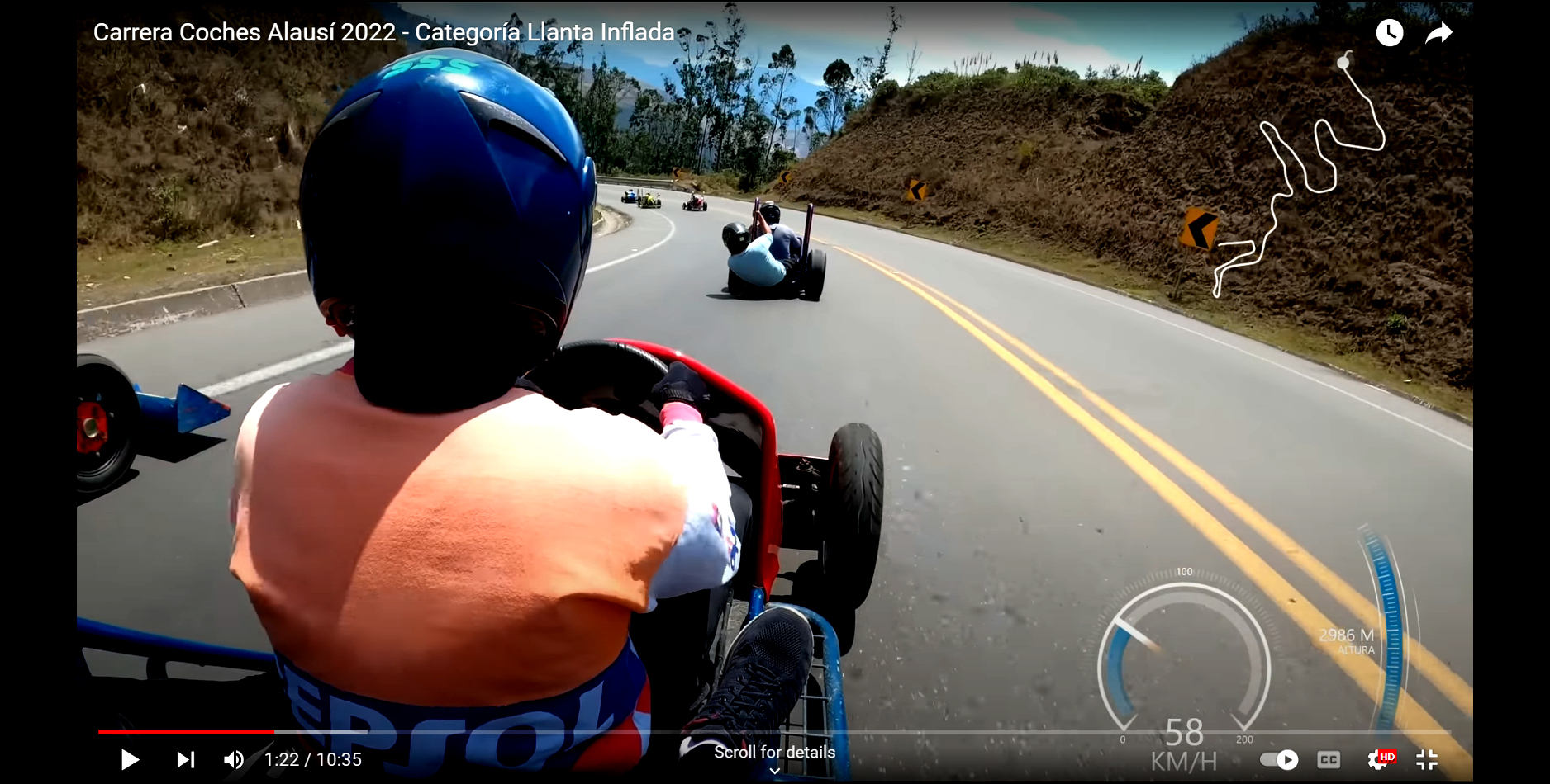

Carrera Coches Alausí 2022 Careening down the side of a volcano !
How would your team compete for the podium ?
What technology would be sufficient to reach the podium ?
Careful you don't leave the track's surface, it is a long way down to the river.

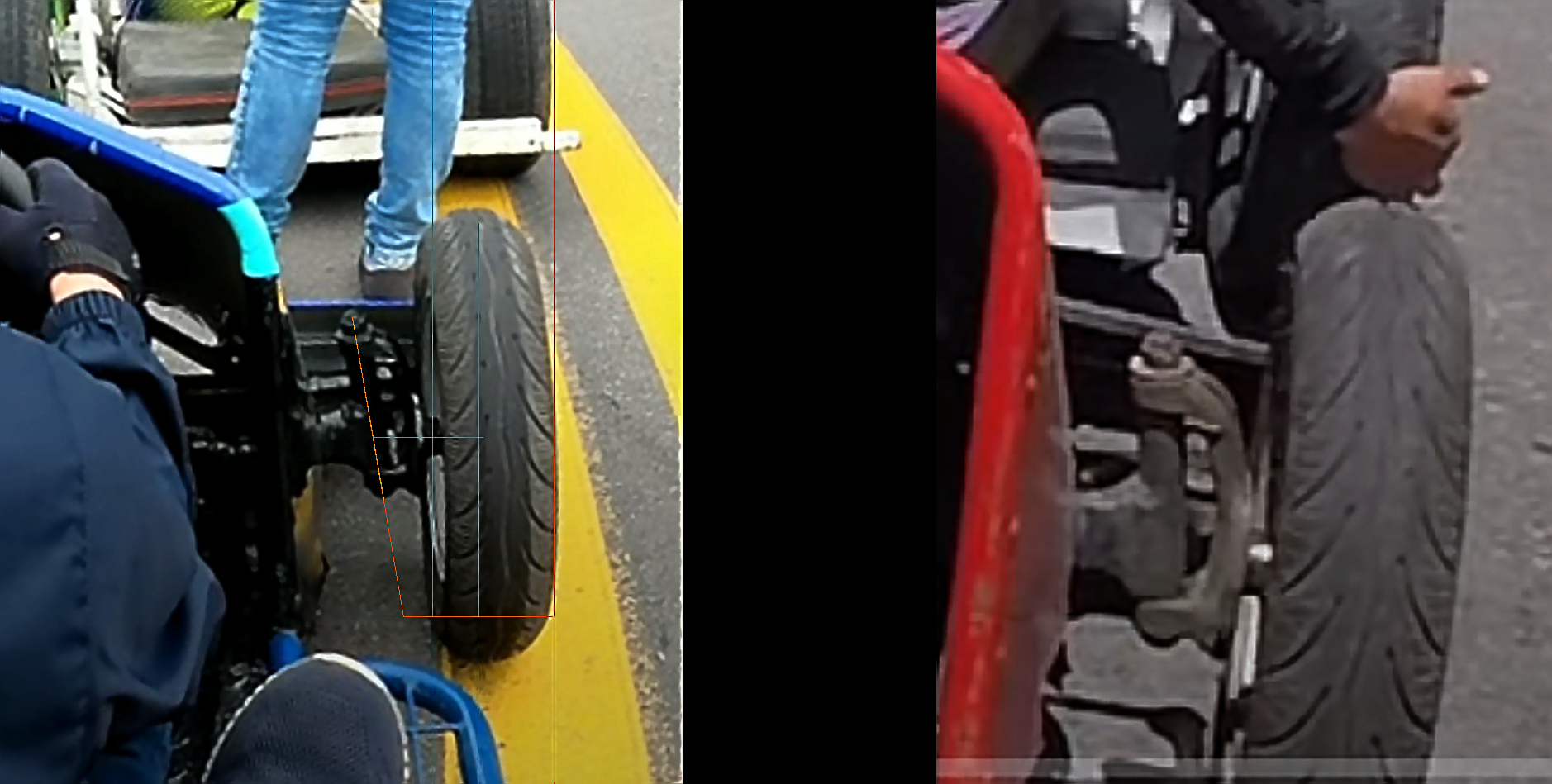

Cesar Zumba Videos
Looking closely, intently, focusing on the steering inputs, you can derive some facts about the kart's front axle geometry.
Far too much caster, toe, king-pin inclination.
Perhaps the brakes are dragging, or it's 40kg too heavy.
Maybe the rear axle is bent from a jump, and is toeing in.
Way too much drag.

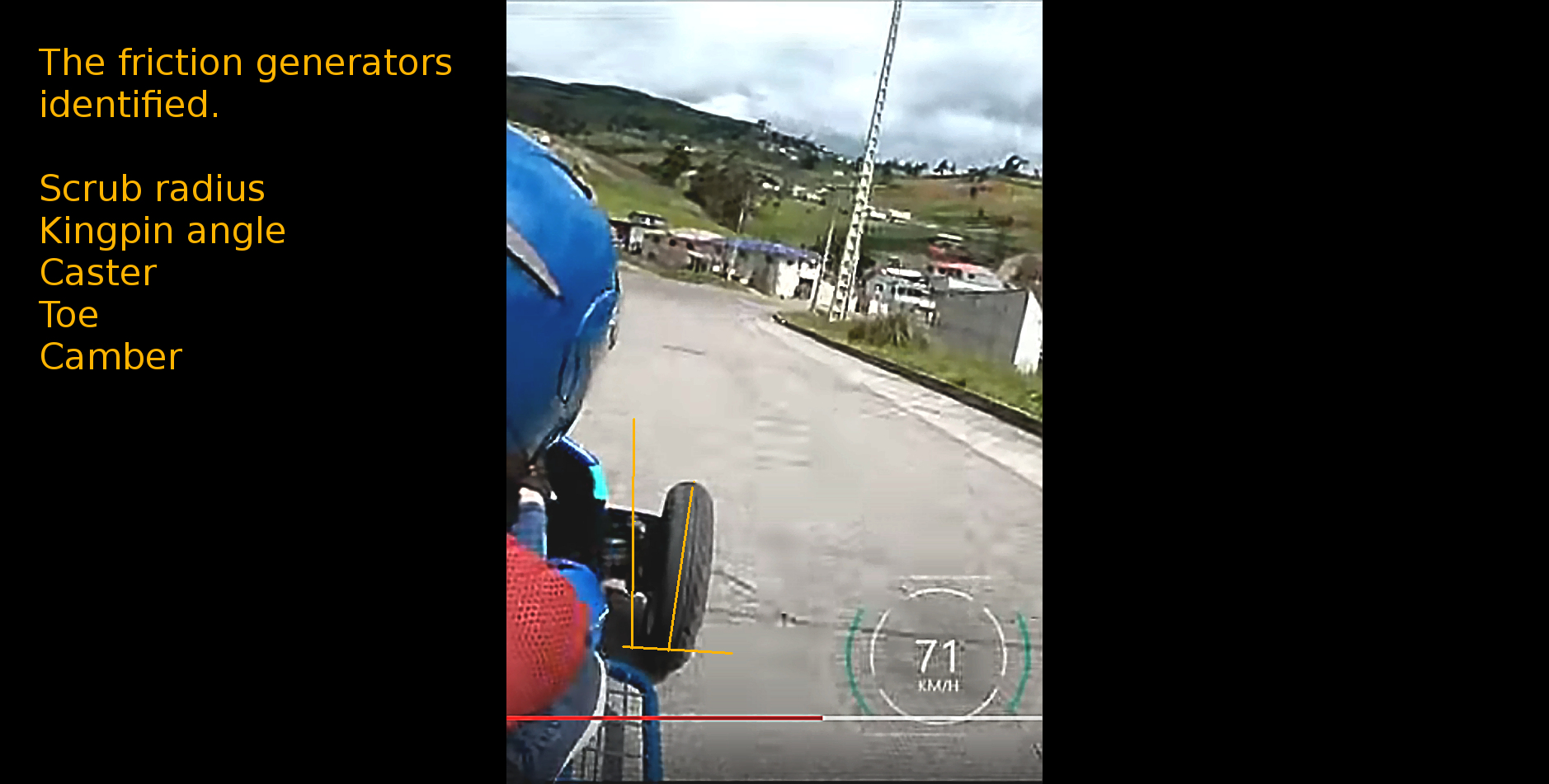

Time: 1:10
Like driving with the brakes applied, but it's just incorrect front axle geometry.
Time: 6:20
Those guys are out of sight.
The other thing, Ackerman tie-rod angle.

The steering geometry factors are incorrect, generating frictional drag.
-0.5° Camber max
+1.5° Caster max
<-1° Kingpin Inclination
< +0.5° Toe-In
< 0.5", 14mm Scrub Radius
Redesign the Ackerman angles to correct gross toe changes.
Reduction of rolling resistance, maximize air pressure.
Use light oil in place of axle grease.
Reduce preload on bearings to minimum.
Minimize bearing diameter to practical limit.
Allow front axle to rotate about longitudinal axis of kart, rear axle centerline.
Reduce weight to minimum.
Make a smoother hole in the air, don't be hanging parachutes out into the wind.
Install wheel and fuselage aero devices.
