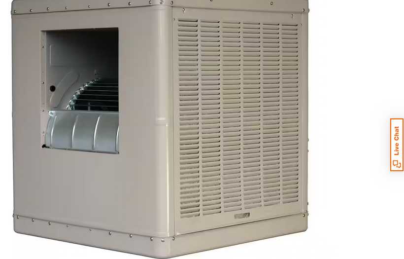

Rams, perhaps you might consider a "Swamp Cooler". It was all the rage before A/C. I had one in Bandera at the head of my picnic table outside in the Texas heat and the results were amazing. There are many different types. I had on similar to this :
Where you see the circular fan it has a snout which directs the air flow.
Read all about them here.
My Dad in North Florida had his shop insulated (some kind of foam which hardens) and a HVAC unit. If needed, he could
work in his dead of winter. Some times you have to.

Cliff, I grew up in a house with a "Swamp Cooler" in KS. As a child it was my job to refresh the cooling water with a garden hose daily during the months it was used. Nope, have researched and had the options quoted, have decided on two 110v window units. Mostly based on how I intend to use my shop and the cost of the other options. Already have two large ceiling fans mounted and powered. The walls have been foamed with two inches of closed cell insulation, the ceiling is two and a half inches of the same closed cell foam. Both walk-through doors are insulated and so is the garage drive through door. While I could always be wrong, I believe I have made the best decision for my needs.
In fifty years, the next person using my shop can change things if he/she needs to.

... As a child it was my job to refresh the cooling water with a garden hose daily during the months it was used.
Rams
Just a suggestion Ron. Mine had a hooked up water supply line which had a float valve such as a toilet does.

Understood and the response is appreciated.
