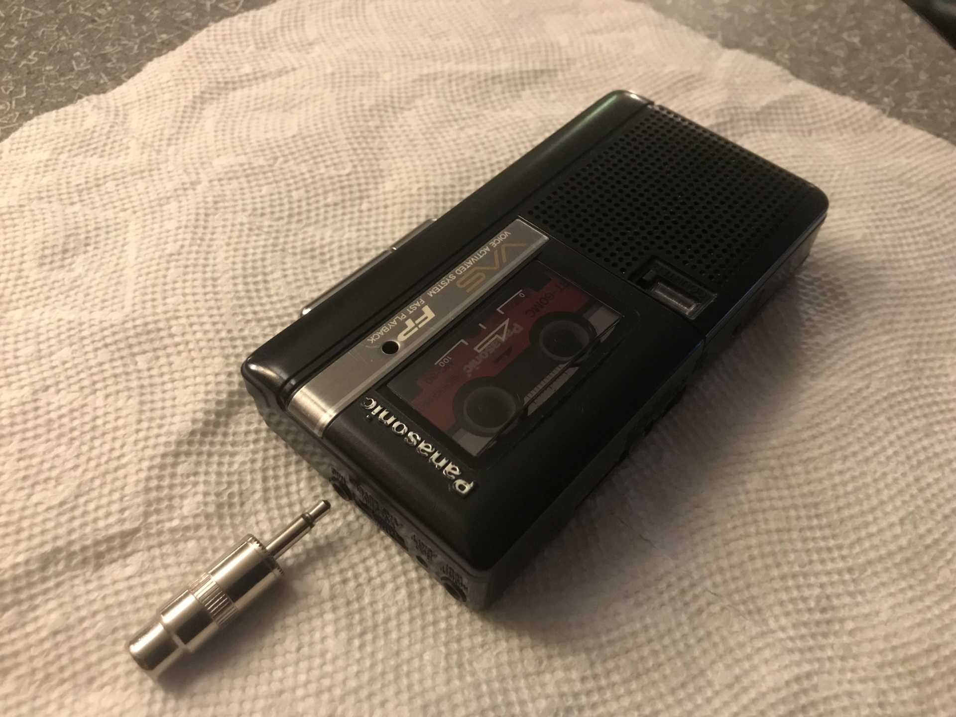

After seeing your pic of the attenuators, I realized I might have one in my adapter drawer. Yep, I think this it, right?
On another note, as others have suggested, input voltage through the mic jack eas something I was warned about. I’m just going to do some experimenting and we will see how it goes, heh?
I mean, that’s part of the fun...going down a road few have trodden or even cared to, for that matter.
Will update after I do a few random recordings from various reel to reel decks and cassette players. Thanks, Kit
No... I suspect what you have there is just an adapter (from one plug type to another). You need an attenuator... to reduce the voltage. The RS device I described and pictured is an adapter and an attenuator combined.

Report this Post01-24-2021 10:09 PM Click Here to See the Profile for KitskaboodleSend a Private Message to KitskaboodleEdit/Delete MessageReply w/QuoteDirect Link to This Post
You mean an attenuator has a built in resistor or some kind of filter? Yes, you’re right, mine is just an adapter. Well, at least I’m moving in the right direction.
