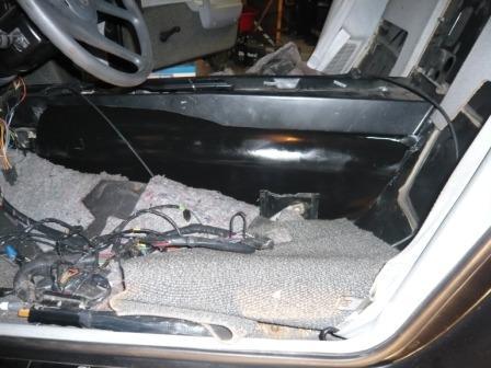

Much like the V8 conversion I did, I wouldn't expect to convert a Fiero into and EV and not modify it.
There would be a lot of modification and fabrication needed. I watched the video of the guy that is doing Tesla drive train conversions and saw two. One was 450 HP and one was 600 HP.
Both required extensive reinforcement to the subframe.
Remove as much weight as possible.
Start with
Fuel tank and center console
Engine and transmission
Radiator (depending on what options you want there may be a need for a radiator)
Unless you are looking to keep the feel of the standard shift transmission you would want to use the same transmission currently used in most EV
Fuel tank, you wont need that anymore.
Center console, with the frame you would need to install to support the instant TQ of an electric motor you could remove the center console and replace it with a tube frame. You could also gain the firewall space behind the seats.
Both of these could be used to put battery packs in and have access by installing removable panels. The firewall could be extended into the engine compartment as well to give more room for batteries.
This would also give better weight distribution over filling the trunk and front compartment.
The coolant tubes could be replaced with a tube chassis to tie the front and rear frames together to help with strength after removing the center tunnel structure.
