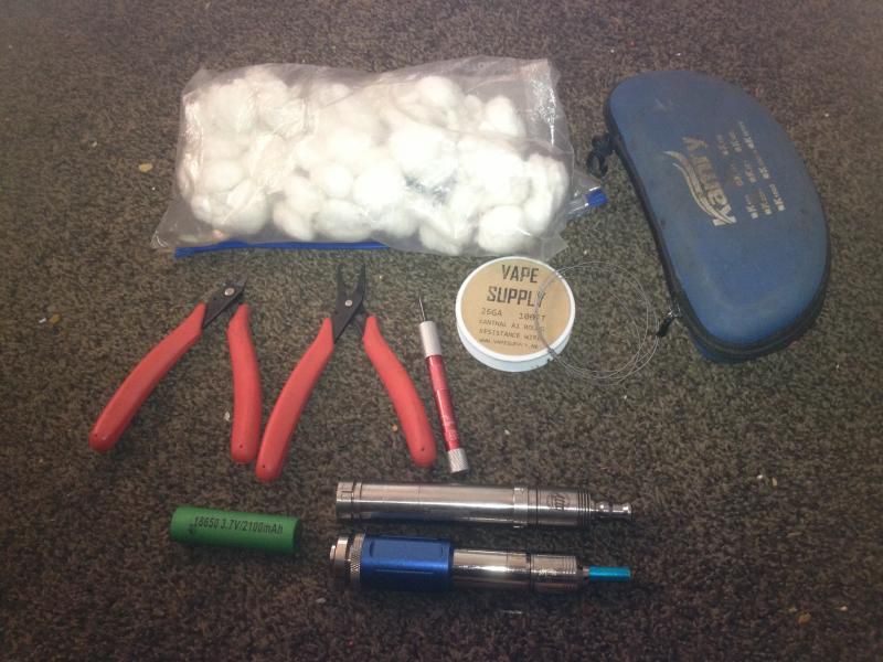

This is my 2 mechanical mods. The all stainless is my Chi-You with Tobh atty (my daily vape). The blue and chrome is my Kmary K100 with Nimbus. That one I use for playing around with different coil builds like the stove top coil. I have my roll of 26 gauge Kanthal and a some of it twisted that I made also. There's my screwdriver that I use to put the coils in and wind the coils around, my nippers and my pliers I use to compress the coils when I heat them up before putting cotton in. You have to heat the coils to red and then compress them or space them out, depending on gauge and what you like, so they both heat up at a similar rate. Otherwise you'd always have one side getting hot and burning the wick and the other side not vaping the juice as well. Oh and of course my bag of cotton used for wicking and one of my Sony VTC4 18650 30 amp high drain batteries.

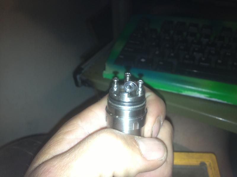

This is my wifes, but she wanted it recoiled.

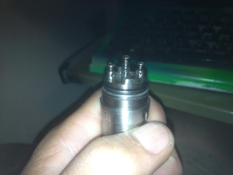

Here it is with the coils removed and you can see the binding posts and how deep of a juice well it has. If you look at pics of a Nimbus you will see it has a much shallower well for juice. Plus, if you look closely at the right post, you can see the 2 outer posts are machined into the base. This means those 2 will never twist on you like they can on the Nimbus. The center one is still connected with a screw and insulators, so it can twist, but I've never seen one that wasn't.

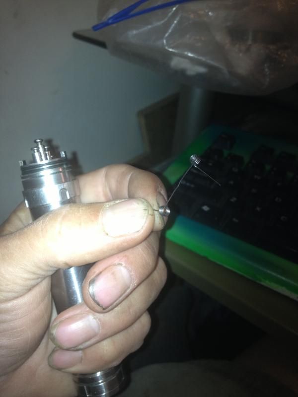

This is some coils I wound around the tip of my screwdriver for my daily vape build.

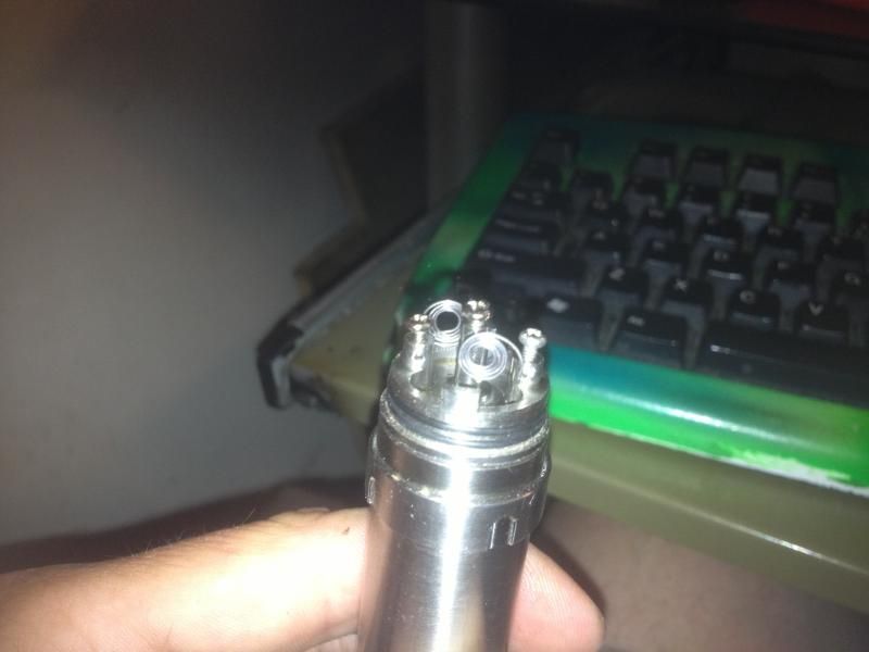

Not the best pic, but here's both coils in.

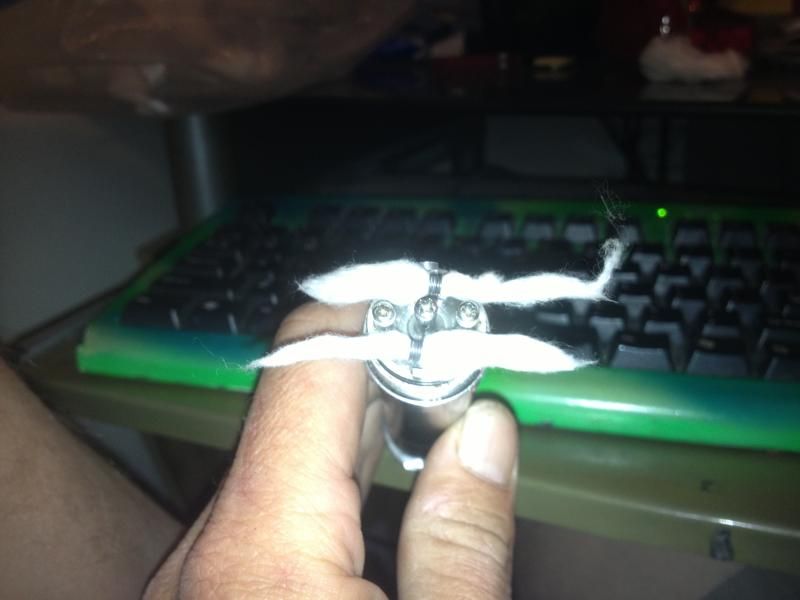

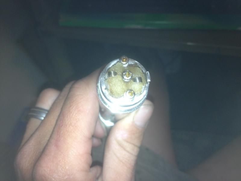

Cotton wick ran through the coils.

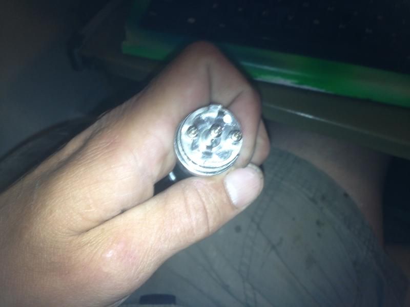

All tucked in.

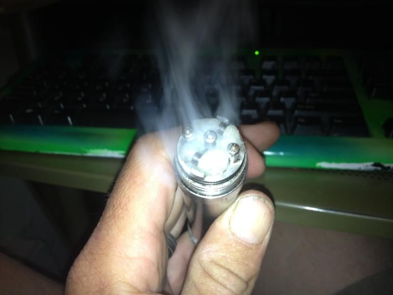

After wetting the wick with juice, a quick test fire before using it.
Also, I use my multitester to check the ohms of the build. I didn't take any pictures of that but this one was .4 ohms.
Really, it's not hard to do and you can add a coil or 2 if you want a cooler vape or you can go bigger diameter on the coil or smaller. They have macro coils, micro coils, figure 8 coils, clapton coils, inception coils, verticle coils, twisted coils and a myriad of other possibilities. It helps to understand ohms laws so you have an idea what your build will turn out to be ohms wise. You don't want to end up with a direct short although I've seen builds as low as .2 ohms (almost a direct short). I've seen builds using anything from 22 to 38 gauge kanthal wire. The thicker the wire though, the more coils you need to make enough resistance for it to be usable. Every weekish, I have to pull the cotton out and burn off juice build up from the coils and replace the cotton. It's not hard to do, and depending on how I am feeling at the time I will either clean it or just rebuild it. Really, I think the coils would last a month or so if I cleaned them every week, but I find myself rebuilding it every second or third cleaning.
