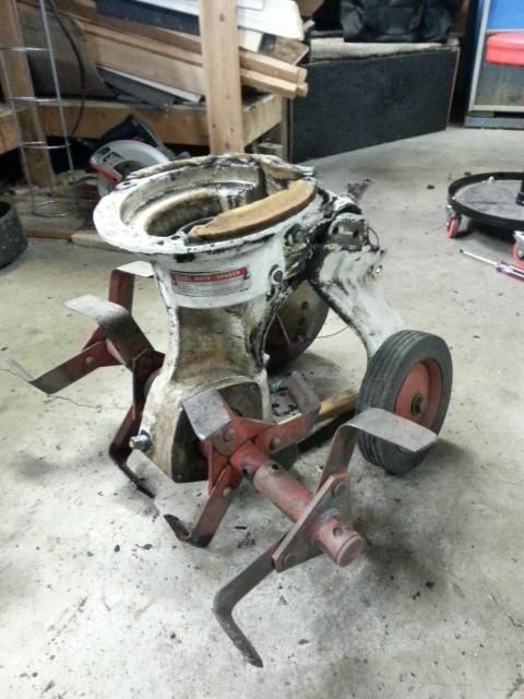

So I'm finishing up the restore of an old Sears roto-spader (as they call it).
Bottom half separate from the engine, takes its own oil. When I pulled the plug, what came out looked like chocolate syrup, thicker almost. Any idea approx what weight would work best? As for quantity, should it be enough to reach up to the cone for the clutch? Or less so?

Model number 785 50221. Nothing comes up on the Sears website (not surprisingly). Heres a photo of the bottom half

may or may not help... a manual for a similar model:
http://www.mediafire.com/view/?g6uaajjwvwadnnc
Says to use SAE 140 Hypoid Oil... so a 85w-140 gear oil I would think.
Fill to the bottom of fill plug hole, it looks like.

Damn that bottom half is nearly the same, so close!
It seemed like there was a lot more in there than just up to the bottom of the plug in the trans..... hmmm...
Thanks for the info guys, I'll have to post a picture when it is back together.
Yeah, I am guessing they didn't understand that the gear picked up the oil as it rotated and it doesn't need to be filled to the top. Similar to the rear diff in a RWD vehicle.
