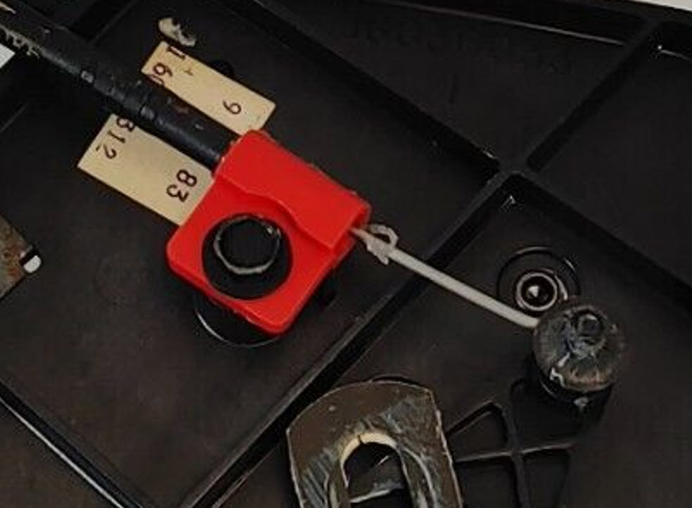

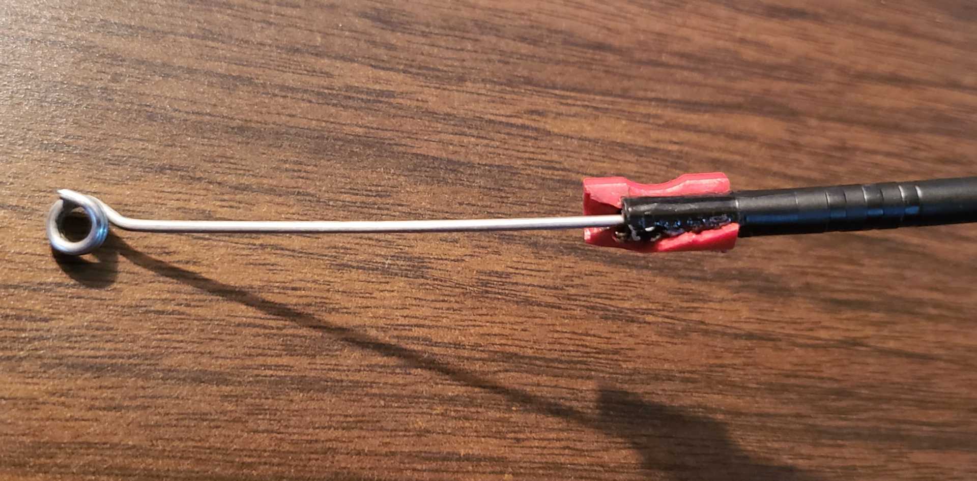

Need a nice temperature control cable for my '88 GT... or a how to repair thread for the end at the HVAC control head. Due to an improper cable routing years ago during a heater core replacement, the screw mount clip on the controller end of the cable broke off.
The cable overall length eyelet center to eyelet center is about 37" with a 32 1/2" long jacket.

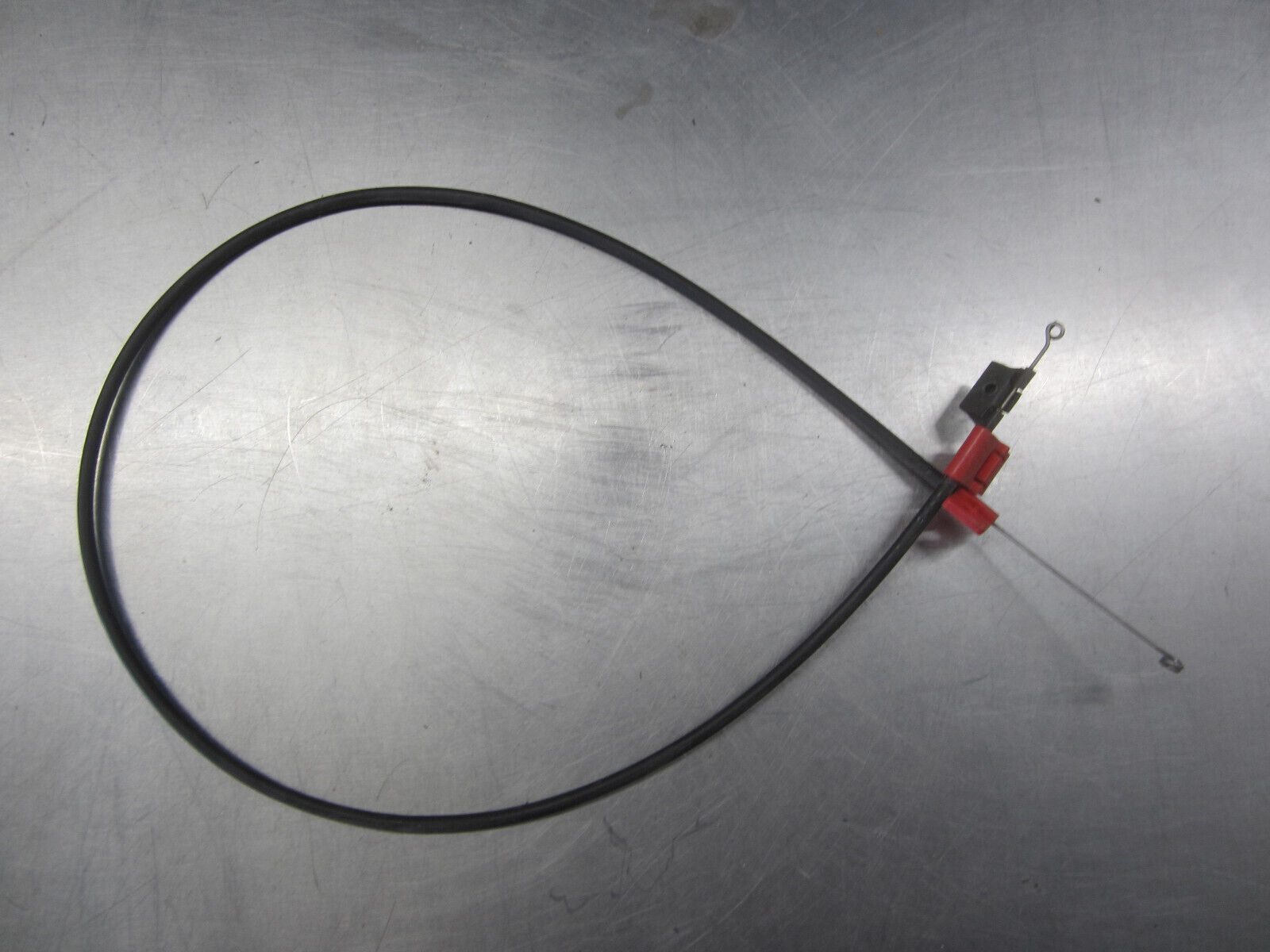

In the 22P catalog calls them "BOWDEN WIRE REPAIR" / GM 6258364 Cable Assembly, Special
Obviously, you want a RED, not blue or green {they're the same p/n}
On eBay, I saw a green but not a red...
EDIT - look at the GM 6258364 Cable brackets on eBay; perhaps you can find one to repair your cable...
