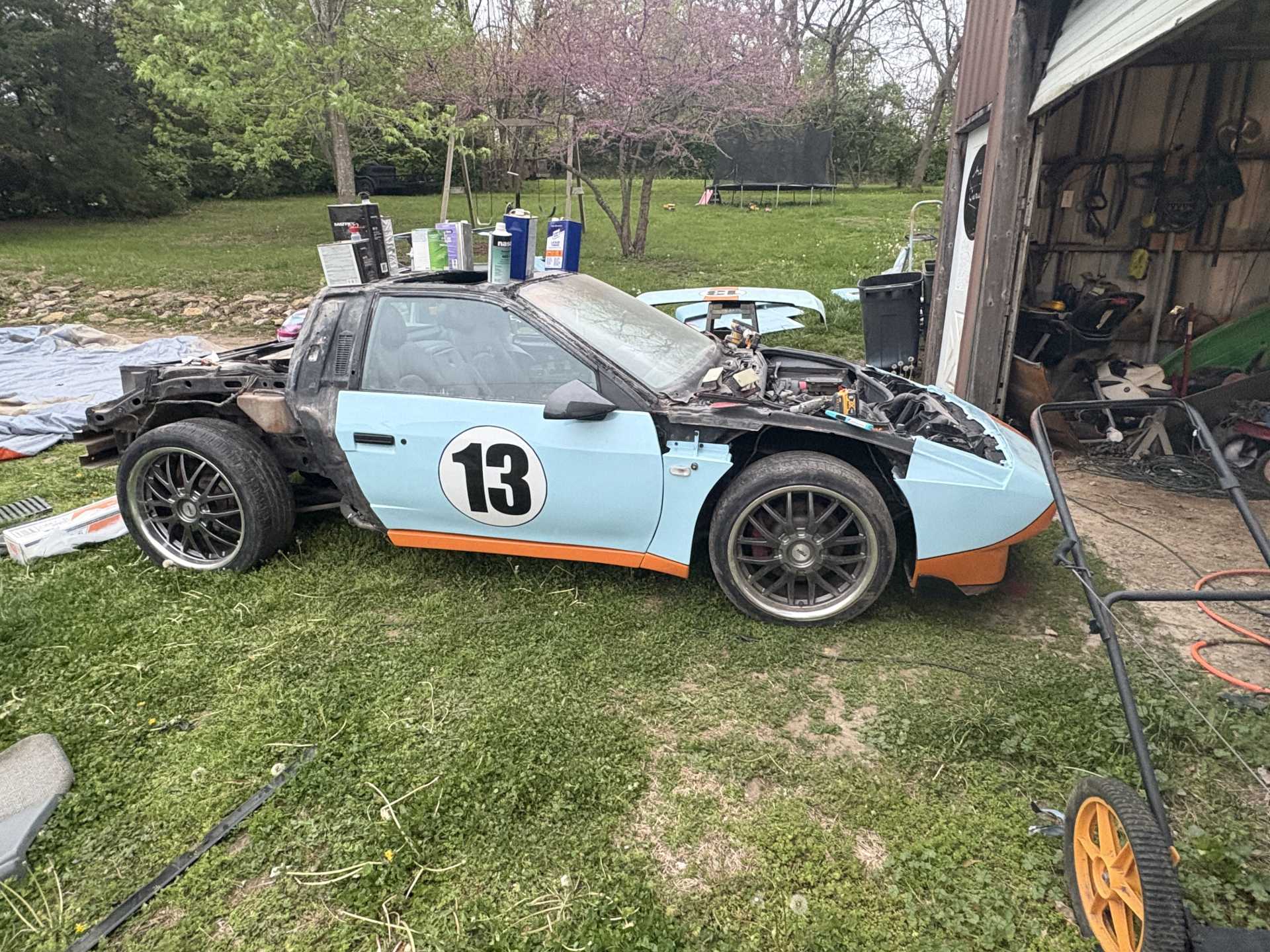

Just say the panels on the car for now while working on the rear.
[This message has been edited by Awalker W02 (edited 04-16-2025).]

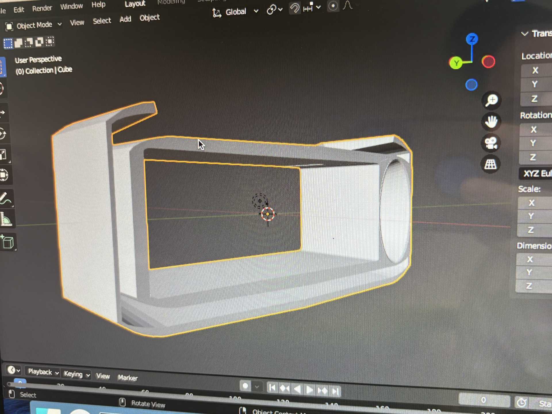

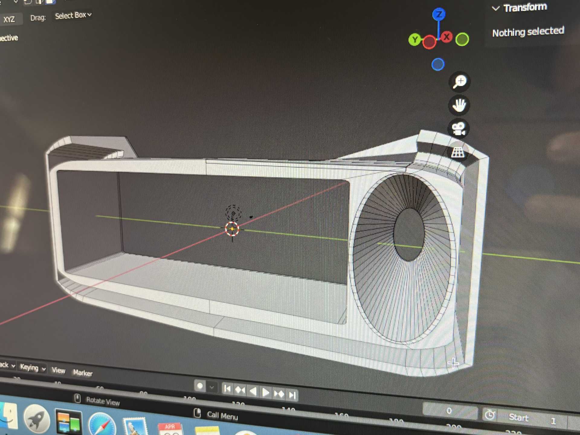

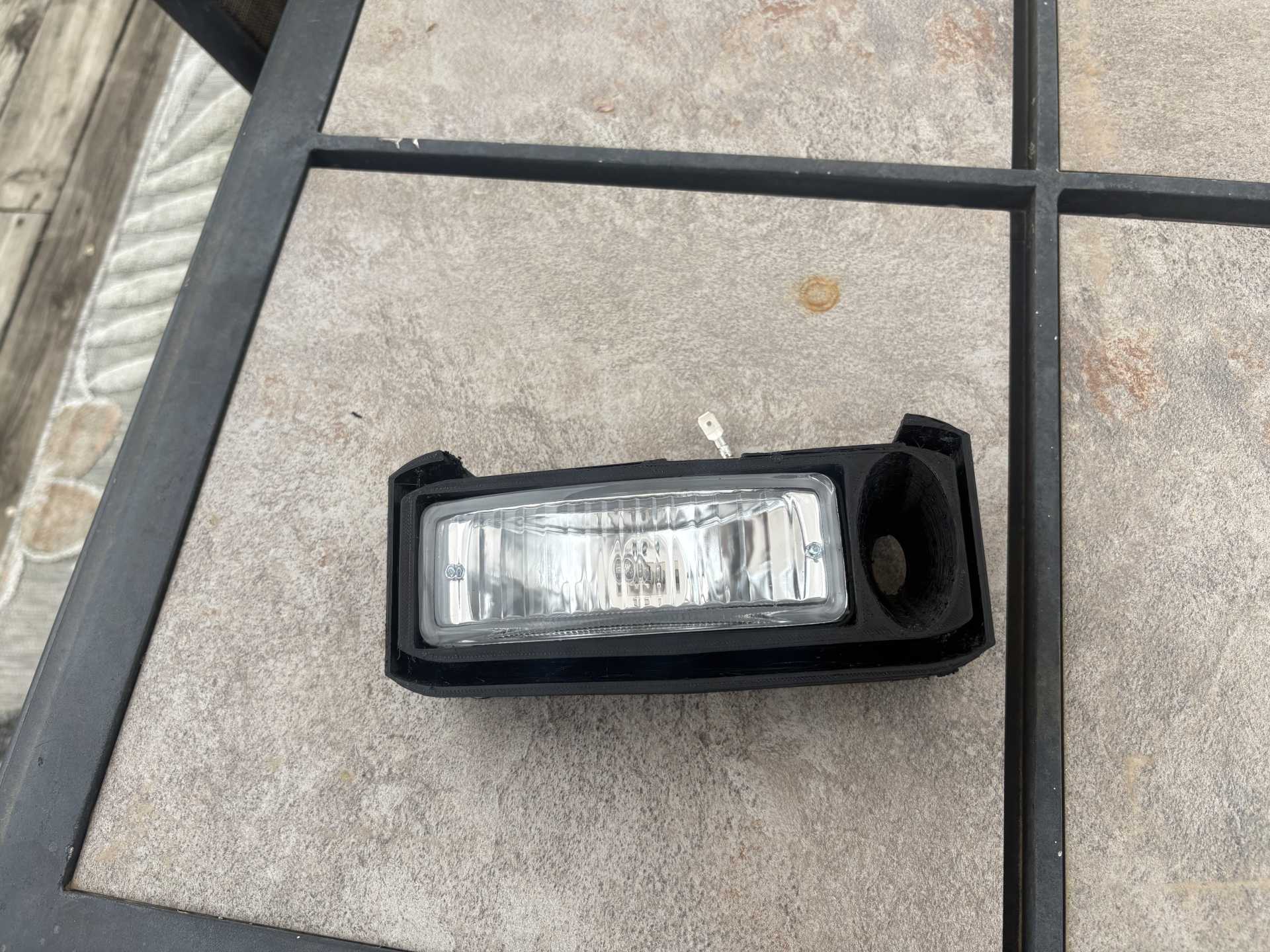

Did some drafting this weekend. So this is going into the front holes for the turn signals. It will house a fog lamp and a turn signal. It will mount to the bumper and eliminate any gaps that the factory set up had.
[This message has been edited by Awalker W02 (edited 04-22-2025).]

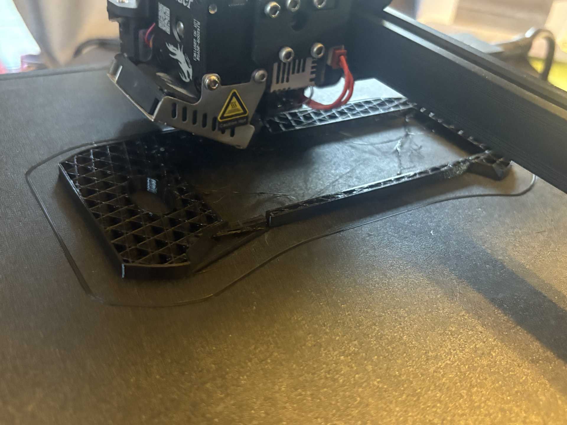

Print is done after many trial and error
[This message has been edited by Awalker W02 (edited 04-24-2025).]

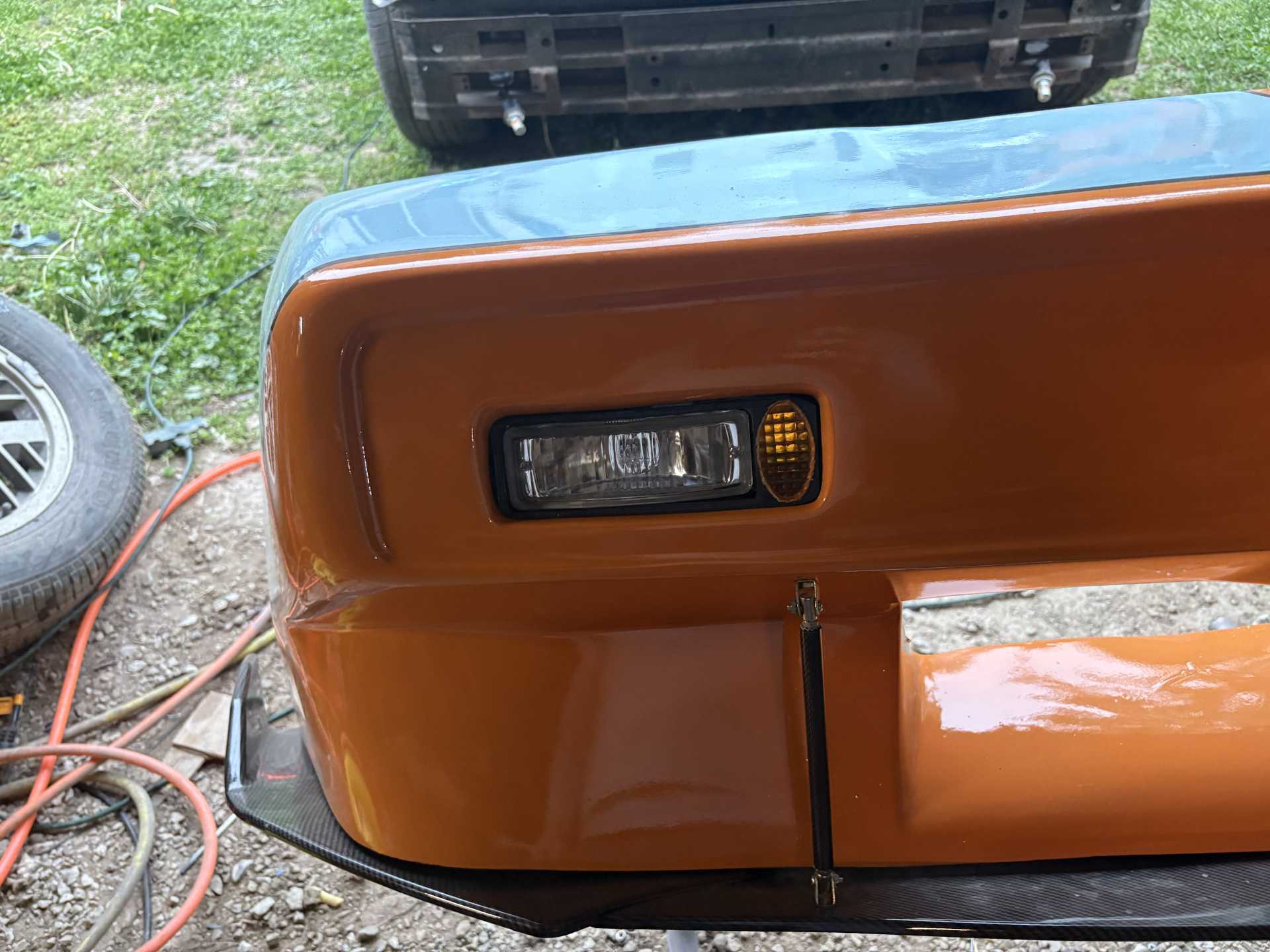

Did some more work. Got the turn signal lens in and the bezel mounted. Now on to the next side.
I started building the doors as well
