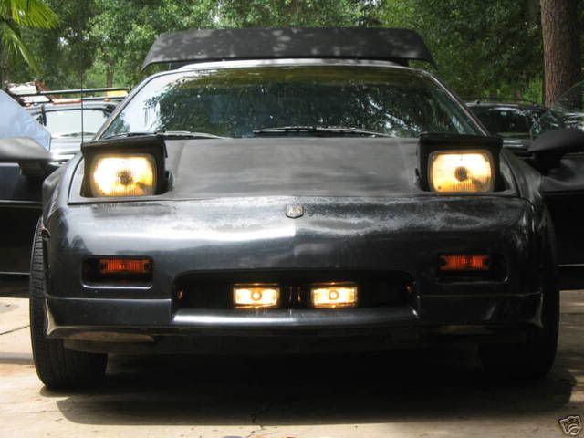

I've got a suggestion. Those fog lights look out of place. The last owner of my Fiero put some rectangular ones in that almost look stock:
