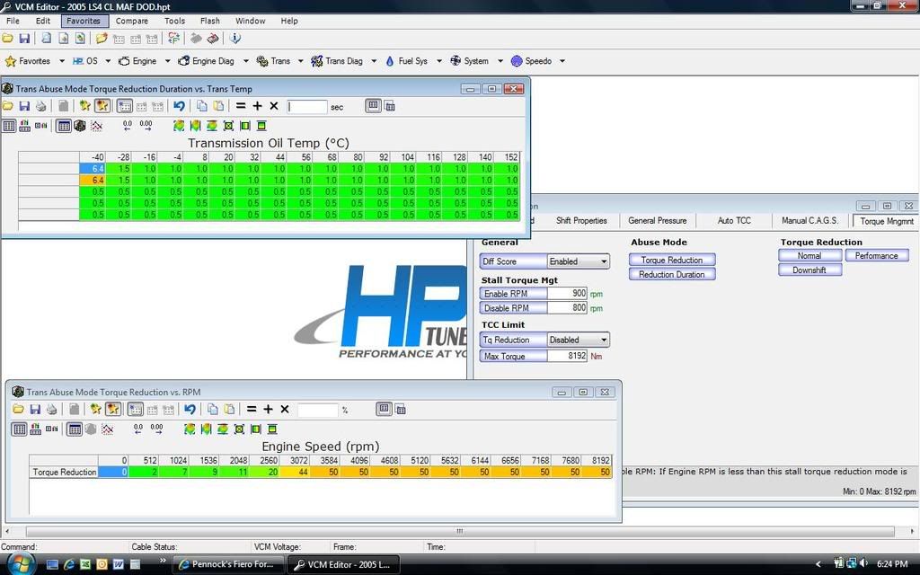

I've never heard of the LS4 4T65e-HD popping into neutral, I suspect your launch issue is traction control kicking in. The stock tune controls wheelspin by both retarding timing and slamming the electronic throttle closed - it's even more severe when you are going around a corner and the differential score protection kicks in. Feels like something broke in the drivetrain, or you hit a brick wall .
Here's a shot of the TCS settings disabled in a 05 GXP; these settings might help your launch issues.
Due to the strong torque at low RPM of the LS4, the W-bodies have to launch at only part throttle - Load up the torque converter to 2000 RPM and slowly roll into the throttle. In a W-body it takes nearly 2 seconds to go WOT or the tires just light up, should be a bit better in a RWD application. The best 60' I've heard of in a LS4 W-body is 1.8 with drag radials and a sticky track, you're already there with street tires.

First I would just like to clarify, It is not kicking into neutral when this "limiter" is active. It's just closing the throttle momentarily when it sees exceesive wheel spin. ALL Traction Control parameters have been SHUT OFF in the programming via HP Tuners software. But I don't think this problem is related to traction control, because it acts much different than the '06 GXP I drove with traction control on. When the typical traction control system cuts in, it limits engine power but will still allow the car to accelerate (although at a greatly reduced rate). What blkcofy's car is doing is basically cutting ALL power, not just limiting it (effectively returning the engine to idle) for a moment and the car just seems to hang there in current speed and not accelerate at all. If you stay on the gas, after this second expires it lets the throttle open full again. However, if you lift off the gas and then get immediately back in it, then it will go without delay. (if the wheels spin again the limiter will kick in again) NOTE: If you are on a very grippy surface and the tires don't break traction, this limiter will NOT kick in. However, if you are on a very slick surface such as a smooth asphalt road in wet conditions, and the tires spin at will, then the system will kick in more quickly (as soon as tire spin is detected).
I believe what is going on here is some kind of abuse mode is kicking in. Now I will admit I didn't think to try adjusting the diff score parameter as you suggested, TiredGXP, -- I will have to get with blkcofy and try that.
Now there are some things I tried and HP Tuners suggested we try in the programming that did have some effect on what is going on with this "limiter". I went in and maxed out the ETC (electronic throttle control) opening limits in the programming myself and also tried some HP Tuners' suggestions for this same table. The abuse mode still kicked in after making these changes, however instead of closing the throttle to cut engine power, it LEANED OUT the fuel to very dangerous levels while the throttle blade stayed wide open. I didn't care for this happening because it could obviously hurt the engine, so I put the ETC limit tables back to stock for the time being. Looking thru the rest of the tables HP Tuners has to offer, I did find a limiter function that was "acceleration" based. I tried all sorts of different settings in these tables but nothing seemed to have any impact. (Keep in mind this is still a relatively new system in the aftermarket tuning community, so it may take a little bit of time before all necessary tables are found and defined in the tuning software).
Rest assurred I will find a solution to this problem; even if that means hooking the ABS computer up in some kind of limited capacity just to satisfy the needs of the ECM. In the meantime (while I am waiting on HP Tuners to come up with something), I have called on some of my contacts in the GM community to see if I can get any answers there. So I am still working on this problem outside of what HP Tuners is doing. And I do have a couple more things I would like to try, not only changing the diff score values as TiredGXP suggested, but also some other things that I thought of while staring endlessly at the tuning software. So I will have to get with blkcofy in the coming week or weeks to give these changes a shot.

No I don't have the ABS module in the car; didn't have the opportunity to get that from the donor car either.
As far as inputs are concerned I can pull up some data on my GM Tech 2 scan tool that the ECM gives that actually displays non-driven wheel speed, and this always says "0mph" because no ABS module nor wheel speed sensors are present (there is no wheel speed sensor input to the ECM but rather the ECM gets that info over the Class 2 data circuit from the ABS module). But this doesn't seem to impact driving or engine power output as long as traction is good. I don't think the problem we are having has anything to do with the ABS system or Traction control. But rather I believe it has something to do with what TiredGXP brought up about the diff score or something else that is some kind of abuse mode or transmission protection that is acceleration-based.

I was thinking about your comments about wheel speed, and noticed that all my wheel speed DTC's (C1207 to C1256) are set to "3-no error reported" from the factory. Whether that means that differences in wheel speed are actually ignored is another question that I don't have an answer to.
Just downloaded Version 2.22 of HPT yesterday, and noticed that transmission abuse mode tables have now appeared for the LS4, wonder what zeroing out the duration table will do for this issue, or have you already been there?
Since I still have a long-term plan to transplant a LS4 into a Fiero, I hope you lick this issue. Keep up the excellent work!
Cheers

Report this Post04-25-2008 10:20 PM Click Here to See the Profile for Darth FieroClick Here to visit Darth Fiero's HomePageSend a Private Message to Darth FieroEdit/Delete MessageReply w/QuoteDirect Link to This Post
Originally posted by TiredGXP:
Darth,
Cheers
Yea I just noticed that update as well and am downloading it now. Will see what more can be done with it.
-ryan

Report this Post05-03-2008 09:10 PM Click Here to See the Profile for Darth FieroClick Here to visit Darth Fiero's HomePageSend a Private Message to Darth FieroEdit/Delete MessageReply w/QuoteDirect Link to This Post
Just a quick update before I head up to the lake... I met with blkcofy today to try the new tune (with some changes per advice from TiredGXP) and that took care of the power cut issue. He can now burn all the tires he wants =P (at his own risk, of course!). I will go into greater detail exactly what was changed later when I have more time...
-ryan
Darth Fiero
Posts: 5922
From: Waterloo, Indiana
Registered: Oct 2002
Total ratings: 361
Report this Post05-05-2008 01:34 PM Click Here to See the Profile for Darth FieroClick Here to visit Darth Fiero's HomePageSend a Private Message to Darth FieroEdit/Delete MessageReply w/QuoteDirect Link to This Post
Ok, now that I'm back from the lake I have some time to explain what was done to blkcofy's tune.
TiredGXP suggested I disable the "Diff Score" function. According to most people I have talked to and many threads I have seen on the internet, this function serves to limit engine power if one drive wheel starts spinning much faster than the other wheel (like what you have on a 1-legged burnout). If this were allowed to happen, the pinion shaft that the differential gears ride on inside the differential could begin to score due to high loads and lubrication breakdown. One of the many flaws a front-drive/transverse transmission suffers from is the type of fluid it uses to lubricate internal parts. ATF has poor lubrication properties comparied to your standard 80-90w gear oil used in most rear axles (in RWD cars). And ATF doesn't hold up well when subjected to high loads or stress. Therefore GM built this function into many of their newer computers in an attempt to "save" the transmission. In this swap, the ECM shoudn't be able to determine if one drive wheel is spinning faster than the other because no individual ABS wheel speed sensors (nor the ABS computer) are installed. But I just went ahead and disabled it because it was easy to do.
I also went into the programming and disabled ALL of the Transmission Abuse Mode torque reduction functions. This is the function I believe was kicking in when the ECM saw the VSS output climb at very fast rates (IE what would happen when the tires were spinning). All of this seemed to do the trick in blkcofy's car.
Now with that problem solved I was also able to go in to the programming and max out the ETC (electronic throttle control) opening limit tables. The stock tables only allow the ETC to open to a certain point depending on engine RPM and desired engine TQ. Maxing out the values in this table made the engine seem more responsive off-the-line. I was not able to max these table values out before with the trans abuse mode kicking in because it caused the ECM to lean the fuel out severely instead of closing the throttle in an attempt to limit engine power (and that was very bad on the engine).
So needless to say the car does feel more responsive off the line now. Hopefully next time blkcofy goes to the track he can get some better traction on the launchpad which should allow him to post some better times.
-ryan

Report this Post05-30-2008 05:20 PM Click Here to See the Profile for FogSend a Private Message to FogEdit/Delete MessageReply w/QuoteDirect Link to This Post
Darth, the way ECM detects it is by checking the speedo vs rpm. If that don't divide by the gear ratio, then one of the wheels are slipping, since the VSS sensor is actually on the pass side half-shaft. It also sees this, while cornering at low speeds (1mph drivers side, 5mph pass side, VSS sees 5mph but actually the wheels should rotate 3mph both, so +66% diff.)
There's also the tc that affects the ratio, but there is code to detect that somehow. I think it is by assuming on the TCC lock % that the HD box has.
Fog.

Report this Post06-01-2008 02:39 AM Click Here to See the Profile for Darth FieroClick Here to visit Darth Fiero's HomePageSend a Private Message to Darth FieroEdit/Delete MessageReply w/QuoteDirect Link to This Post
Fog.
No, the VSS reads the reluctor wheel that is attached to the differential housing. So it has no idea which wheel is spinning faster in a one-wheel slip condition - for that it would need individual wheel speed sensors. But like I said in a previous post this "power cut" problem when excessive wheel spin was detected has already been solved -- it was the trans abuse mode kicking in and I disabled all of that in the programming and it took care of it.
