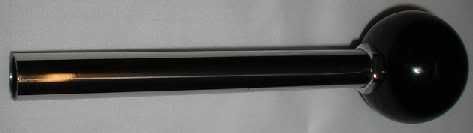

Thanks, I don't want to steal this thread but that is a must have, but at 149 euros not exactly cheap.

Solution for all problems .
I thought about the switch technic too , but this will never work right !.
The are easyer ways and low budget to make it work 100000 years
very excact work +++
but wouldnt go confirm with my intention to create some Space where i can stuff my things into.
btw. i tried the magnetic switches already and the distance (magnet <-> sensor ) required for them to work proper is ok.
i will fix the magnet on the shifterarm and the switches on the right side .

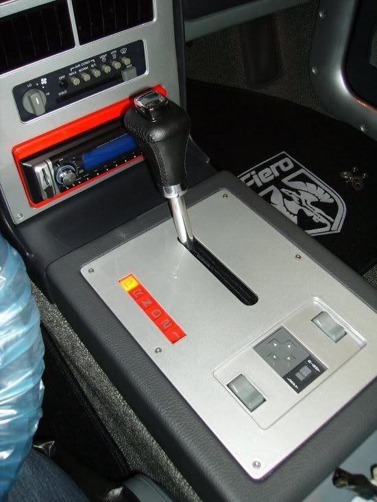

Report this Post04-29-2007 08:56 AM Click Here to See the Profile for FieromaniacClick Here to visit Fieromaniac's HomePageSend a Private Message to FieromaniacEdit/Delete MessageReply w/QuoteDirect Link to This Post
Fieromaniac
980 posts
Member since Nov 2006
ok took me a 2mm Alu plate and had some fun
further pics follow

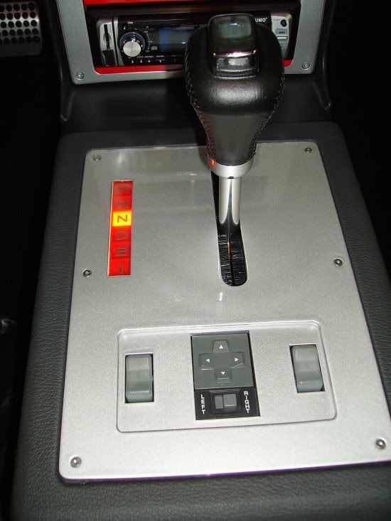

Report this Post04-29-2007 03:01 PM Click Here to See the Profile for FieromaniacClick Here to visit Fieromaniac's HomePageSend a Private Message to FieromaniacEdit/Delete MessageReply w/QuoteDirect Link to This Post
Fieromaniac
980 posts
ok iam done for today here latest pics

Interesting concept...but I don't think those cupholders are going to be too useful. Maybe you can get a 12 oz can of soda in there, but that's about it.
[This message has been edited by jscott1 (edited 04-29-2007).]

Report this Post04-29-2007 03:13 PM Click Here to See the Profile for FieromaniacClick Here to visit Fieromaniac's HomePageSend a Private Message to FieromaniacEdit/Delete MessageReply w/QuoteDirect Link to This Post
i have a 8cm Diameter for the cupholders = normal big coffeecup
max deep 5 cm

Looks great...but with the 2 round circles for the cup holders overlapping each other...can it hold 2 drinks at once?

You should put the shift nob on when trying the different cups/cans. Looks to me that there will be some interference. Looks great though! Any thoughts on puting some together for sale?

Report this Post05-13-2007 06:53 AM Click Here to See the Profile for FieromaniacClick Here to visit Fieromaniac's HomePageSend a Private Message to FieromaniacEdit/Delete MessageReply w/QuoteDirect Link to This Post
"created" some more space for the console
installed

Report this Post05-13-2007 08:53 AM Click Here to See the Profile for dcfoxSend a Private Message to dcfoxEdit/Delete MessageReply w/QuoteDirect Link to This Post
That looks really nice.
Just a suggestion...I think the logos are a bit too much.
I'd suggest getting some black craft foam and cutting inserts for the cup holder and the square compartments.
That should also eliminate any can rattling and/or any noise from stuff stored in the compartments...and to me would give it a more "finished" look.

you should replace that shifter with one of these from rodneydickman, it would give you more room when you have cups in there
