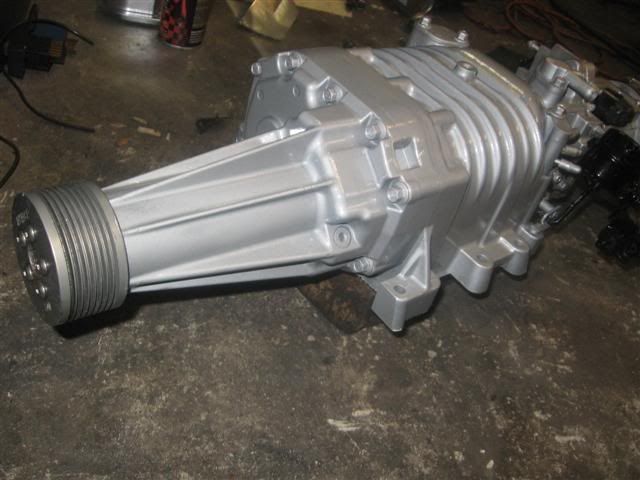

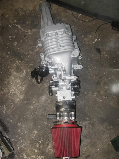

Heres some of the mods done to the engine
Stage II water/meth
Headers/ Exhaust
Tri-Metal Rod Bearings
Tri-Metal Cam Bearings
Chevitt77 Main Bearings
Bored .20 over
Forged Diamond plated Pistons
Gen 3 SC W/ Gen 5 guts
Ported SC
Ported lower Intake
#130 Springs
XPZ Cam
Tuned PCM
Custom made mounts
Lucas 42.5 Injectors
Stainless 3 Angle Valves
New Valve Seals, Retainers, and Keepers
Hydraulic Roller Lifters by Competition Cams
New Comp Cam bolts on all internals
New Valve Seals/Locks/Retainers
2.7 Pulley
Oil Cooler
Push Rods PRL-705 Lightweight
WCF CAI
Decked and Polished Heads
[This message has been edited by greengoblin0129 (edited 05-09-2007).]

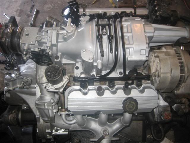

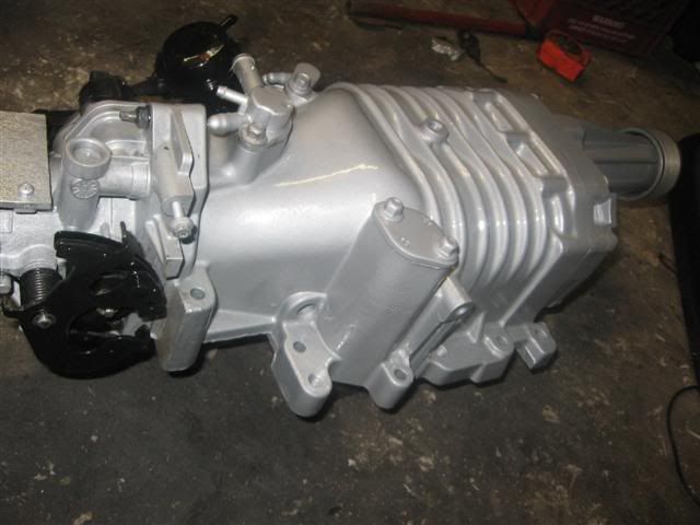

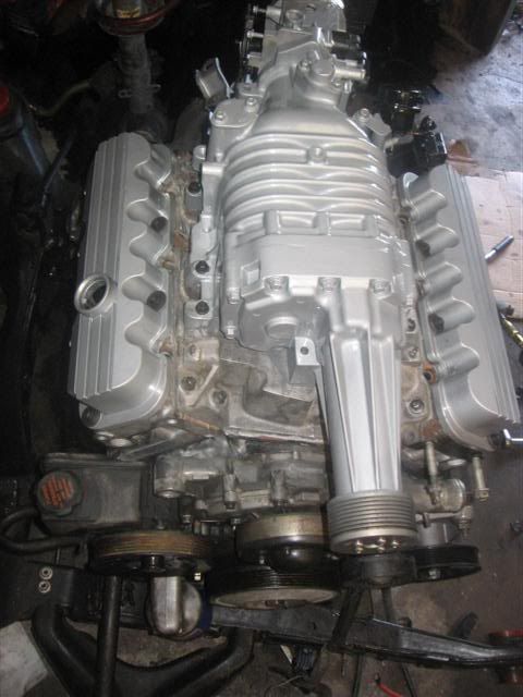

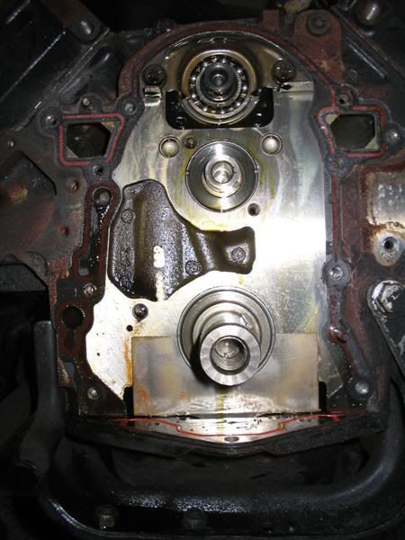

Got the motor to my house late last night! Today I took the timing chain cover off and found this
Timing chain with 4,000 miles snapped. What would be the best timing chain to replace this with? I'm thinking about going with a double roller. I have the whole weekend and monday to work on the engine, so hopfully i'll have more to post tomorrow! Can't wait to get this motor in and running. Think my step is to remove the heads and check the valves and pistons for damage.
42.5 fuel injectors
3.0 pulley

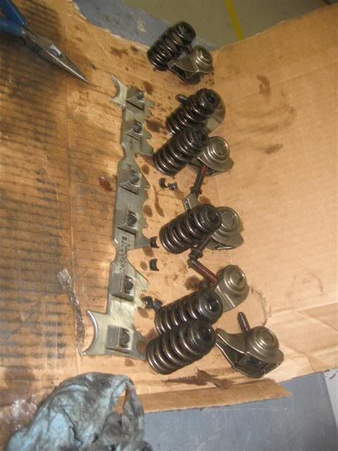

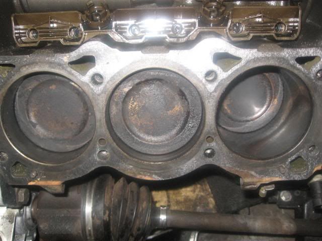

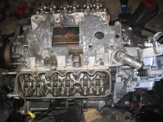

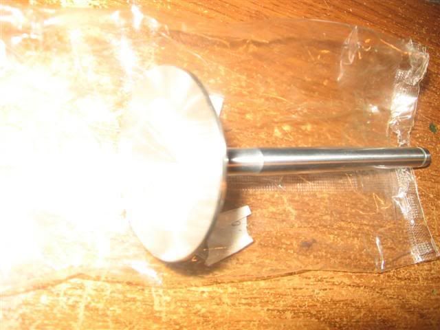

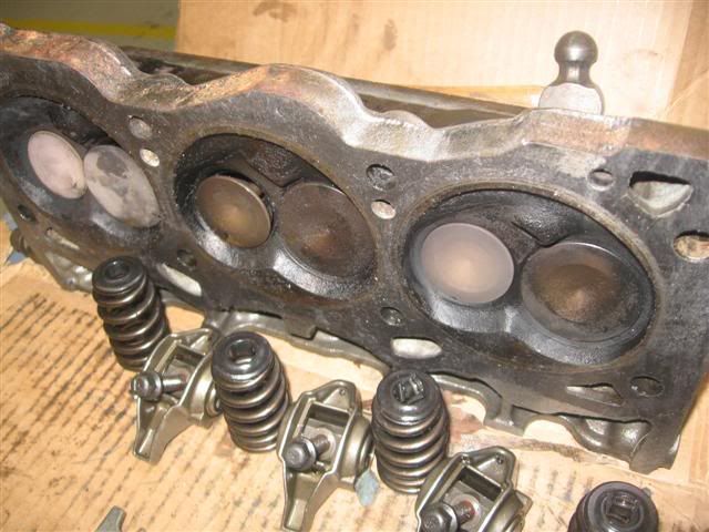

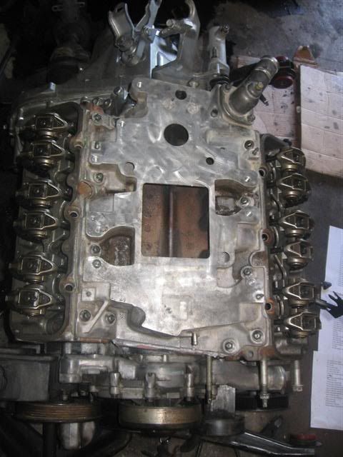

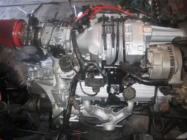

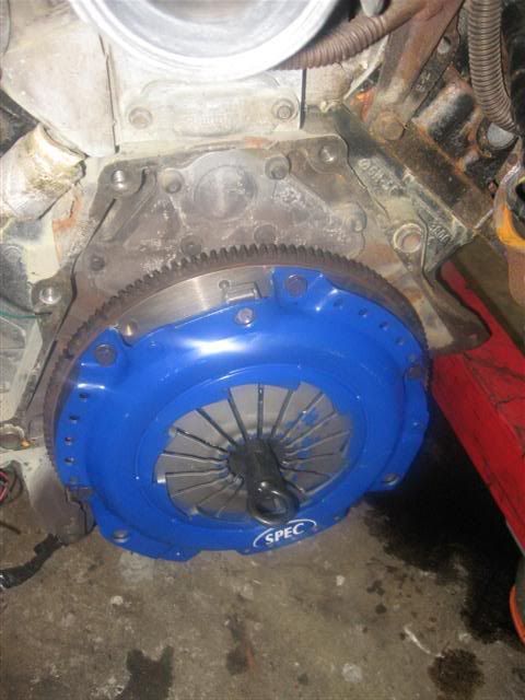

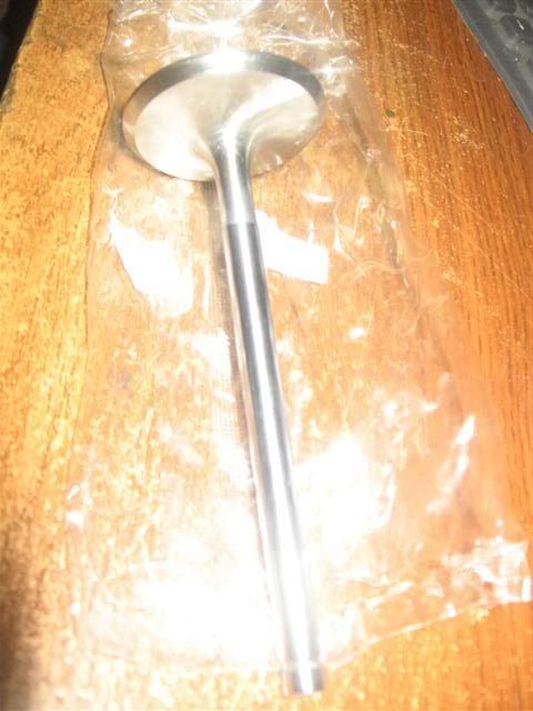

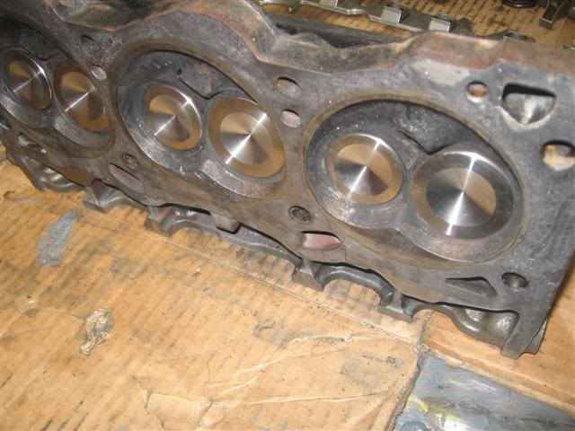

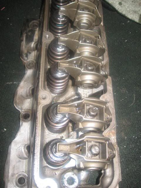

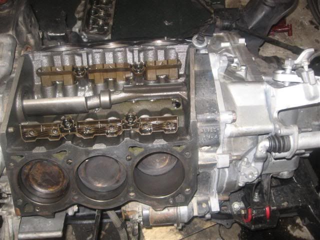

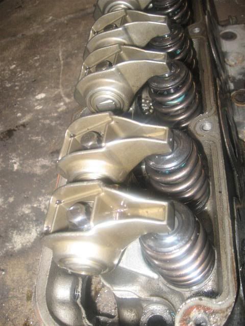

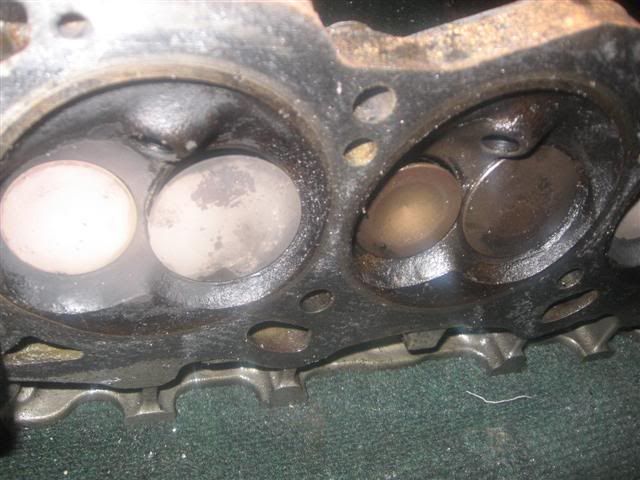

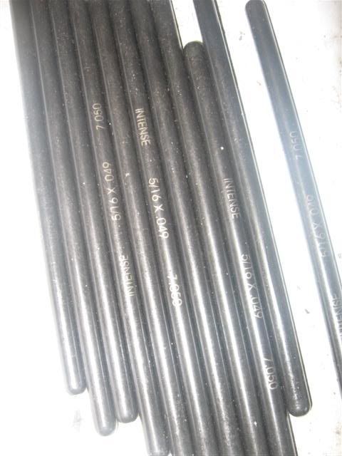

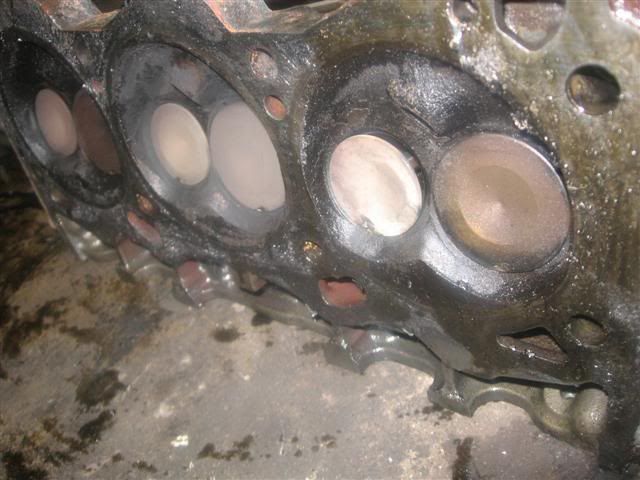

Bad and good news, mostly bad lol. I got my timing chain in from intense racing and installed, got the spec 3 clutch bolted to the flywheel and bolted the engine to the tranny. Bad news, I did a compression check that didn't come out too good. 3clys had 0 compression, one had 80, and the other two were fine. So I took the SC, lower intake, exhaust, wiring harness, coil pack bracket, and the alternator brack off so I could get the heads off. The valves barly hit the pistons, but hard enough to bend them. The pistons look fine, just scrach the ceramic coating on the forged diamond pistons. Heres some pics of how it looks so far
Spec 3 clutch
Timing chain
Pistons
Heads
Engine + tranny

Report this Post05-09-2007 12:53 PM Click Here to See the Profile for John BoelteSend a Private Message to John BoelteEdit/Delete MessageReply w/QuoteDirect Link to This Post
Ryan - That sucks! It's amazing how the valves need to be perfect, isn't it?! At least it's only valves.
Good luck!

Report this Post05-09-2007 06:14 PM Click Here to See the Profile for 86fieroEarlSend a Private Message to 86fieroEarlEdit/Delete MessageReply w/QuoteDirect Link to This Post
Bent valves will yield a poor compression check, Lobes worn off of a camshaft will do the same, Bent pushrods will as well.
I believe the double roller timming chain requires the removal of the balancer on top of the engine, The oil gulley that leads to the balancer needs to be plugged when you remove the balancer, Or you will have 0 oil PSI
I have spare L 67 parts if your insterested, I have every part except the block to a L 67, Meaning if I had a L 67 block I can build another L 67

Report this Post05-09-2007 08:32 PM Click Here to See the Profile for greengoblin0129Click Here to visit greengoblin0129's HomePageSend a Private Message to greengoblin0129Edit/Delete MessageReply w/QuoteDirect Link to This Post
The pushrods are in perfect shape . Pretty sure it's just the valves because you can see in the pics where some of them are sticking a half in out of place. Also the burn marks on the tips of them. After talking with intense-racing for awhile and getting more infomation, i'm running the rollmaster single chain. Only thing you have to remove when running the double timing chain is the gear on the balanceing shaft, not the whole shaft. Instead of plugging the oiling hole, you can just leave the balancing shaft in their. It's retained in their by the bearings so it won't float out from vibarations and hit the timing chain. At least thats how I understand it according to ZZP.
This is what I did. There is actually a plate that holds the balance shaft in place. Here is a pic of when I put mine in.

The plan right now is to get the motor put back together and into the Fiero on Friday! I ordered stainless steel valves from ZZP which should be here tomorrow! Heres a couple pics of the super charger I just got done painting up

God that SC looks great. There`s just something about silver superchargers that are so much cooler than other colors.
Please tell me you are not going to run your filter off the Tb like that. If so you will be introduced to Mr. Kr after about 20 minutes of driving.
greengoblin0129
Posts: 2671
From: Indy
Registered: Mar 2005
Total ratings: 102
Report this Post05-16-2007 10:59 PM Click Here to See the Profile for greengoblin0129Click Here to visit greengoblin0129's HomePageSend a Private Message to greengoblin0129Edit/Delete MessageReply w/QuoteDirect Link to This Post
I just put the filter on it to keep debry out of it. I have a WCF CAI to put on it still.

Report this Post05-17-2007 10:16 PM Click Here to See the Profile for greengoblin0129Click Here to visit greengoblin0129's HomePageSend a Private Message to greengoblin0129Edit/Delete MessageReply w/QuoteDirect Link to This Post
Got the vavles in!!!!!

I've got a ton of work done on the motor today! Yesterday I got my vavles installed, and got a SC & Head gaskets. I started putting the motor back together today. Heres the pics!

greengoblin0129
Posts: 2671
From: Indy
Total ratings: 102
Report this Post05-20-2007 08:50 PM Click Here to See the Profile for greengoblin0129Click Here to visit greengoblin0129's HomePageSend a Private Message to greengoblin0129Edit/Delete MessageReply w/QuoteDirect Link to This Post
Engine is ready to go into the Fiero!!!

Hey its looking good Ryan. Sorry i couldn't help today. Give me a call tomorrow if you still plan on putting in in.
