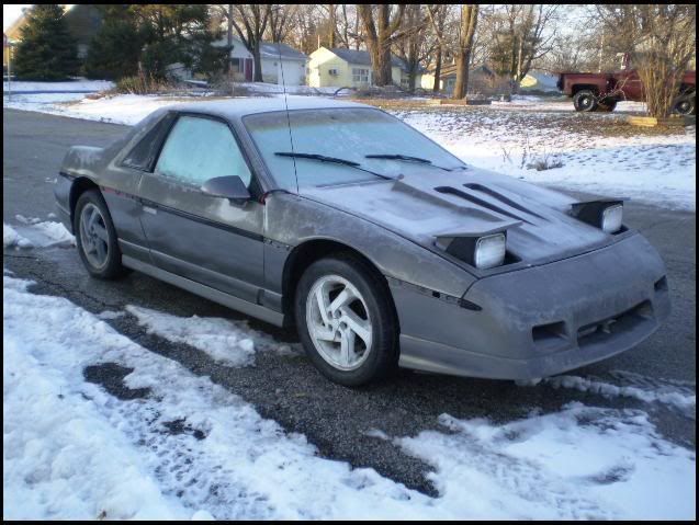

Good thing i have a place to park now that i cleaned my garage out, i hate having to park my car in the snow let alone drive in it, i put to much work into getting the rust it had off and i dont want to put it back on!. Alot has been going on i just havent posted.
Alot of the electrical problems are gone now. I moved the battery from the front, to the middle of my center console against the firewall and now my car starts everytime. The only real problem i have is after i shut it off it is hard to start again. I have a feeling its related to the coolant temp sensor. BECAUSE..."im extremely embarrassed about this"
I was a dumb as$ and forogot i didnt add coolant to the system and of course everything froze. Ive been fighting to get things unfrozen. I have a wood burner in my garage but it doesnt seem enough. Ive got coolant running through half the system now, the pasanger side pipes are froze ive got a karosene heater ill direct onto it, the engine heat should take car of the drivers side if it needs it, once everything melts ill try burping and adding coolant. I still cant belive i did this... Im happy i stil have all the freeze plugs in.

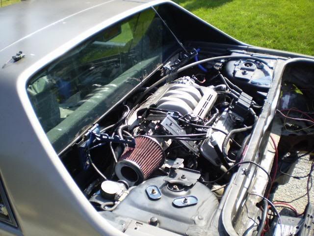

This car is so much fun lol. Everything is up and running
