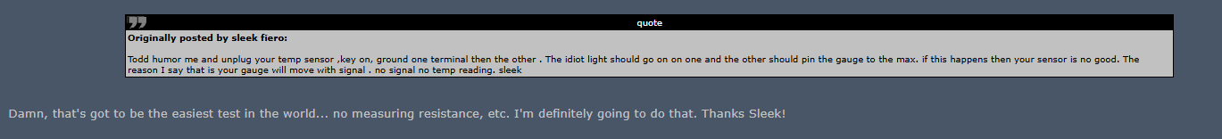

Todd humor me and unplug your temp sensor ,key on, ground one terminal then the other . The idiot light should go on on one and the other should pin the gauge to the max. if this happens then your sensor is no good. The reason I say that is your gauge will move with signal . no signal no temp reading. sleek
Damn, that's got to be the easiest test in the world... no measuring resistance, etc. I'm definitely going to do that. Thanks Sleek!
Sleek... you are wise beyond your years.
I did exactly as you said... I removed the plug, stuffed a paper clip in one end and ground it out to the frame on the other end... and did it for both leads.
- Temperature Gauge pegged
- Temperature Warning Light illuminated
So, the wiring is obviously good... and I know for the fact that the car isn't running at 35-50 degrees when it's 73 degrees outside. So, either I have another **** sensor... OR... I went nuts with the sealer. I used PTFE thread sealer, which I had my daughter put on the threads of all the temperature sensors. It could be this, but damn if it doesn't seem totally impossible that the sensor wouldn't be able to ground out when it's literally screwed tightly into the cyl head ... ? It's entirely possible this sensor is bad too?
[This message has been edited by 82-T/A [At Work] (edited 12-04-2025).]
