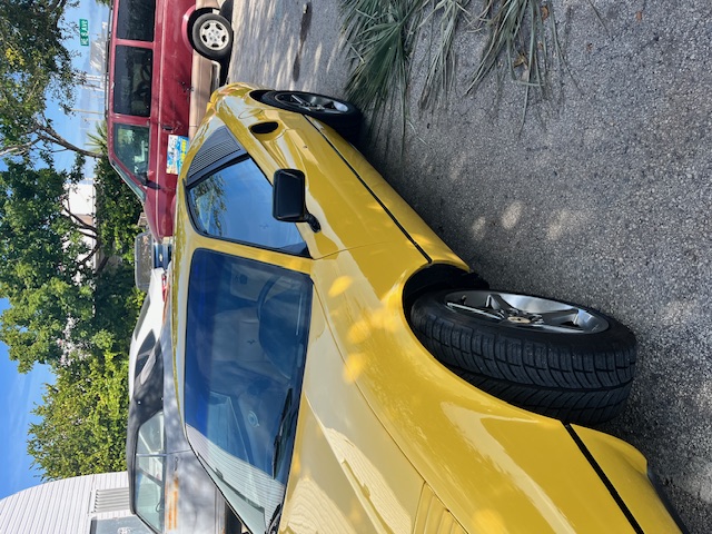

I have a 1988 Original MERA. Was running great until I got stuck, (first time in over 20+ years), and needed a tow. Turned out to be a bad distributor coil. After fighting to reassemble the old distributor I installed a new aftermarket complete distributor with new coil and ignition module. Jumped the OBD port and timed it @10 degrees. Starts and idles perfectly but runs poorly. Hesitates and stalls when stopped. New Cap Rotor Wires and plugs. There is an exhaust leak on the lower pipe from the head. This is in process of being replaced this weekend. I also just completed a full install of a PISA dash with aftermarket gauges. (Not VDO). I think I read somewhere the engine service light has to be incandescent and not LED? Is this true? Can the LED service light cause problems? Also I am eating the distributor cap contact on the inside top. I have tried to knock down the rotor as low as possible. After a few weeks I am noticing the contact inside on the top of the cap is worn down and shavings are inside the cap. I have a new cap on now and decided to use the old rotor. Any thoughts on this too would be greatly appreciated.. Thank you all.

1. very pretty car
